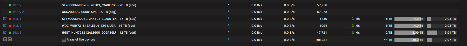

  14. The parity check completed. Parity Check Tuning Manual Non-Correcting Parity-Check finished (1375 errors) Elapsed Time 1 day, 8 hr, 56 min, 9 sec, Runtime 1 day, 8 hr, 56 min, 9 sec, Increments 1, Average Speed 168.7 MB/s I'll run a correcting parity check now and fix those errors. It seems the issue was probably caused by either a controller issue or some issue with AMD Ryzen and unRAID (there was some issues iirc with those).

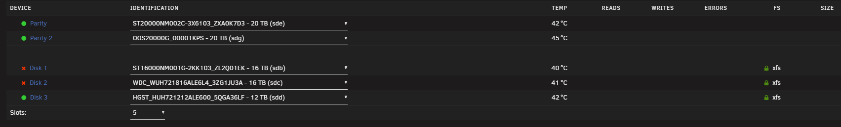

  20. I'm a bit of a noob with unraid still. Assuming both disks are OK and unraid parity check just went crazy (who knows if it was a controller mobo issue, or some docker container also trying to do something the same time and messed something up as I am running it on AMD), what would be the exact steps to do the new config and get this back up online?

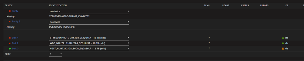

  21. zoidberg-diagnostics-20260128-1058.zipzoidberg-diagnostics-20260128-1050.zip Also, all this happened during a parity scan. I'm leaning more towards a failure of the controller or some motherboard issue.

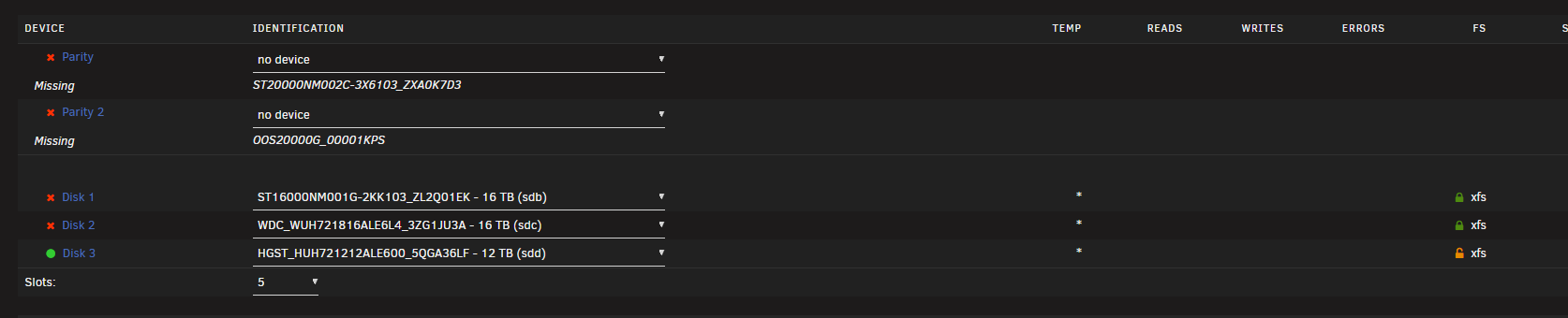

  22. Rebooting gives me this No idea what to do now or how to proceed. I don't believe 2 drives failed at the same time. Added the diagnostics zoidberg-diagnostics-20260128-0205.zip
