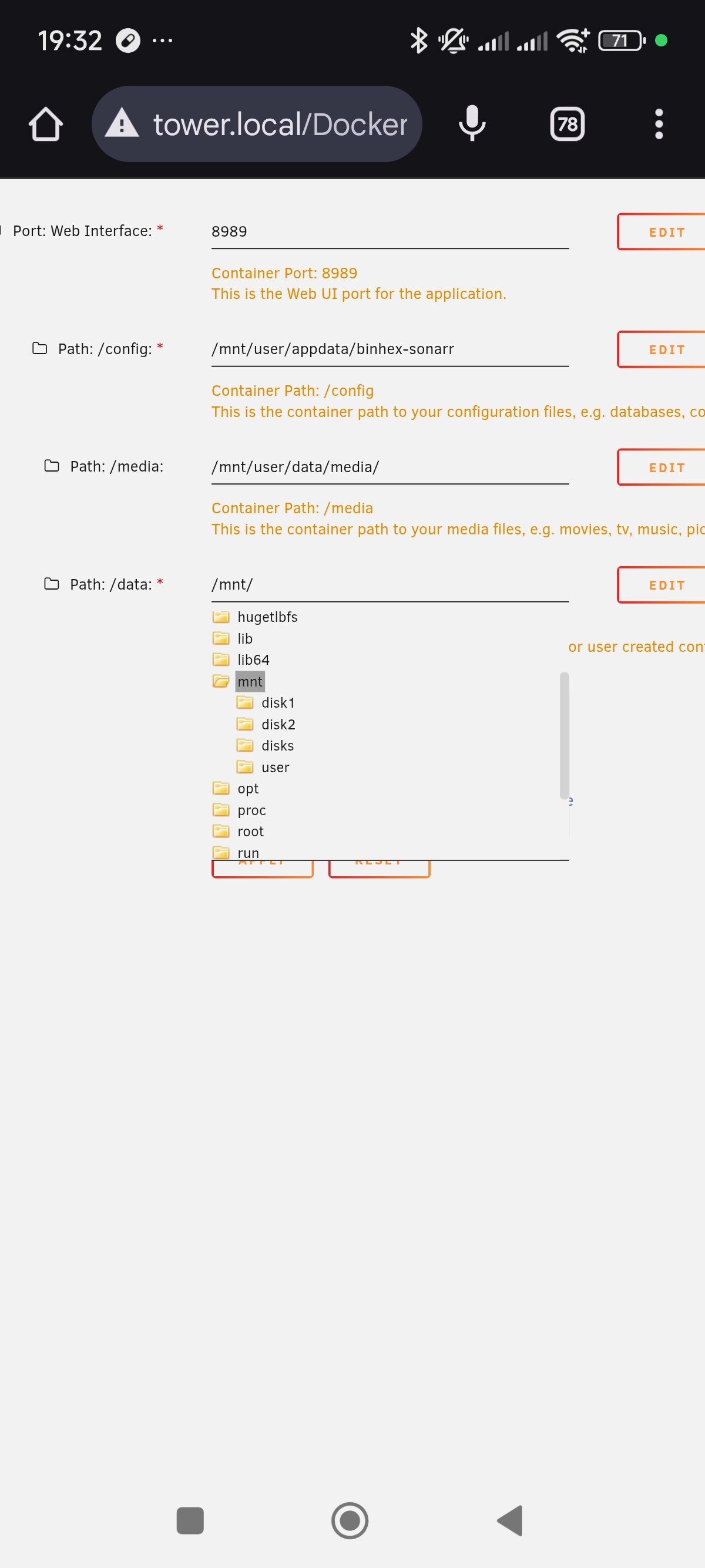

  5. Hi Guys, I have mounted a few SMB Shares served by my old QNAP NAS. The shares are visible in remotes, I can browse them without issue. Now I wanted to make those mount points available to a docker container. But I can't see the remotes "folder" in the path selection UI. What am I missing? Just used my sonarr docker for demonstation purposes. It is the same across all my containers, no matter if they are privileged or not. The remotes are not shown in my containers path selection UI.

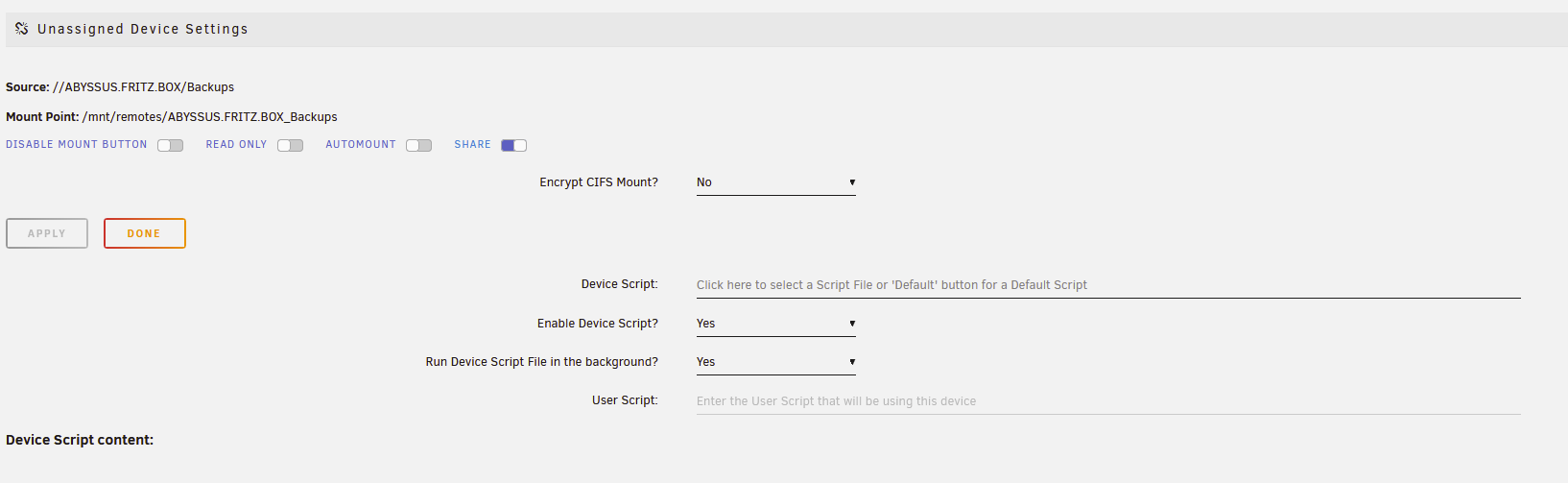

  6. Thank you for your reply. Your settings look a lot like mine, except for destructive mode. I will create a new post on the unassigned devices thread, thanks.
  7. I am running 7.0.0 2025-01-09.- Is there something in the smb share config I am missing?

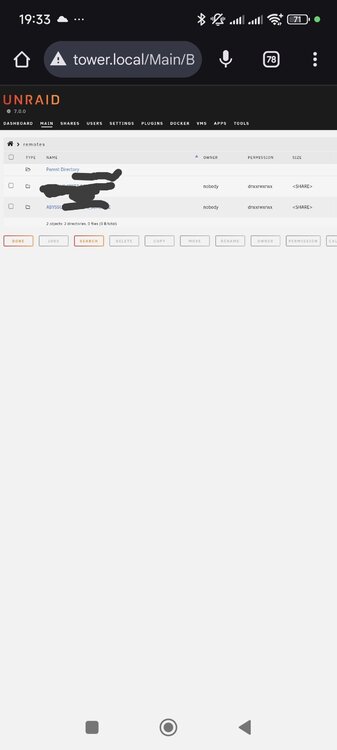

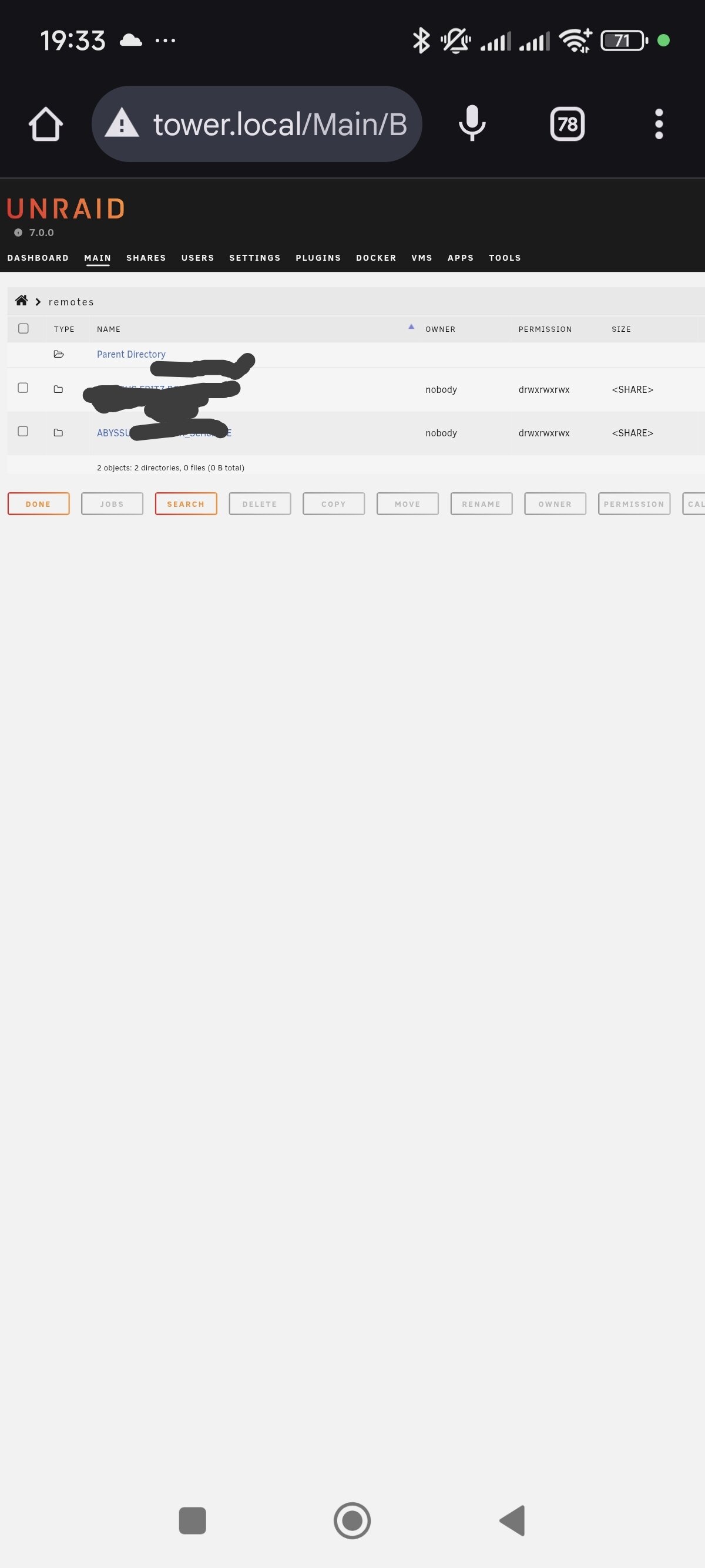

  8. Thank you for your answer and the screenshots. This just confirms my issue: remotes is not there. I have my two disks and user, nothing else. I was quite sure that it should be there, hence the post above. The folder is just not there. I just took the screenshot using my donate container but it is the same for every other...can't find remotes Going from the main ui I can see the mount points in remotes.
  9. Hi, I own a few NAS, one being my primary storage provider. I am transitioning to unraid. In order to still use my old storage I mounted those old shares via Unassigned Devices. The shares show up on the Main UI Dashboard, I can browse it via the remotes mount point. I would like to enable a docker container to access those mount points. But in docker I can't set the path, it won't display when using the graphical interface to selected the path. Even with a privileged container the remotes won't show. What am I missing here?
