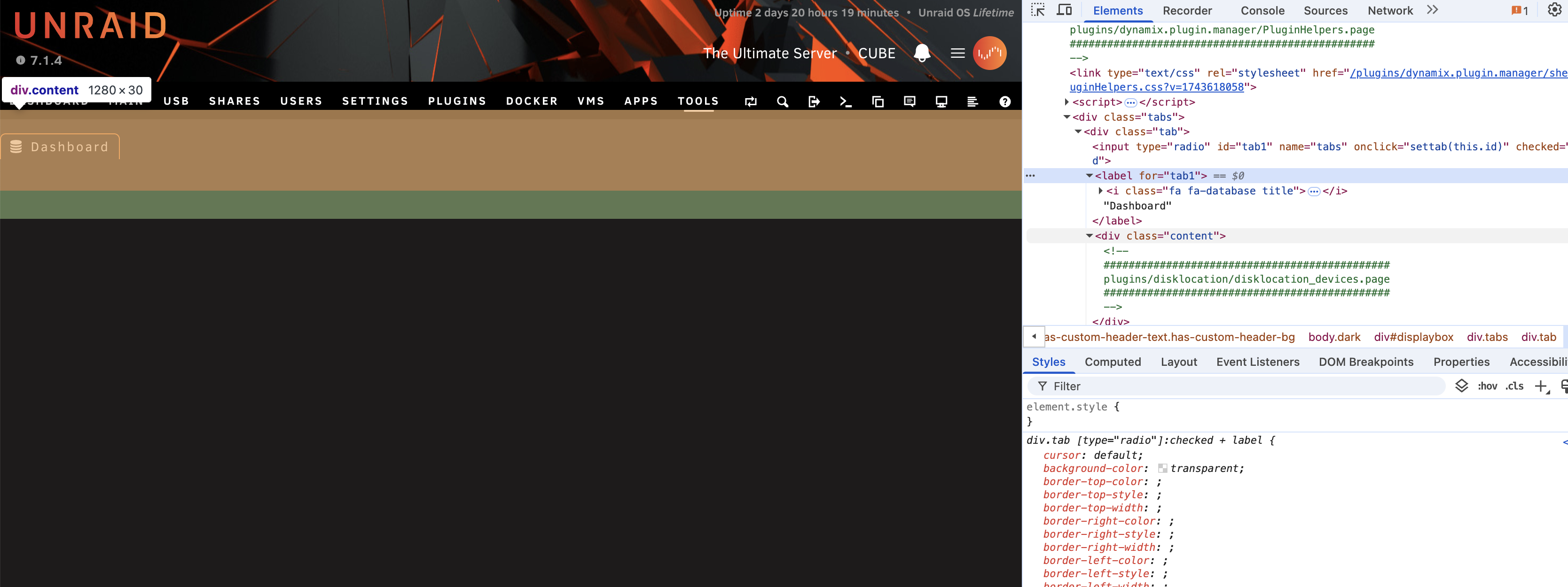

  2. Hey, @FlamongOle , it finally works. The only problem is I can't restore the configuration from my backups. No matter which backup I select - plugin is not initialized. I'll be starting from scratch, no big deal. Thank you for fixing the plugin!
  3. Hey @FlamongOle , Here are the error logs. Same error on both -> Dashboard and Disk Location settings pages: [19-Oct-2025 13:56:04 Europe/Warsaw] PHP Fatal error: Uncaught TypeError: array_key_exists(): Argument #2 ($array) must be of type array, null given in /usr/local/emhttp/plugins/disklocation/pages/variables.php:135 Stack trace: #0 /usr/local/emhttp/plugins/disklocation/pages/functions.php(23): require_once() #1 /usr/local/emhttp/plugins/disklocation/pages/system.php(23): require_once('/usr/local/emht...') #2 /usr/local/emhttp/plugins/dynamix/include/DefaultPageLayout.php(864) : eval()'d code(24): require_once('/usr/local/emht...') #3 /usr/local/emhttp/plugins/dynamix/include/DefaultPageLayout.php(864): eval() #4 /usr/local/emhttp/plugins/dynamix/template.php(94): require_once('/usr/local/emht...') #5 {main} thrown in /usr/local/emhttp/plugins/disklocation/pages/variables.php on line 135The above log comes from 2025.10.17 version
  4. Thank you for your answer. No, I'm not using the "tray override" feature. Even when updated to the latest version, the Dashboard page was empty. I removed the plugin and tried to reinstall it. Unfortunately, this doesn't help. Dashboard and plugin configuration pages don't work. If you want I can try to gather some logs for you, but please tell me how to do it. I navigated to Tools -> Disk Location, and it looks like I have absolutely no content rendered. See the screenshot from Chrome Dev Tools: Same on the Dashboard page -> Nothing is rendered besides the header. Removing the Disk Location plugin resolves the issue.

  6. Hey Folks! I'm afraid something went wrong with the last update :) After updating tge plugin to the latest version (2025.10.15), the Dashboard page is blank. Same is Tools -> Disk Location. Trying to Force SMART+DB From Tools -> Disk Location Recovery ends with HTTP 500.
