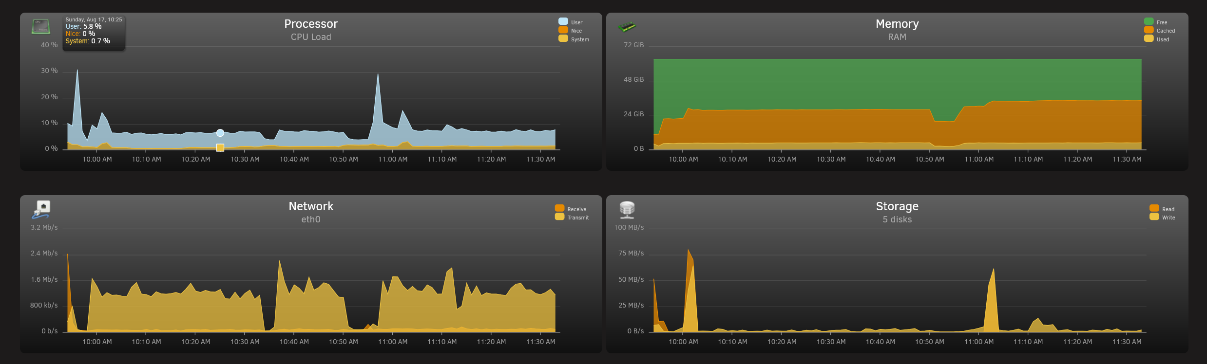

  9. Hi, Running a unRaid 7.1.4, I5-12400 with 64GB RAM, 3 HDD and 1 NVME (appdata). Having issues with system stutter/slowdown issues, I have a Minecraft server running in an AMP container and it has 12GB ram allocated and every couple of minutes the system will freeze and then speed backup, for example the dashboard of unRaid, the core usage will freeze in place then speed back up suddenly, the system stats will also freeze then speed back up to catch up the 5-10 seconds it has missed due to the freeze. The server has allocated 13GB RAM, and never hits the limit, or reachs above 30% CPU usage (a few spikes to 30% but typically hovers around 5-10%) This issue was happening a week or two ago, and I did a restart which seemed to have fixed it but it's back. One thing I have noticed is that when the issue does occurs, the network usage will plumet down, but the cpu usage doesn't really move much (system stats attached, within the 1:30 hours timeframe it stuttered around 20-25 times. I have a different minecraft server container and the issues repeat on that one as well. Any assistance greatly appreciated.
