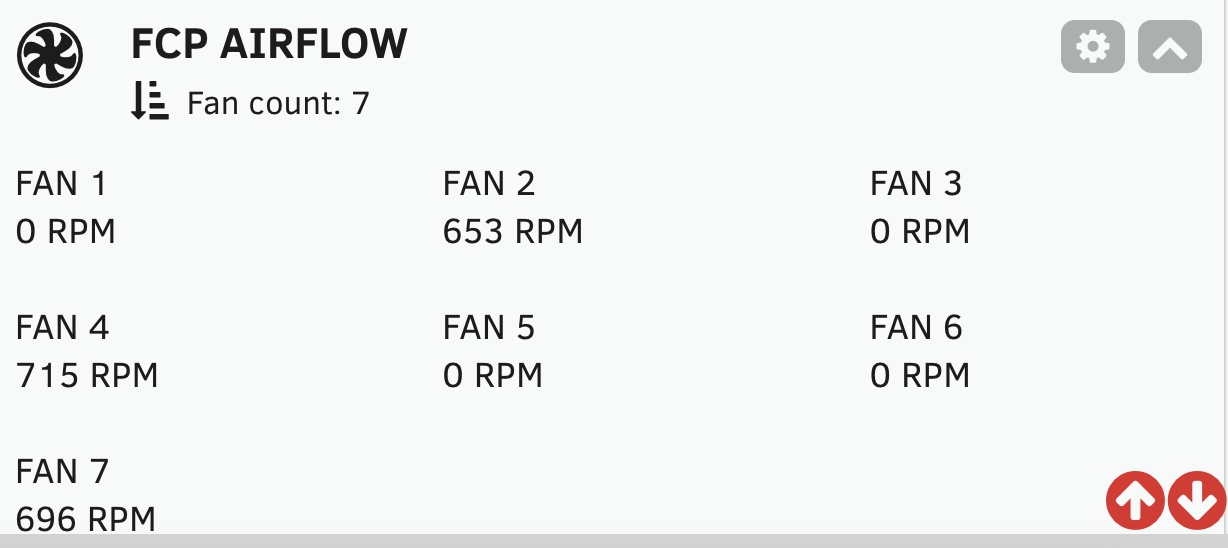

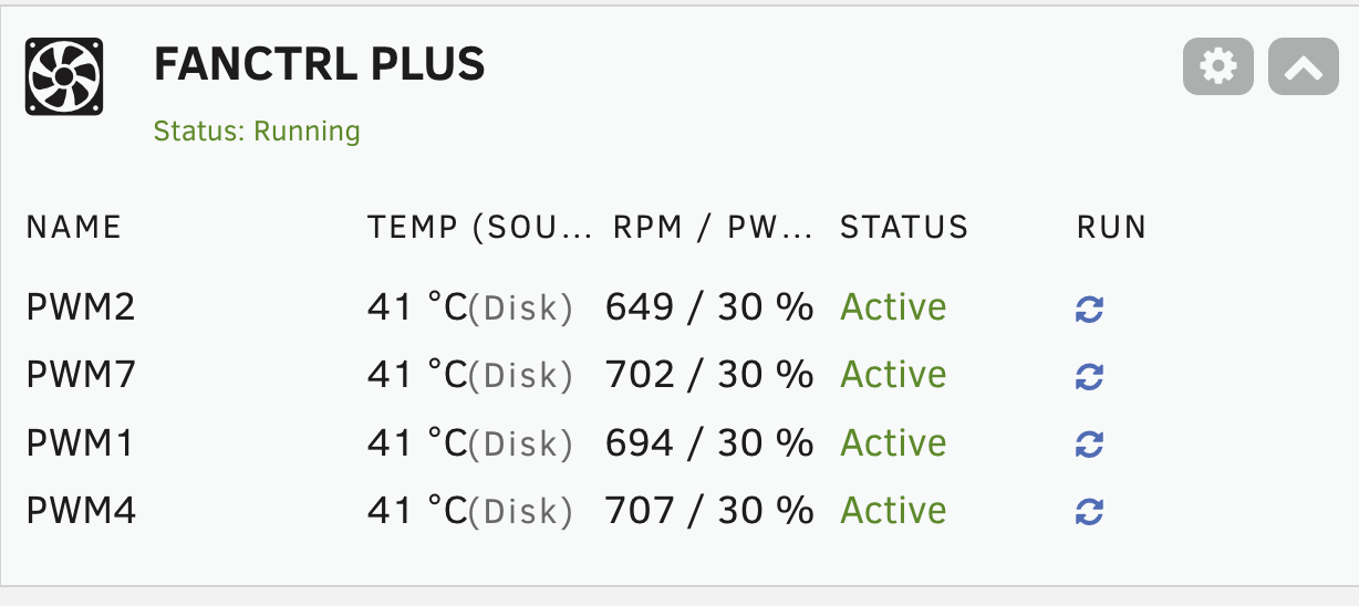

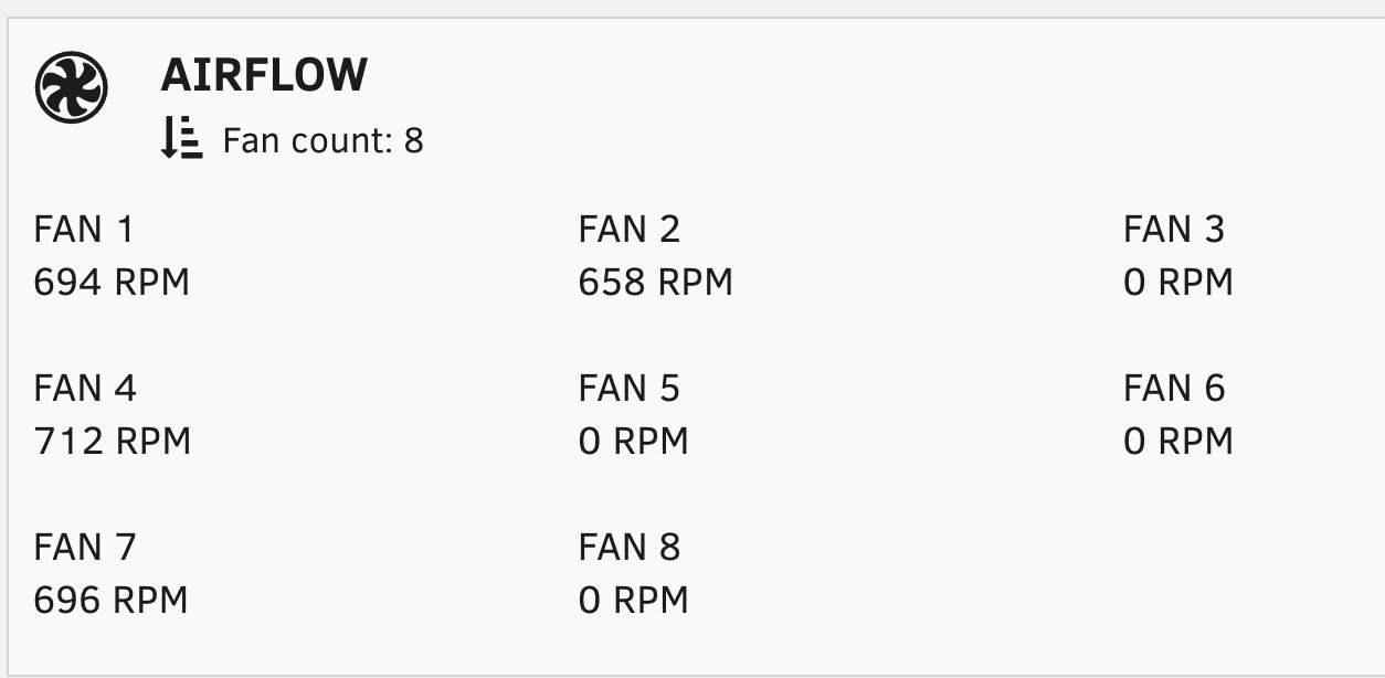

  8. I have it set up for PWM1,2,4 and 7. On reboot rather than grab nct6798 - pwm1, it grabs corsairpsu - pwm1 instead. If I change it and apply, it sticks until the next reboot. Am I doing something daft? [Edited: I see a discrepancy between the Airflow and FCP Airflow widgets as well, I wonder if related?]
