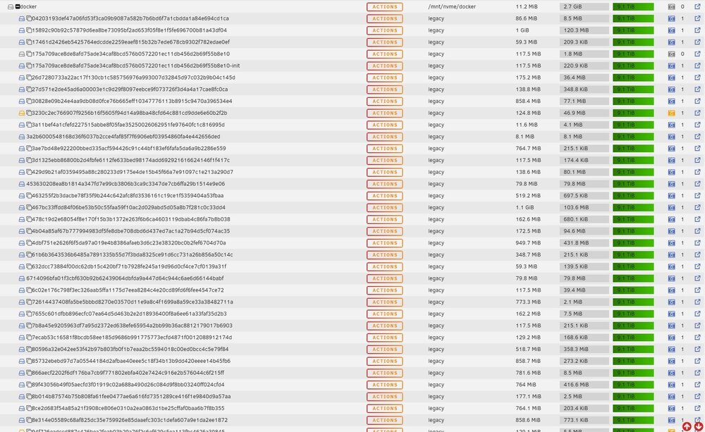

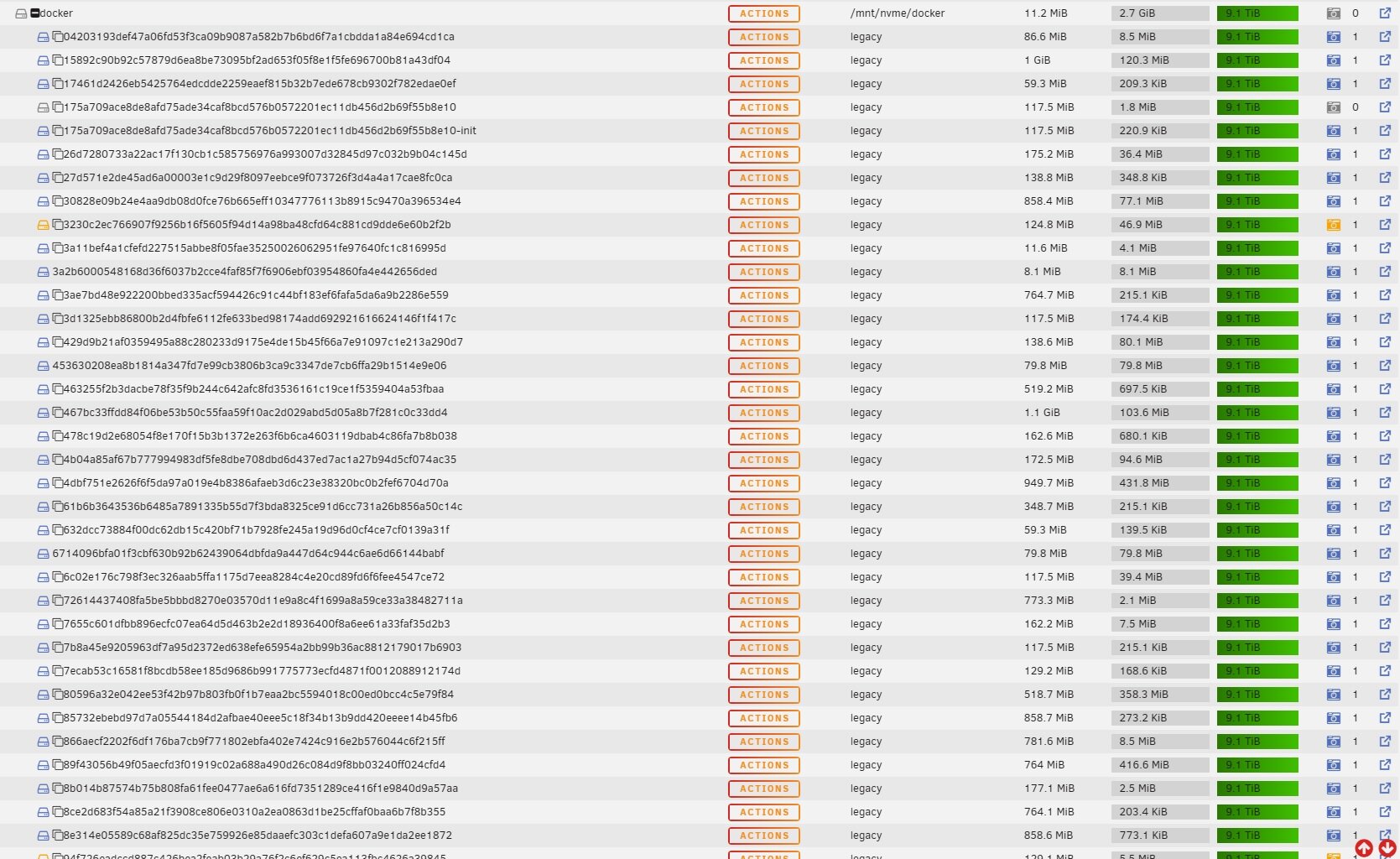

  9. Hi, while playing around with the system (like changing configs of containers back and forth) something I don't understand is increasing (see picture below). I have five containers running, but there is this huge number of images(?) under the docker dataset. Can anybody tell me what it is, what it is needed for and how I can remove it if reasonable? I run unraid 7.1.4 with a pool of four nvme drives, mounted at /mnt/nvme. The pool also contains other datasets for e.g. personal shares, VMs, etc. Thanks :-) Klayman
