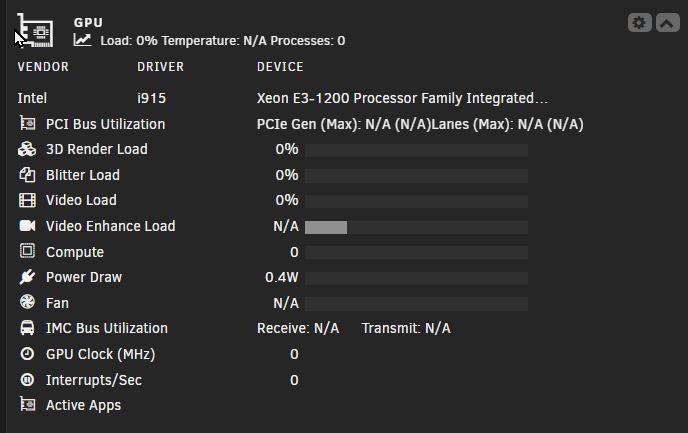

  2. Hello, just in case someone others tries to, it seems not to work with Sandy-Bridge. I tried to configure, like described by all the others, but it won't work for me. I think Sandy-Bridge is too old.
