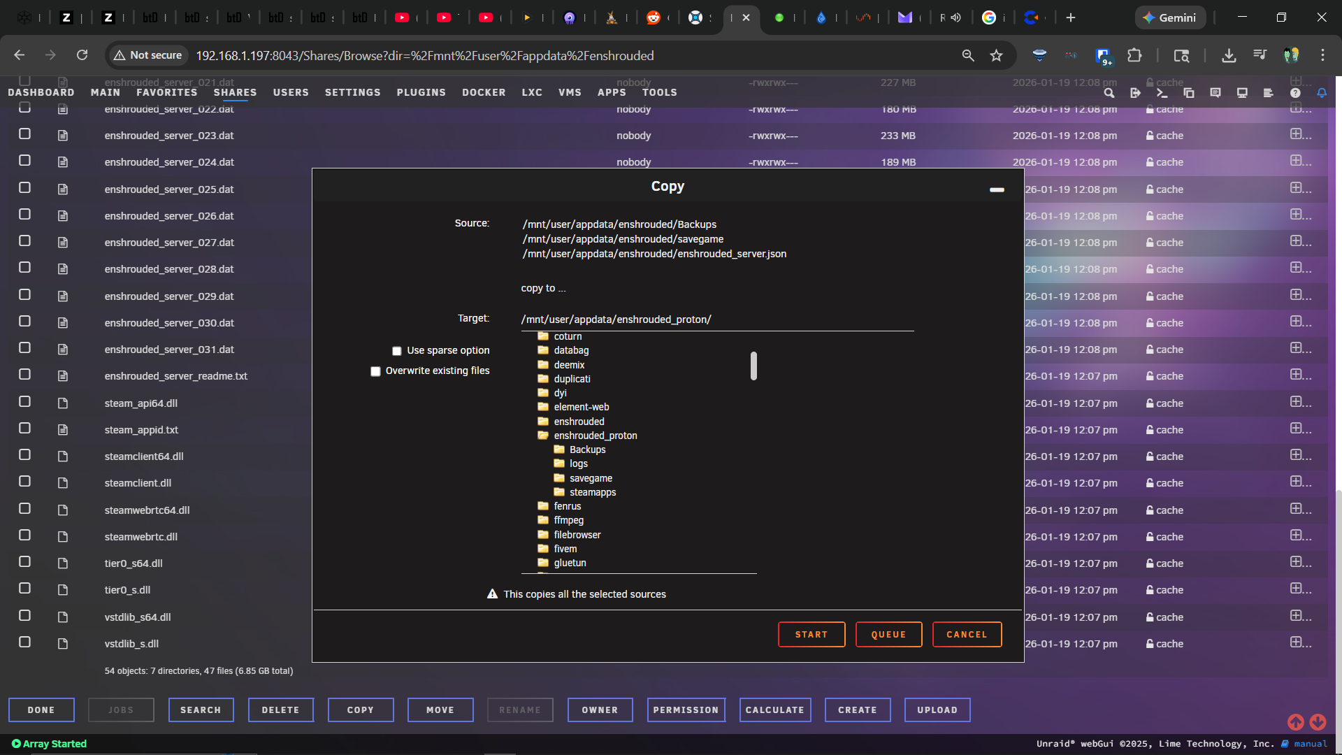

  7. seems you only need, Backups, savegame, enshrouded_server.json 1 delete Enshrouded docker keep appdata! 2 backup Enshrouded appdata different location 3 reinstall Enshrouded read logs let it fully start, 4 stop docker, move Backups, savegame, enshrouded_server.json from the old working appdata! 5 Enjoy! Docker still needs fixed
  8. FIX! 1 delete Enshrouded_Proton NOT apdata!! keep that back it up! 2 stop docker 3 copy appcache, Backups, config, logs, savegame and enshrouded_server.json FROM the older docker appdata to the new docker appdata! keep your old backup!
  9. update, installing a new fresh docker runs fine, deleting all files from that docker and moving my files from my other docker, server miss match so yes this docker update problem! so there is 2 options! one just start fresh and new, or wait till its fixed i guess! i am not restarting!
  10. not to be rude but installing a new one works, so it has to be something with your docker, it won't update must install a new docker and that means i lose everything
  11. ive deleted it and tired Enshrouded_Proton and Enshrouded tired perms chmod 777 and now ill start a new docker ill report back
