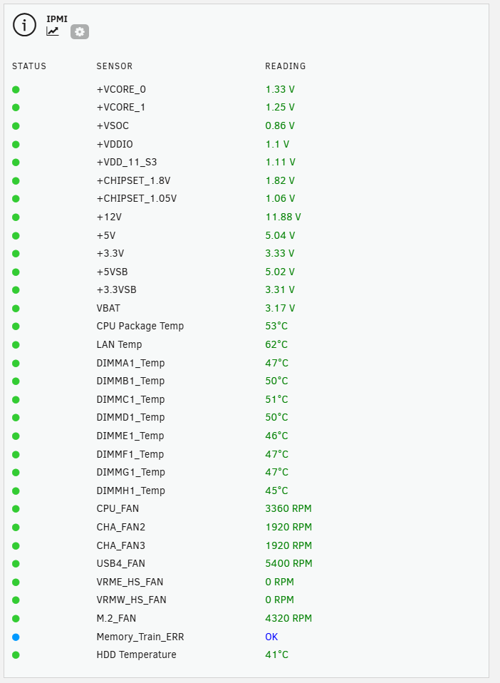

  1. Running the new 11/7 version of IPMI Widget with the widget data empty on the Dashboard, I clicked on the Show/Hide content a couple times on the System Widget and suddenly the IPMI widget data showed up. Strange. Looks like your fix to the Plugin worked, SimonFair! I'm also using your GPU Statistics and USB Manager plugins and I love them! I also noticed FlamonOle's Disclocation plugin who posted previously and installed it. Works like a charm.
  2. Its an onboard IPMI. Even with Enable Network Connections turned off: 1. The IPMI section of the dashboard is EMPTY, even though the config page is set to display all sensors. 2. Readings are shown on the Readings Tab and also in the footer. They just don't show up on the Dashboard. 3. Rebooting the server doesn't help fix the blank IPMI display on the dashboard. Thanks for your quick turn-around on a new version today!
