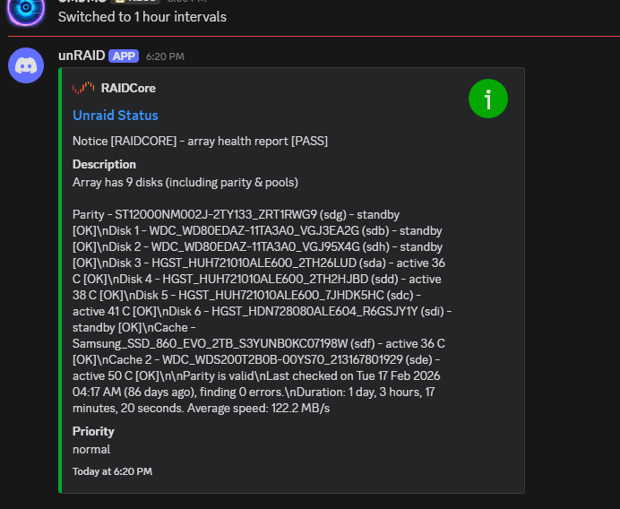

  1. That did it, thank you!
  2. Unfortunately, mine is still putting out bad formatting:

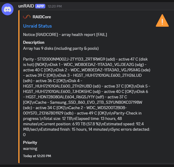

  4. After updating to 7.2.3, the issue persists.
  5. The other day I went to change how often unRAID sent status reports to my Discord server from every hour to every 6 hours, and after that it started sending them with broken formatting: Even if I change it back to 1 hour, it continues to send them with newlines written out instead of being parsed as formatting. Other notifications (like the test message, temp warnings, update notifications) seem to be parsing fine. I've tried rebooting, using a different webhook in a different channel, tried digging into the Discord.sh notification script to see if anything looked off but I think the issue is either with the data going into the script or something on Discord's end (although a friend of mine also running unRAID with Discord notifications says his are showing up fine. I haven't tested any of the other agents because I don't have any of those services set up already. raidcore-diagnostics-20251203-1926.zip

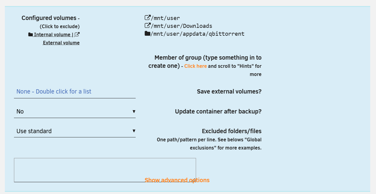

  9. So after struggling for a few days to figure out why the plugin kept erroring out on a couple of my containers (specifically binhex-krusader and qBittorrent) I finally discovered the root cause. They both have mappings to /mnt/user, for obvious reasons. Having /mnt/user as an exclusion will cause the plugin to ignore everything in /mnt/user, which includes the container's appdata folder, even though the appdata folder is explicitly chosen to be backed up. For anyone else who comes across this issue, the proper way to handle a container with a /mnt/user mapping is to not set an exclusion for those but instead set "Save External Volumes" to No. Also on version 7.2.0, I'm assuming due to the new responsive WebUI backend, the option boxes for the plugin are a bit discombobulated, so make sure you're setting the correct option (the middle one) to No.
