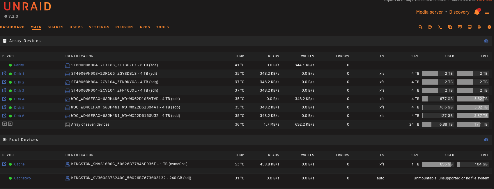

Hey everyone, I just need to ask for guidance on troubleshooting steps, not really looking for deep dive in logs etc for now. My Unraid is setup with a 2 x 4tb IronWolf CMR drives and a combination of 6 SMR and CMR 4tb drives for the Data drives. I have noticed that after the weekly parity checks, the Parity Errors are fairly large. The first check from a couple of weeks ago I had over 70,000 errors and this week it's over 56,000. Now I did a quick smart check on all the drives and they are all coming back clean. I am now doing a Extended Self Check and the first Parity drive came back with no errors and I am testing the 2nd one now. So I checked around and I have a few things I was told to check by AI: Check the SMART on all drives (all came back "no errors" check the cables for each drive to be sure they are well connected check the ram If none of the above is an issue, then SMR slowness may be the problem. So I know a couple of things, my SATA cables are new, I purchased them a month ago because I thought I could have had SATA 1 or 2 cables. Swapped them all for new SATA3. The ram is not ECC but they are 64gb (4x16gb) of the same make and model kit. I may have 2 or 3 shucked drives from external HDDs that I put in, they would be Seagate Barracuda drives. No smart errors. If I were to take your advice and look at logs or other secret locations, where should I start looking. Once I have a path I'm sure I can start sleuthing and looking for clues and solutions. Thanks all! Jacques.

Ok, testing complete, bulletpoints: DO NOT use SMR drives as a parity drive. Things go well until a few Gigabytes get written then the constant read/write/check will kill the speed if copying directly to the array. This can be from 140MB/s then down to 2MB/s in my case. Switching to CMR has fixed that issue, the writes are consistent once the disks speeds from copying on the array saturate and slow the array down. I am surprised that this is not in BIG, BOLD, RED letters anywhere. Your array will be only as fast as your slowest disk when accessed. So in my case, I have 2 parity CMR drives, 1 CMR in the Array and 5 SMR drives. When initially copying to the CMR, speed stays consistent around 120MB/s. When the disk hit the half-way full mark, it moved to the next SMR drive. After 20 minutes, the speed slowed down to around 20 - 40MB/s . Significant drop. Mine is a budget build using hardware I had on hand. I will replace the SMR drives with CMR slowly over time. SMR drives are perfectly fine if you are using it as long term storage and do not need to do constant writes to them. Read times are fine, write actions are not. Definitely use a NVMe drive or other fast sata drives to cache your copies, set your mover to run every night if you are not moving this over all the time. Use the system idle time to do things like trimming, moving or parity checks. If you are not there, you won't care.

Popped in a 4tb WD ST40000VN006, CMR for the Parity. It is running at 120MB/s for the Parity rebuild. I guess I will let you know tomorrow if things are much better.

I will pick up a couple of IronWolf 4tb drives today and replace the 8tb Parity with a 4TB, no worries, the largest disk is 4TB. They are on sale now for CAD $120 which is about $85 USD. Even Grok is telling me that SMR could be my weakness but it told me to get a 8TB SSD instead (money much?). I only have 1 CMR in the whole setup at the moment. I'll let you know how it goes.

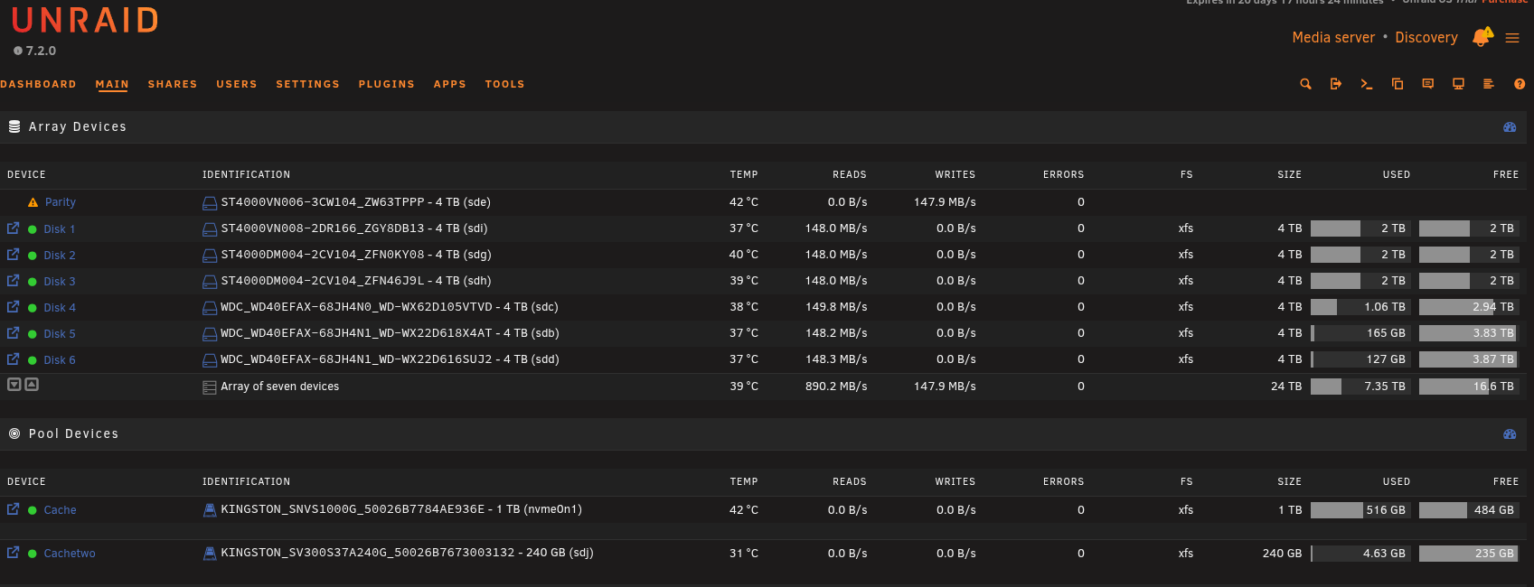

Hi again, I'm trying to figure out if this is normal or not. I upgraded the CACHE from a 512gb to a 1TB nvme drive. After changing the share to go to Cache and then Array, moving files to the NVME is great, I'm getting 140MB/s and then slows to about 113MB/s over time. Now, when the NVME is full, I stop the transfer and manually start the Mover in the Scheduler. The speed varies, 130kb/s, then 0, then goes to max 9MB/s then 0, back to 130ish... over and over. So, question to anyone out there, where do you think the bottleneck is? I would suspect that the array would happily take the files and move them at a consistent speed, especially from the NVME. The files range from 200MB to 1.3GB in size. Again, I tried many.... many steps including disabling the Parity check (which I don't think works), changing the disk to Reconstruct Write and things I forget. Is this data copy slowness normal?? Thanks, Jacques.

I removed the cache drives last night and just let it go. This morning I started transferring 4TB of data over and it has been steady at 88ish MB/s . I did the same this afternoon with another 2TB. Same consistent speed. I don't know. Maybe it was fixing parity while I was moving the files from cache to drive? So many questions still remain. I was about to blame the X99 mobo and maybe some cheap electronics. At least it's consistent, just not super fast as I expected over a 2.5gbit line. It's averaging 680ish mebits/s . So today I will: Move my 8TB drive data over (maybe it will take more than a day) Add a 3TB spinner and a 2TB SSD drive to use as a Pool and not array (VMs and such) Add some more power to the Sata line. Order a CPU fan from Amazon to get the 2nd CPU connected.

Hey all, As per the title, I'm sure many of you have seen this issue and it's really getting to me. At the moment, I setup an array of 6 - 4tb HDDs, mix of Seagate Barracudas and WD reds. The Seagates twirl at 5400 rpm and the WDs around 5900. (ST4000VN008 and DN004, WD40EFAX-68JH4N0 and N1s) I have a 8TB Barracuda parity drive. I run a Xeon e5-2698 with 64GB Ram, a 512GB nvme, 2.5Gb networking card. So, I'm trying to empty the nvme cash which had 320GB of data on it. I'm using Unbalanced and set the NVME to write to all disks. lt started off great with sustained writes at 170MB/s or so and would be done in an hour or 2. That was almost 7 hours ago. The speed slowed down to 35MB after about 1 hour then steadily kept slowing to currently 10MB/s and sometimes dips to 1 or 2 MB/s So currently it shows 20GB left and 32 minutes to go. Well, it's been going up and down so who knows how much time is left. I'm just wondering why it would take so long to go from an NVME attached to the mobo to move over to the HDs. I purchased 6 new SATA 3 cables thinking that some cables may be old and defective but that didn't change anything. There are no Sector Errors on any disk. The drives are set to never spin down. (however i'm contemplating covering pin 3 on the drives) I set the Tunable MD write to Reconstruct Write I even disabled Parity for now. My CPUs stay around 1% or 2% usage and will sometimes go to 100% on one or 2 cores but will last about 10 seconds. I rebooted the Unraid server which helps but seems to reset the copy from Unbalanced so I have to start over. But this happens when copying files from SMB or NFS shares. Starts at 98MB/s then slows and will stay at 30MB/s then, after an hour or so, will drop to 10 and below. This is really frustrating and I still have about 12TB of data to move over. I have seen many posts about this issue and various answers that seem to help me on the short term. I though the nvme was the answer as it let me copy to over 130MB/s but then totally slow when the NVME got to 90% full. Then it looked like it bypassed the NVME and went straight to the array. The nvme would never dump it's content to the array. That's why I'm using to Unbalanced to empty it then I will remove the NVME as a cache and let it sit until I get a better result. My shares are (well, were set) set to use the Cache then copy to the Array. I am not sure if the array is limited to the speed of the Parity disk or not. All drives individually seem to work properly. What am I missing. Thanks all for any help. Jacques
