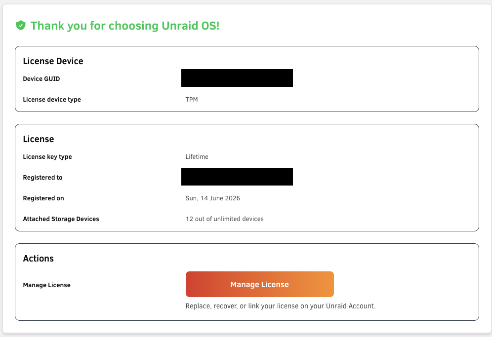

  1. Move to TMP completed successfully after reboot!

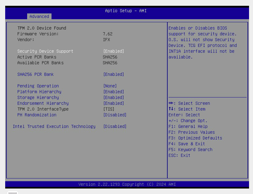

  2. This was it! Went into the BIOS, Trusted Platform Section, Pending Operation and set to "TPM Clear". Save and Reset. Server Booted and TPM now shows up properly on Registration page with a TPM GUID.
  3. That fixed it! I am now able to login and register my server successfully. Thank you!

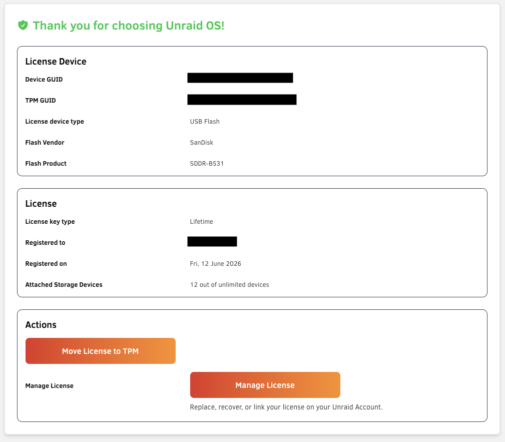

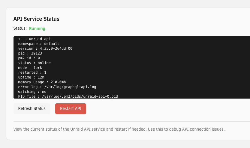

  4. Currently running the latest version of Connect plugin. Verizon - 2026.06.01.1911 root@Unraid:~# unraid-api stop [PM2] [unraid-api](0) ✓ root@Unraid:~# unraid-api restart Restarting the Unraid API... [PM2][WARN] Applications unraid-api not running, starting... [PM2][WARN] App unraid-api has option 'wait_ready' set, waiting for app to be ready... [PM2] App [unraid-api] launched (1 instances) +--- unraid-api namespace : default version : 4.35.0+264ddf00 pid : 456894 pm2 id : 0 status : online mode : fork restarted : 0 uptime : 1s memory usage : 240.6mb error log : /var/log/graphql-api.log watching : no PID file : /var/log/.pm2/pids/unraid-api-0.pid root@Unraid:~# unraid-diagnostics-20260613-0806.zip

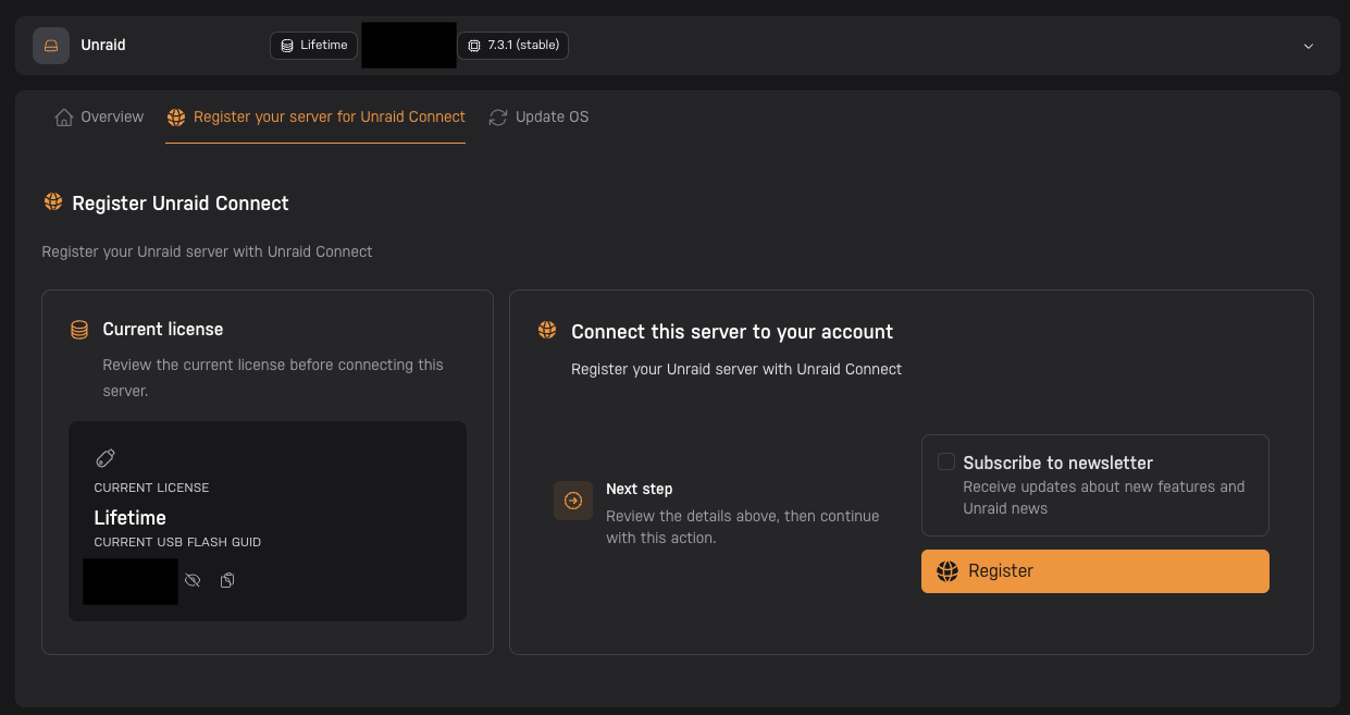

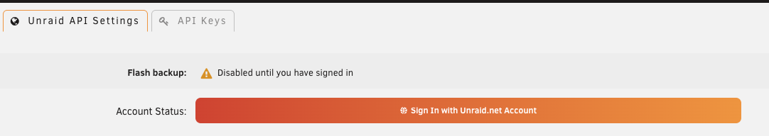

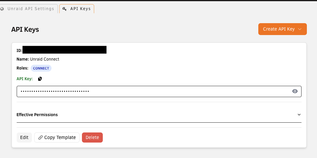

  5. Hi, I recently upgraded to 7.3.1 with internal boot and wanted to move from USB license to TPM. I installed a physical TMP 2.0 module in a Supermicro X13SAE board and enabled it in the BIOS. Unraid is able to see the TPM device via the command line but unable to see it via the "Registration" page. Not sure if this is tied into another issue I am having with Unraid Connect and potential dependency (created topic for this issue in Connect Plugin support section https://forums.unraid.net/topic/199414-unable-to-sign-into-unraid-connect-731/). Here is the output from the command line (redacted some information as I don't know what is sensitive and what is not: root@Unraid:~# dmesg | grep -i tpm [ 0.000000] efi: ACPI= [ 0.019596] ACPI: TPM2 (v04 SUPERM SMCI--MB) [ 0.019637] ACPI: Reserving TPM2 table memory at [mem] [ 15.843486] tpm_tis MSFT0101:00: 2.0 TPM (device-id , rev-id) root@Unraid:~# cat /sys/class/tpm/tpm0/tpm_version_major 2 root@Unraid:~#

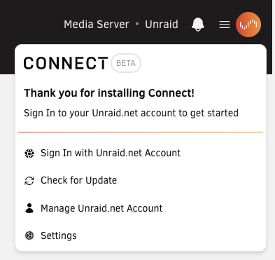

  6. Afternoon, I just upgraded to 7.3.1 and installed the Unraid Connect Plugin. When attempting to sign in and register my server it just puts me in a loop and never completes the sign in process. I click the drop down on the top right, then Sign In with Unraid Connect, Log into my account, Click Register Server, and it brings me back to my server GUI login and then I log back into my server and check the drop down and server is still not logged into Unraid.net .. I have performed this loop 20+ times over different browsers, incognito etc.. I have rebooted multiple times, uninstalled and reinstalled plugin multiple times, removed / renamed my.server plugin folder for Unraid Connect multiple times, confirmed certificate, created an API Key for Connect since there was nothing there just in case.. I am at a loss.

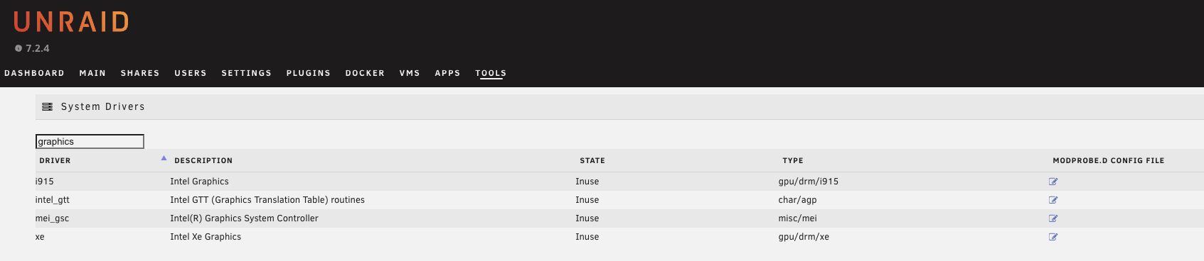

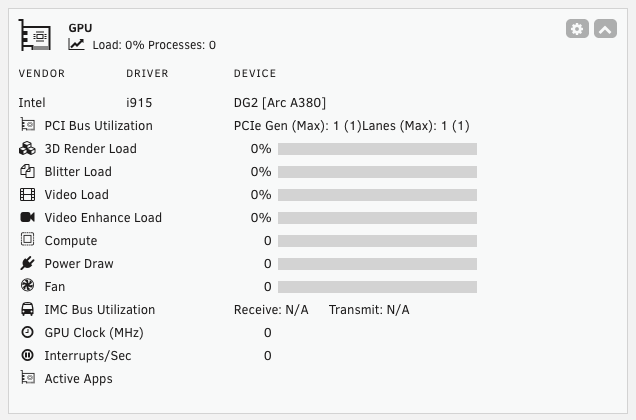

  7. Sounds good, I found this post and was able to force the XE driver but that broke transcoding in Plex. Reverted back to the i915 driver and transcoding was fixed. I will wait until 7.3 full stable release.
