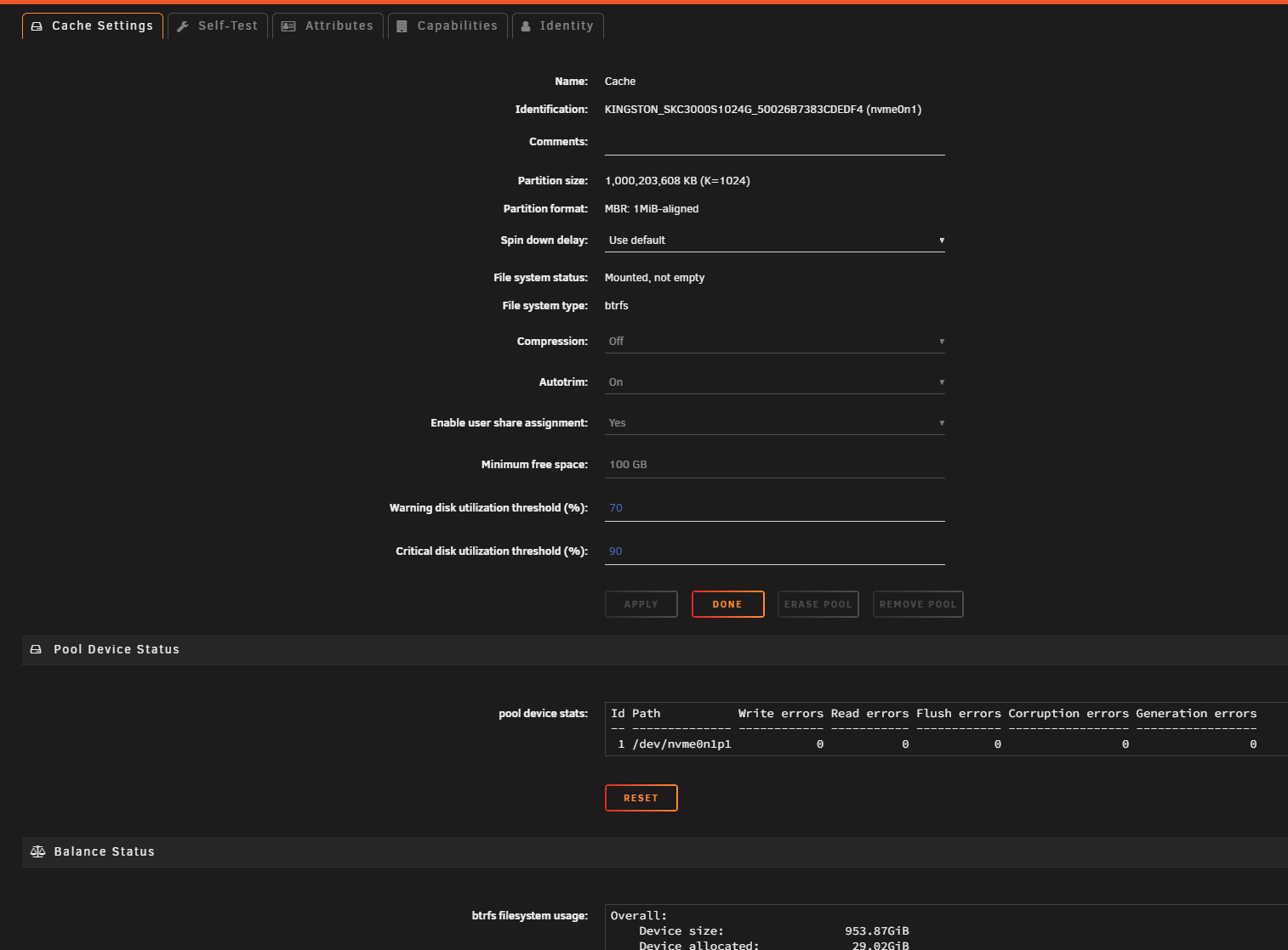

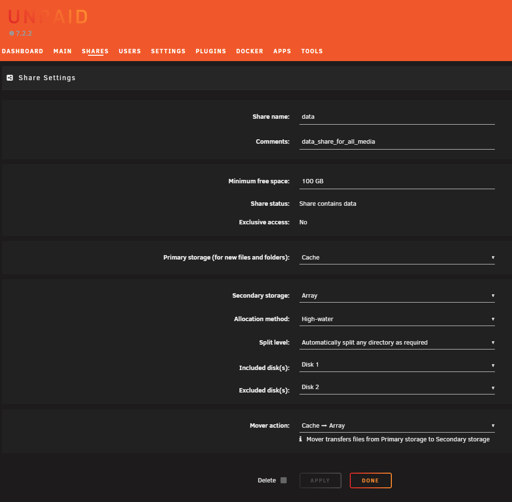

Thanks for pointing this out, i indeed had not set a minimum space for the cache, i did now but unfortunately it makes no difference w.r.t. the error i get.

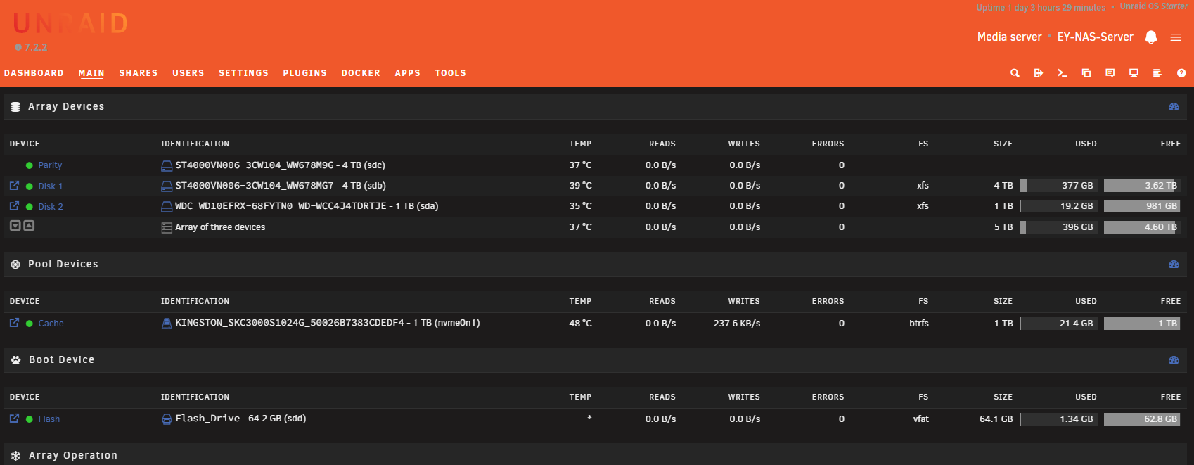

Yes i can create new files. Please find the diagnostics attached. ey-nas-server-diagnostics-20251208-2016.zip i also just noticed that it has also issues with certain other files that i try to copy. If i select skip, the copying continues but then now and then runs into a file throwing following error:

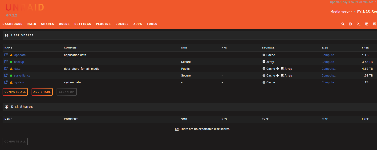

Hi i am new to unraid and require support with solving following error when i am copying my music from my synology to unraid server over smb: There is sufficient free space on the pool and array devices: The share is using the cache (a 1TB NVME drive) as primary storage and the 4TB HDD disk in the array as secondary storage: anyone knows what the problem might be? I was able to copy all my photos without any issues (though it was very slow with an average transfer speed of about 5MB/s).
