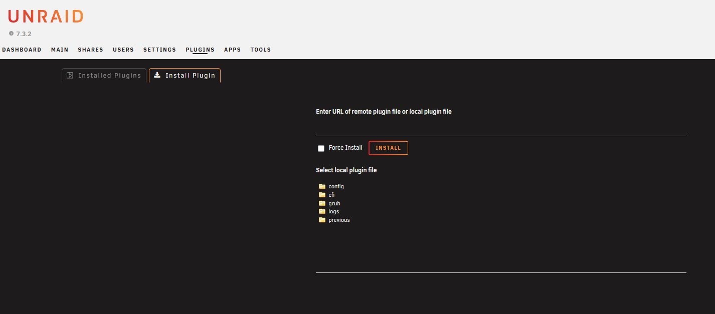

Things are chugging along with unRAID and I have settled into an effortless daily routine. One thing I would like to know what shares are being accessed and by who? Does anyone have a favorite plug-in that would allow this?

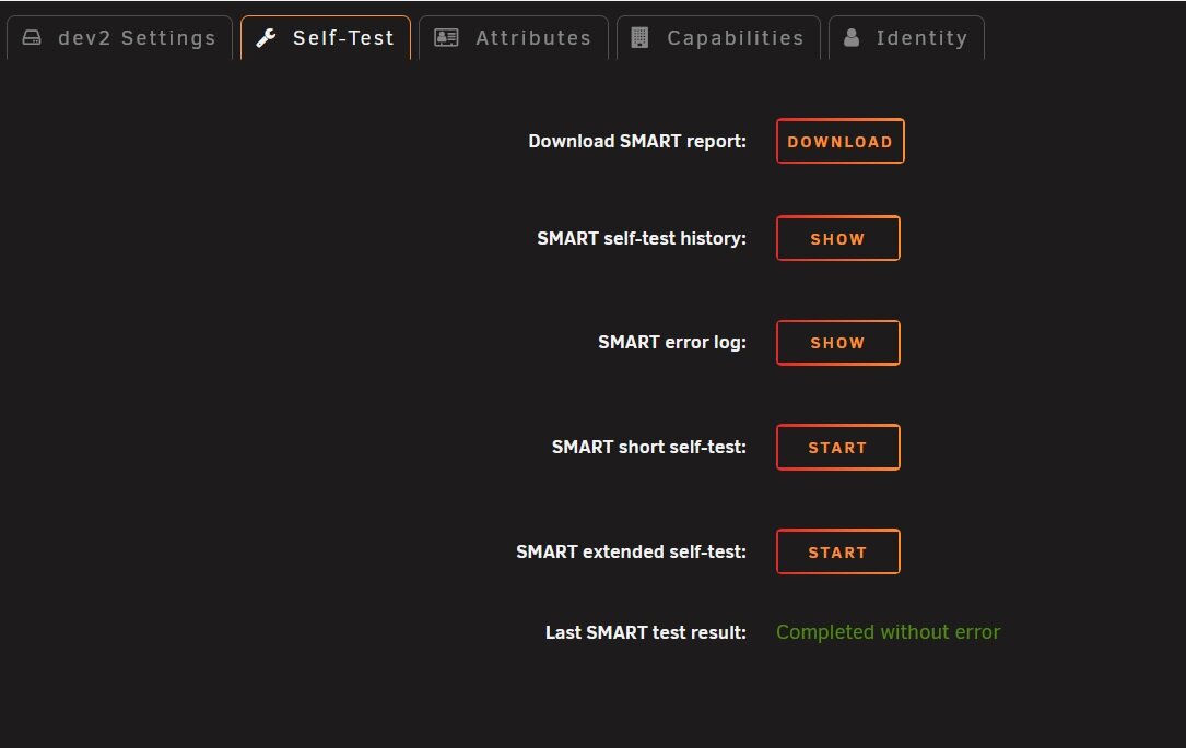

Something that is curious about this report are the following lines, mainly the last line: SMART Extended Self-test Log Version: 1 (1 sectors) Num Test_Description Status Remaining LifeTime(hours) LBA_of_first_error # 1 Extended offline Completed without error 00% 47072 - # 2 Extended offline Completed: read failure 90% 46967 26411574888 # 3 Short offline Completed: read failure 90% 46951 26411574888 2 of 2 failed self-tests are outdated by newer successful extended offline self-test # 1
Need help getting best transfer speed as I dump several drives of data to my new unRAID server
OK, extended SMART test completed in 24 hours with no errors on the 14TB drive in question. Can anyone look at this report and tell me what I should be concerned about and what I am looking at? backupserver-smart-20260406-1815.zip

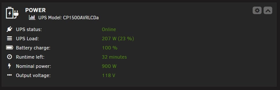

@Veah I decided NOT to spin my drives down because of stress, wear and tear on them. I would rather pay the extra $10 a month in electrics than have to buy a $600 hard drive. My BACKUP server has the most drives because some are 26, 22, 18, 14 and 12TB drives so there are 13 array drives soaking up watts, an SSD drive and currently a questionable 14TB drive I am testing, so that's what? 15 drives? Main Server has 10 big spinners and 3 Samsung 9100 Pro NVMe drives soaking up 170watts.

I forgot to ask, is this SMART extended self-test going to take another 2 to 3 days? SMART Extended test started a few minutes ago.

@Veah I'm not sure ditching a perfectly good socket 1200 i7-11700k CPU and motherboard for an N100 surface mounted CPU/MB combo is going to work for me. Anything replacing it needs to support a PCIx 8 lane LSI 9305 HBA SAS card and a PCIx 4 lane dual ported 10gig NIC card. It could be possible to replace said 125w 11700k with a lesser CPU such as a 35w Pentium G6505T CPU, although the 11700k is drawing very little power at the 1 - 5% LOADS it sits at all the time. I say all this because I went down a power saving adventure with my Socket 2011-3 Xeon CPUs, replacing a 125w Xeon 14 core with something like a 45w Xeon 10 core and it only made less than a 20w difference in power draw. I also have a new Pentium Gold G-6400 CPU new in box, which claims 58w max draw. https://www.cpu-monkey.com/en/cpu_socket-lga_1200 A core i5 11500T would be another 35w drop in replacement. A used replacement 11500T seems to sell for $80 on ePrey. A used Pentium G6505T for under $40. I have a TON of used motherboards, CPUs and hardware on hand. I own and have operated a computer services business for 20 years and have been in I.T. for over 40 years. The main server power draw with ten 26TB drives and an Ultra 5 245k cpu is about 170w. The BACKUP server power draw with 13 misc hard drives and the i7 11700k cpu swings between 216s and 243w with pre-clear running. EDIT: There is also the possibility of both underclocking and undervolting the 11700k processor for power savings. I'm 98% done with step 5 (Post Read) of pre-clear, so I will have some answers soon.
