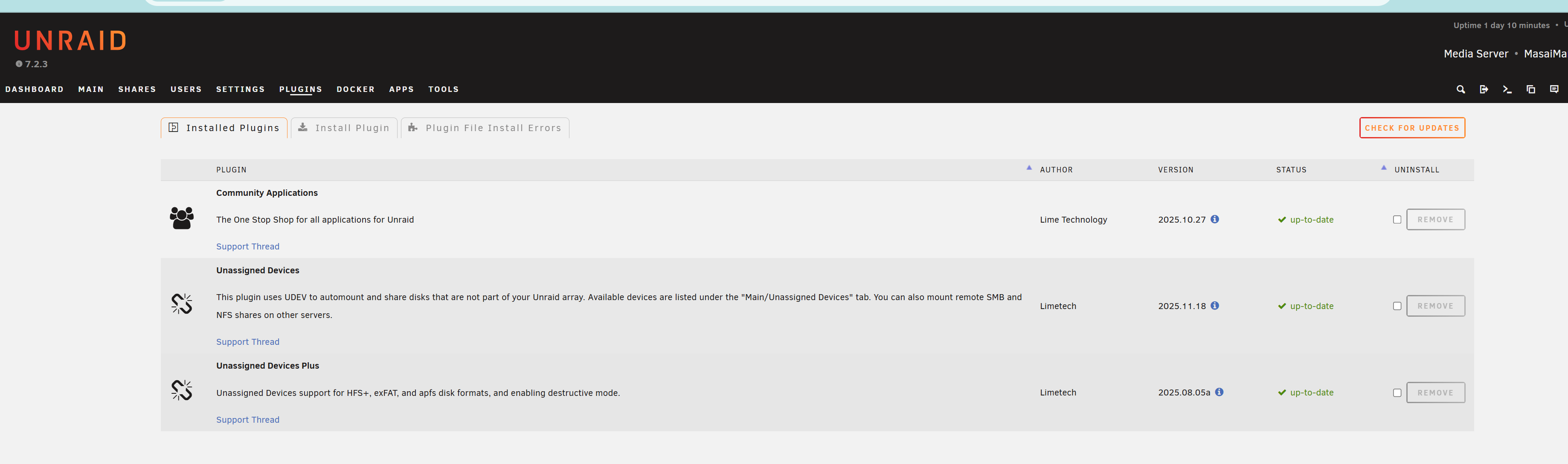

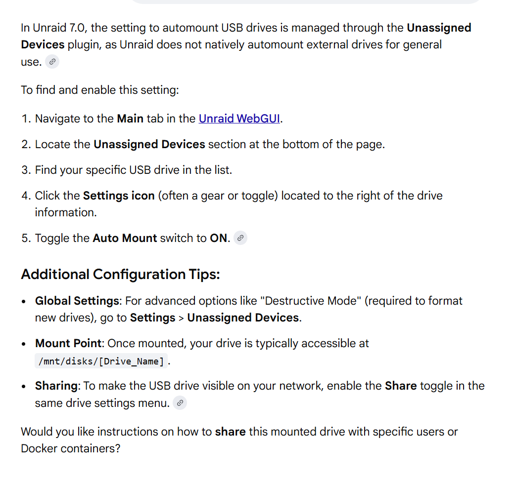

  1. The setting information screen shot is from Gemini. The error screen shot is from UnRaid. The error was corrected by: " trurl, thanks for the input, however as i said above after the safe reboot I reboot into normal mode. As you can see the plugins are present:" Which is the Plug-Ins screen shot.
  2. I'm not sure I followed the comments above properly. I do understand that allowing connection of usb drives to a raid amounts to a significant hole in the raids security. However, in my case it is a short term workaround to my data migration requirement. Once the new raid initial migration is complete I will go back and remove the ability to mount unassigned disks. For the moment I seem to have made significant progress by enabling these settings:
  3. trurl, thanks for the input, however as i said above after the safe reboot I reboot into normal mode. As you can see the plugins are present:

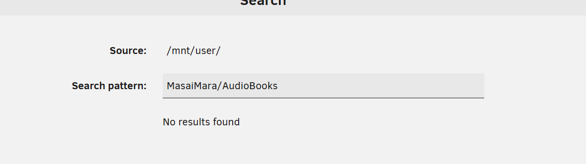

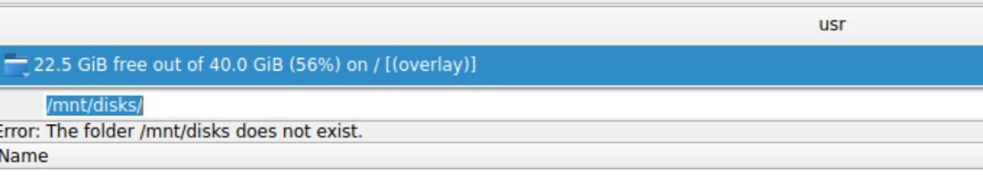

  4. I have tried the above steps many times over the last few weeks and made small progress but have not solved the problem completely. By rebooting server into safe mode I was able to remove the bad remote mounts. Unfortunately Unraid seems to keep a record of old mounts and keeps trying to remount them in spite of this. After refusing the remount of the old mounts I was able to reboot the server into normal mode, I then had to ensure the OS was restarted and the disks remounted. ATT Krusader is reloaded and shows paths to my installed shares. Unfortunately it is still unable to find the path to the local unassigned nvme drive, inspite of the fact that the OS shows the unassigned nvme drive.

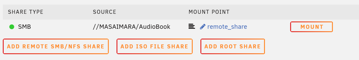

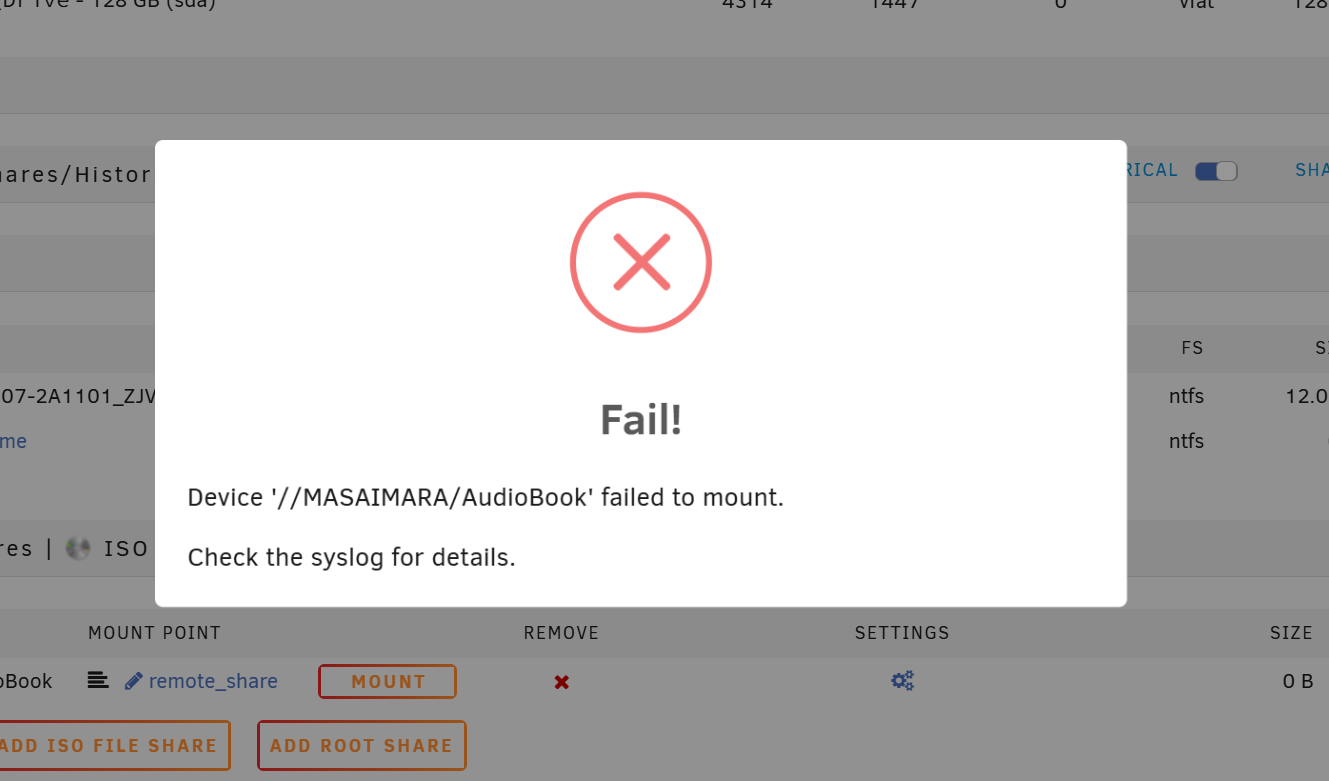

  5. The biggest issue as mentioned above it the mount was misconfigured: //MASAIMARA/AudioBook -> remote_share. I have removed that and it seems to be working. There are other issues with the Synology remote shares and the UnRaid file browser which I am working to untangle. Thanks for assist.

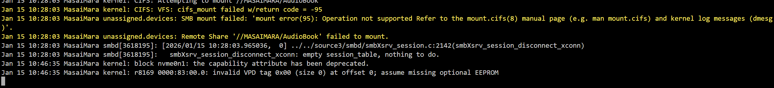

  6. Fank1940 thanks for the reply as you can see this is why i'm pretty sure I have the mount wrong. This is what the syslog says: Any idea what "optional EEPROM" would be missing from? ie where and how to fix? thanks danl1950
  7. trul, thanks for the reply: yes I have tried it multiple times with the result, multilayer failure I suspect because I'm fairly sure I don't have the mount set up correctly.
