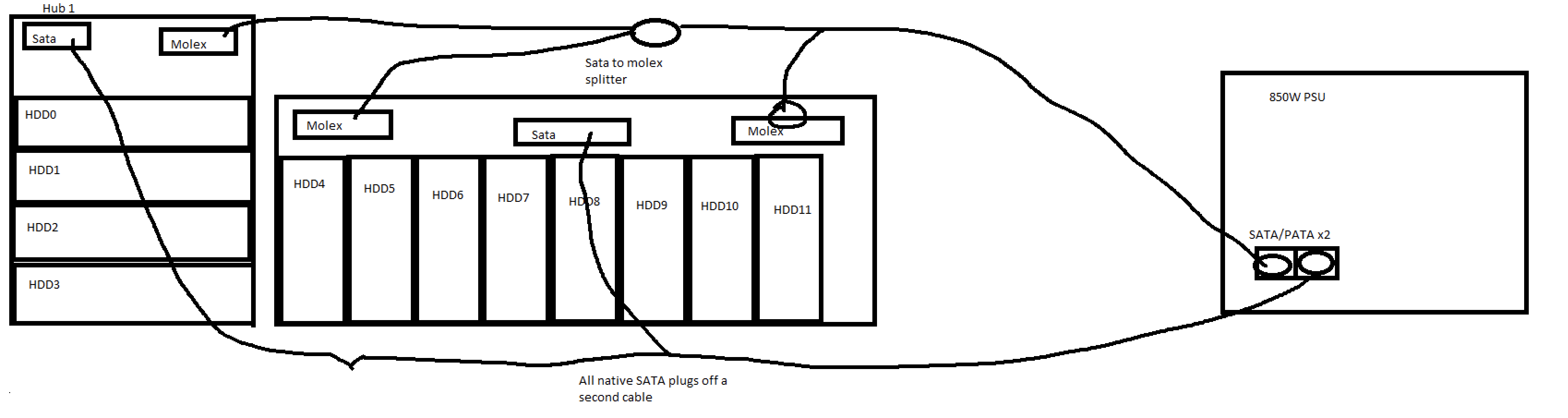

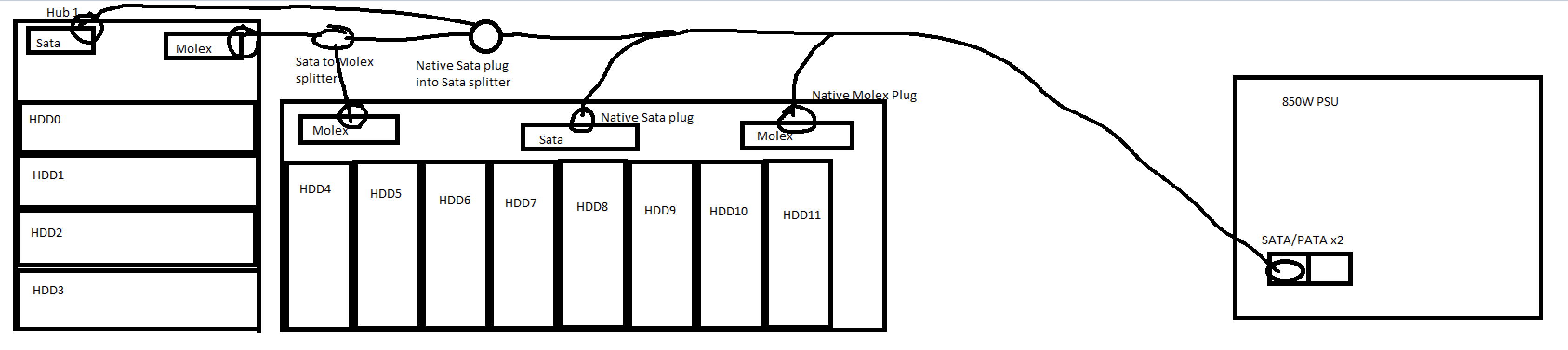

s Okay I don't want to get ahead of myself, but so far nothing has failed and this is a record time for that. I have rearranged the cabling as per the 2 diagrams above. With the top one being the original set up. Talking to my friend, we think maybe the delayed failures was due to it being a fresh PSU and running fine, but from that original set up it probably has stressed the 5v rail to barely be able to handle it under load. Hope this is the actual fix, I will let the parity sync finish, and update on how it is looking after that 18 hours is up.

Its a 850W PSU so shouldn't have any issues. I just replaced some more cables to change the SATA and MOLEX cables to be off a separate rail on the PSU instead of being all off the same one. The real question is, if these are the cause, how come the NAS ran fine for 4 months, and then decided to have issues
