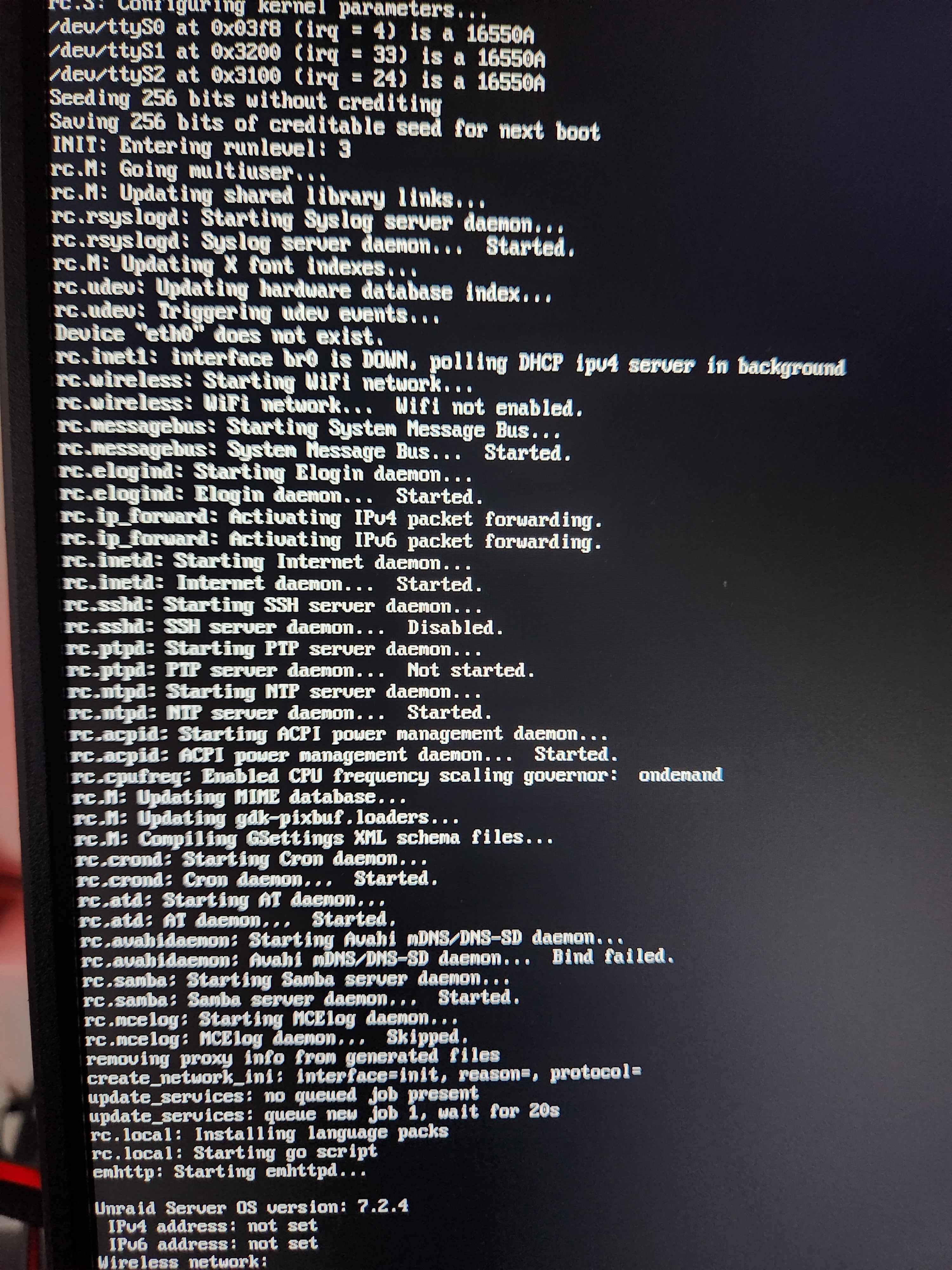

  1. What would be another method of connecting storage besides USB and a lot is there anything that's going to fix the issue that I'm having now or do I have to start over
  2. So what would be the suggested solution and steps
  3. and is there any way that i can make a back up that saves all my configs and doesnt wipe everything on my drives
  4. ill need to make a backup drive but also all of those hardrive are plugged in they appear in the "main" tab and sometimes they do disapear an says "no device" and idk why it randomly started doing that
  5. no i didnt make one , what would be the proper steps
  6. The issue started when I was trying to figure out why things that were downloading weren't getting since their proper files so I Mass copied and pasted a lot of shows from one folder to another not thinking that it would be too straining on the System since it was a simple folder switch but in inevitably ran my CPUs up and froze my computer I looked for Solutions on the unraid Reddit forum and it told me to try to safely power it down and and boot it back up and I did so but now I was having driver compatibility issues and 30 minutes after the driver compatibility issues trying to fix it in maintenance mode it says my boots Drive is either offline or corrupted mntower-diagnostics-20260408-2210.zip
  7. also wiping my cashe drive too because no matter how many times i restart it keeps my olld appdata and system files
  8. thank you this actually helped
  9. I started downloading plug-ins and the two plugins that I believe that could be causing my issue would be the Nvidia driver's plug-in and the rtl8125b PCI driver's plugin, soon after installing those two I tried to install Dockers and I was having trouble installing them due to a file layer issue I believe but I tried looking up a remedy and it told me to delete the docker directory then reboot the system, soon after I did that the system rebooted but I wasn't able to get into the web GUI and I lost all connection to the ipv4 and it gave me this error on my terminal when I ported into the main device does anybody have any suggestions or advice and what did just be easier for me to completely start over and transfer my key, please help what should I do mind you there's nothing on the server I'm starting fresh and very new to homelabing ALSO the original error for the docker download system was this that poped up [failed to register layer: symlink ../79881b9210e4d5e16fc6fbe044d4ab8488e1e6dfd10a21ac687164d5dddc1dec/diff /var/lib/docker/overlay2/l/XWCMZQRDN46AWTO4I4NM2MLISC: invalid argument]
