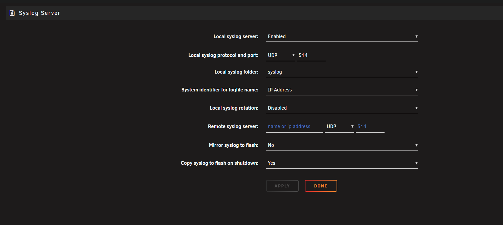

Over the past couple of days I enabled the syslog server and got the server to crash multiple times. But, there are no files in the syslog folder. I tried different setting for the syslog server and still nothing. With my inexperience I do not know the correct or best way to setup a syslog server. I used the directions linked by Veah, but it doesn't really detail all of the possible settings - if they are even applicable. Unless you have something else I should try I think this is what I am going to do: I am going to install the trial version of Unraid on another flash drive and see if it will be stable that way. Since I only have the two services running and a handful of plugins it shouldn't take more than a couple of days. Should I pursue this course?

Can the flash be the problem when it works perfectly in the old hardware? I will set it up for local syslog since I have been able to reboot it with no problem.

Ok, I will see about enabling that and get back with you. Thanks!
