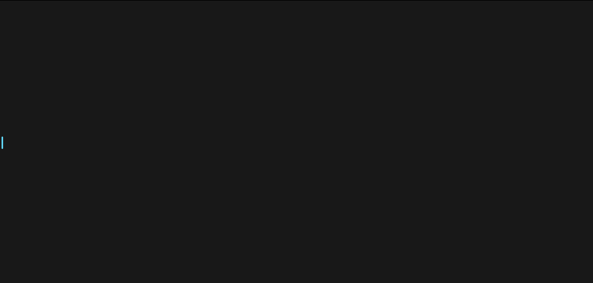

  5. Here is my new docker run command with added NVIDIA_VISIBLE_DEVICES and NVIDIA_DRIVER_CAPABILITIES: Command I added DRINODE and DRI_NODE as variables like stated in the github: Logs before i open the Webui: Logs After opening the WebUI: Logs But it´s staying gray:
  6. I don´t know how to export a chat in Discord. All i got is the link. Anyway i copied the whole conversation and put it in a text file (unformated). it´s not pretty but readable. Also the Container i want to run is: Orcaslicer Here is my docker run comand: /usr/local/emhttp/plugins/dynamix.docker.manager/scripts/docker create --name='orcaslicer' --net='capkin' --pids-limit 2048 -e TZ="Europe/Paris" -e HOST_OS="Unraid" -e HOST_HOSTNAME="Capkinserver" -e HOST_CONTAINERNAME="orcaslicer" -e 'PIXELFLUX_WAYLAND'='true' -e 'DRI_NODE'='/dev/dri/renderD128' -e 'DRINODE'='/dev/dri/renderD128' -e 'AUTO_GPU'='true' -e 'PUID'='99' -e 'PGID'='100' -e 'UMASK'='022' -l net.unraid.docker.managed=dockerman -l net.unraid.docker.webui='https://[IP]:[PORT:3001]' -l net.unraid.docker.icon='https://raw.githubusercontent.com/linuxserver/docker-templates/master/linuxserver.io/img/orcaslicer-logo.png' -p '3010:3000/tcp' -p '3011:3001/tcp' -v '/mnt/user/public/3D Druck/':'/3ddruckpublic':'rw' -v '/mnt/user/appdata/orcaslicer':'/config':'rw' --runtime=nvidia --gpus all --shm-size=1gb 'lscr.io/linuxserver/orcaslicer' Logs after spinning up the container: Orcaslicer logs After opening the Webgui (just gray background): Orcaslicer logs Discord Chat.txt
