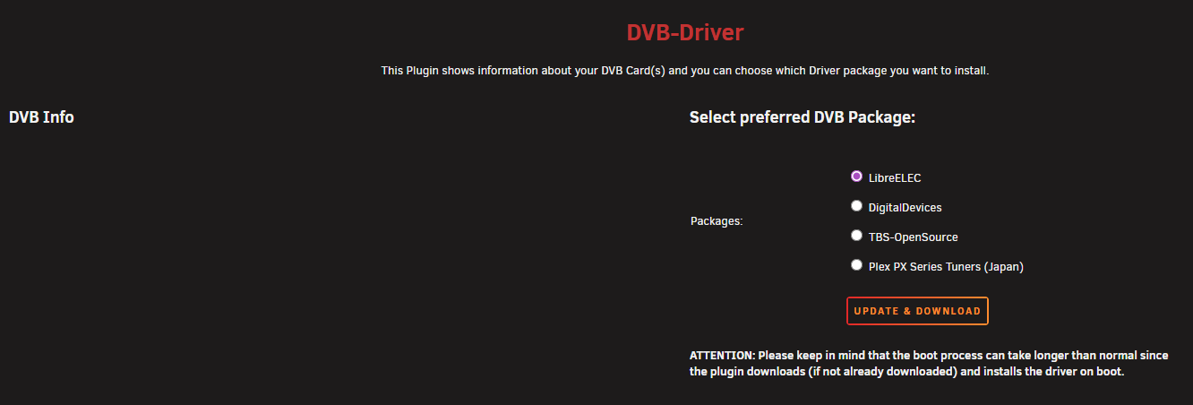

  7. MihaiS started following [Plugin] DVB-Driver
