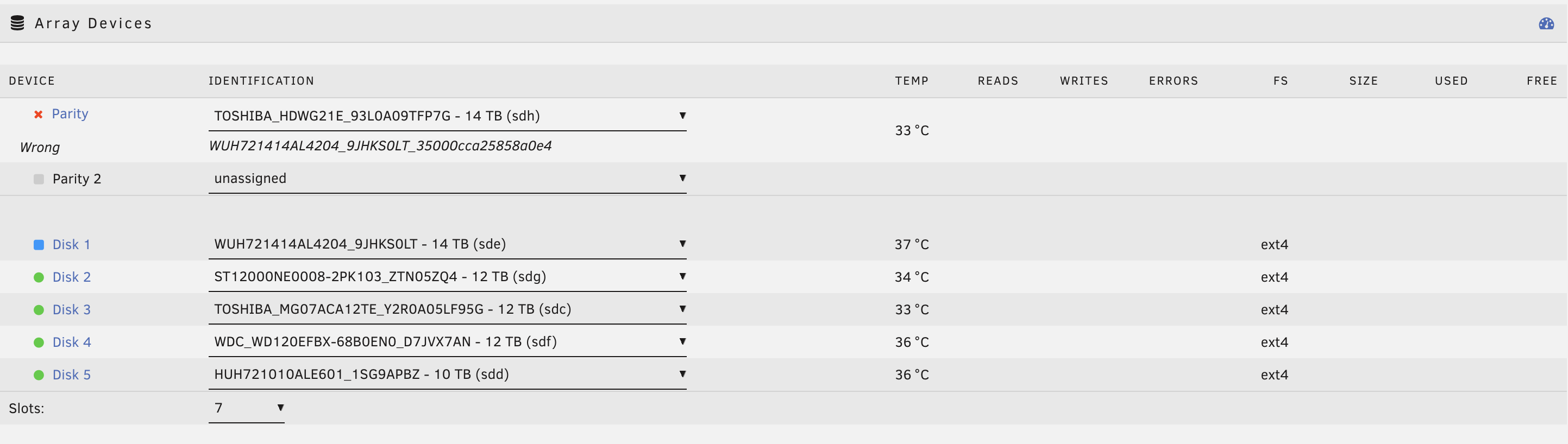

I set up the parity swap exactly as advised - Toshiba (the sector-64 disk) TFP7G to the Parity slot, old WD parity S0LT to Disk 1, all other disks unchanged. But no "Copy" button appears. The Parity row shows the Toshiba on top with the old WD serial underneath labelled "Wrong," and the array still says "Disk in parity slot is not biggest." So the swap isn't being recognised / the size check is still blocking. What am I missing - is the Toshiba's sector-64 partition also defeating the check in the parity slot? I started the array again with WD parity S0LT in Parity Slot 1 and Toshiba unassigned, then stopped array again and tried the steps as described (remove Unassign WD Parity drive, Set Toshiba to Parity Slot, Set WD to Disk 1) but there is again no copy showing. It just says 'Disk in parity slot is not the biggest' again. Appreciate any help
