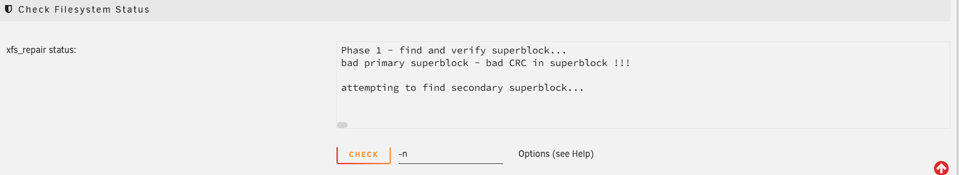

  3. ok well should I stop the check file system? I don't see a cancel button anymore so would I just stop the array and carry on with maybe cloning the parity if possible?
  4. ok well at the moment that I'm at the scan looks like its gonna take a longer time than I though, so what would you suggest would be the next course of action? Should I cut my losses and just take the loss on the drive and use my new drive to build a new parity or should I keep trying to save drive 2?
  5. So the scan is still running and all im seeing is Phase 1 - find and verify superblock... bad primary superblock - bad CRC in superblock !!! attempting to find secondary superblock...

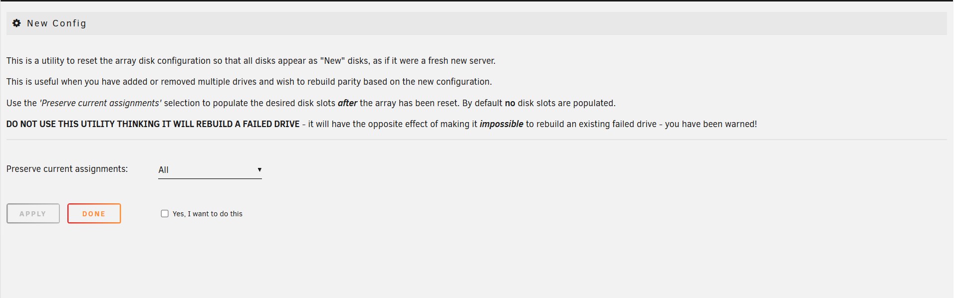

  11. ok just so I'm sure you mean preserve current assignments you want me to choose all and hit apply?
