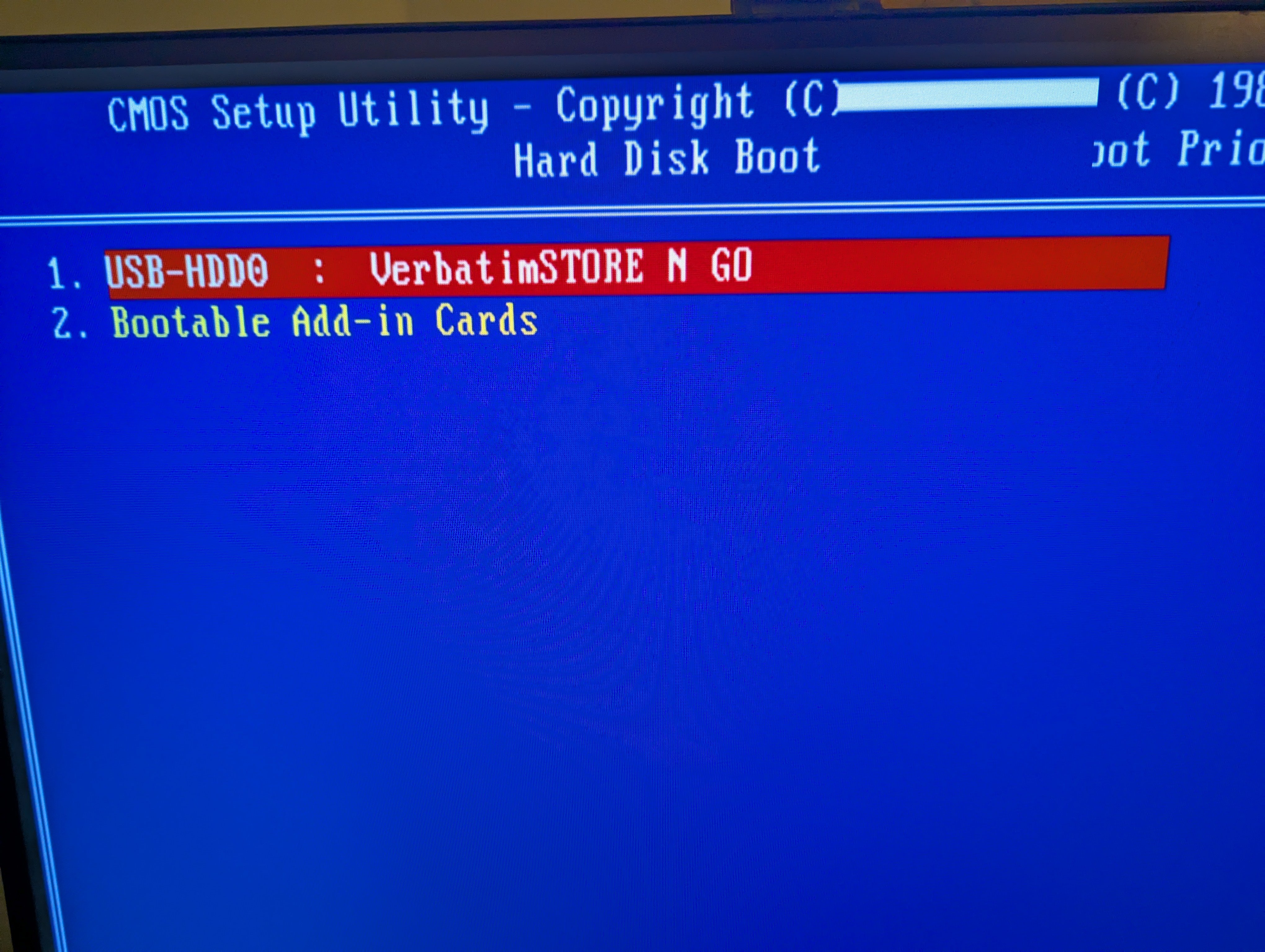

  3. Thanks for the help so far. USB stick is on a rear port Photo of boot priority attached Bios is version F7 Motherboard is revision 1.0

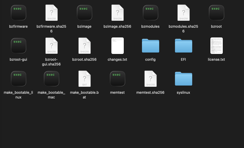

  4. I ran make_bootable_mac and a Terminal window popped up that ended with a succesful confirmation. Same result (Loading Operating system) afterwards. Board is GA-Z68XP-UD3P

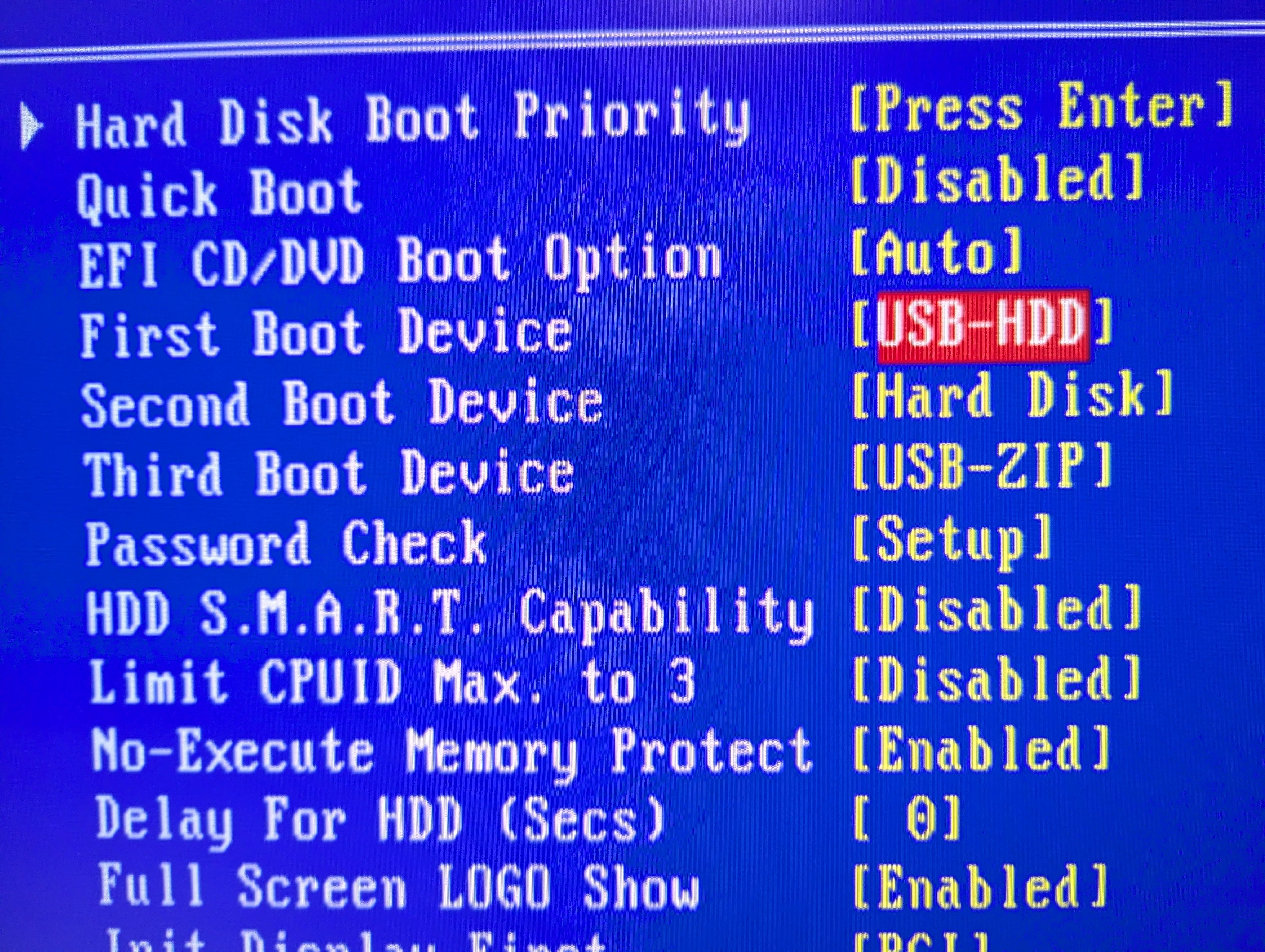

  5. Error: Black screen saying "Loading operating system" and nothing else. I am unsure whether I am using legacy boot or UEFI. How do I check that? Before I ran it I checked the USB stick and it just says "EFI"
