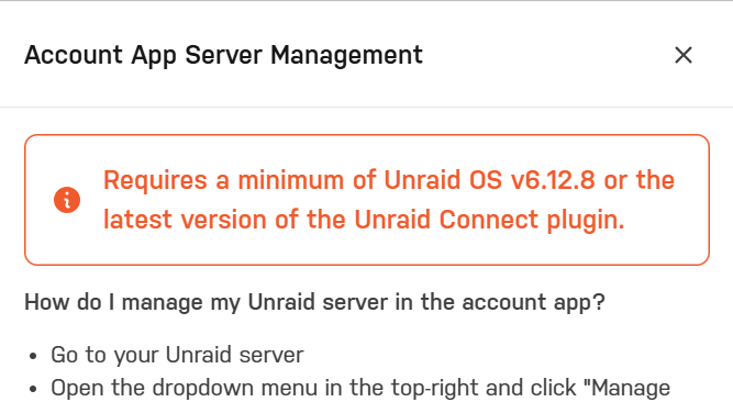

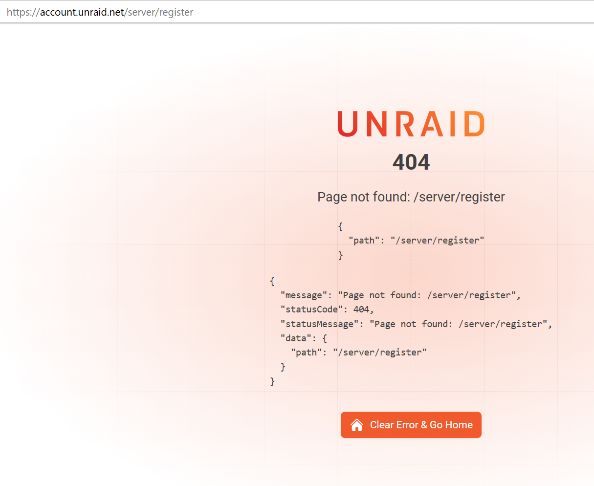

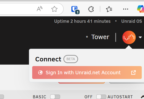

  21. @JorgeB ok, sorry to unmark your solution - but this is still proving troublesome... I was trying to connect the connect server to UnRAID account for management and when I try to connect it I get this error; Also, when I try to Connect it to unraid.net using the server login; I get this error; So... it looks very unreliable as though the upgrade to v7.0.1 (as it shows at the server console) hasnt installed properly - also there is no version showing on the dashboard, so it looks like something has gone wrong. At the moment this machine is only working as a file server, but I am trying to add a Wireguard Docker and it wont let me... so I think the upgrade has not completed properly even though there is now a Starter licence showing as installed. So, what suggestions to fix this and get it running reliably as I am going home tomorrow and need to reliably get on this machine for remote support? Should I note the disk assignments and do a fresh install on the USB key? If so is there an up to date tutorial showing how to reinstall and load the licence key when done? Thanks

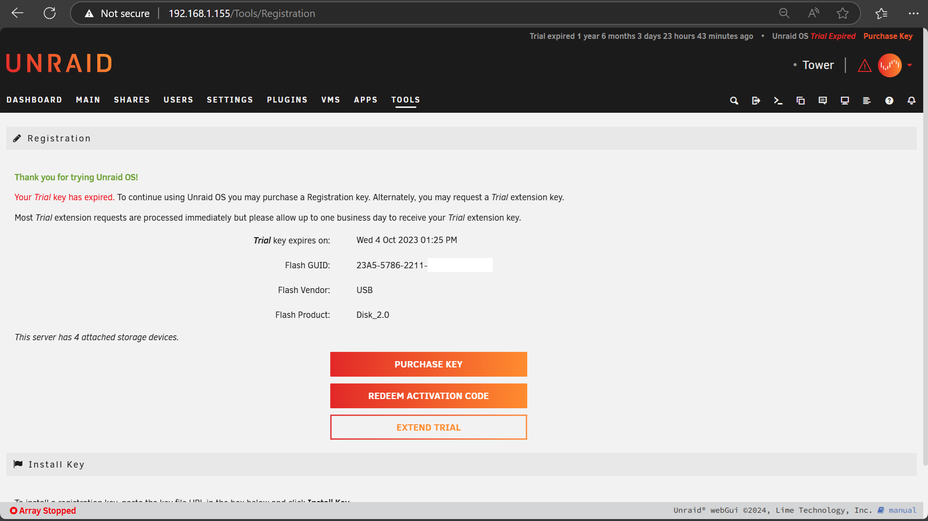

  22. Thanks @JorgeB I have booted into safe mode with GUI and now am at the purchase key page... interesting as there are no plugins or VMs installed... but at least this seems to have worked. If I get any more problums I will update - thanks 🙂 Hopefully anyone else with this problem will find this solution and try it first.
  23. I have tried from a different browser (Android & Windows Edge) and still get the same error. Here is the full screenshot of the registration page, as requested...
