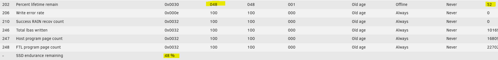

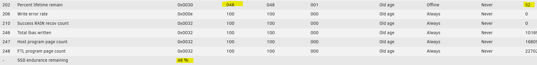

Never seen that issue, and I have several, are you looking at the normalized or RAW value? What matters for these SSDs is the normalized value; that value decreases with usage, and the raw value increases inversely.
