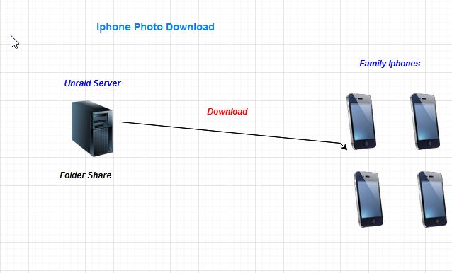

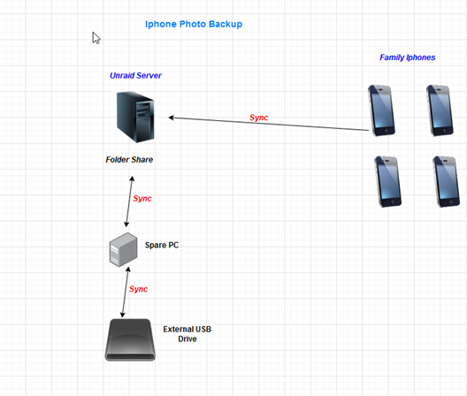

  20. Looking for some thoughts/ideas on the following Phase 1 - Backup Iphone pics/videos to unraid server over wireless / cellular - Folder structure – Year, month, day - Sync to Spare PC - 1st of each month back up to External USB Drive - Once items are sync’d to Unraid server and verified delete off of iphone (Manually, or delete after so many days) - Which IOS app would work best for this? Free first if available or lifetime subscription. Resilio Sync, Photosync, Synthing, Nextcloud, etc - Security is important - Each iphone would have it’s own backup folder \\member1\backup\iphone\year\month\day - Upload in original quality Phase 2 - Be able to download photos if needed back to iphone. - Any way to download by folder? Vs selecting each single photo - Would like to use same IOS app as in Phase 1 if possible
