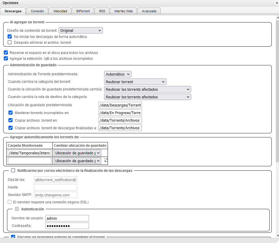

  9. Yes, many times, and also reboot the docker itself, it still creates folder in the cache no matter what I try... and I can´t understand why or how that happens.

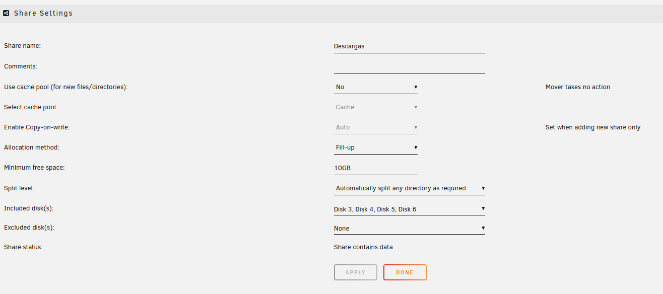

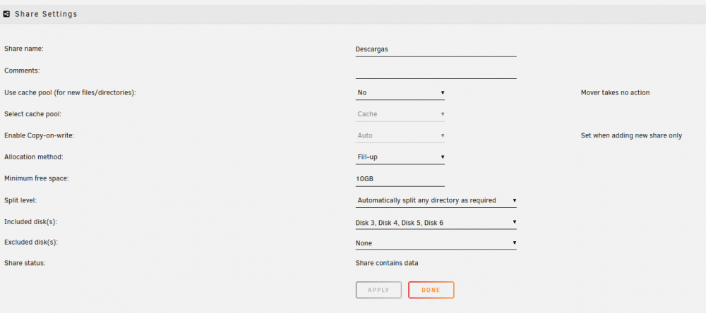

  10. The version is 4.4.1. Yes, "Descargas" is Share2 in my example, and yes, the full path is /mnt/user/Descargas/ And, just to be sure:
  11. Ok guys, I have been wandering the forum and the internet for more than 12 hours without having a clue of what to do, this is my problem: Original config: I have an SSD cache where I downloaded my torrents, after the torrent is completed It moved to another folder on my cache, like this: Share1/Temporal (Cache only) Share2/Downloaded (Array but catched) Share1 was a cache only share and Share2 was an array share that used the cache, the idea was download torrents and once they where completed copy them to the "Downloaded" folder and after that the mover will put them on the mechanical disks on the array. The problem came when I noticed that some files where keep in the cache, of coure if the file is being read the mover cant move it to the array, so I chaged to: New Config Share1/Temporal (Cache only) Share2/Downloaded (No cache at all) With this config the mover is not necessary and qBittorrent acts as mover when a torrent is completed. Ok, her is where things get out of hand, as I said Share2 has cache set to "NO" but no matter what I do once a torrent is completed QBitorrent creates a "Downloaded" folder inside the cache, of course the mover does nothing because Share2 is set to cache "NO". In the docker /data is set to /mnt/user/ What am I doing wrong?
