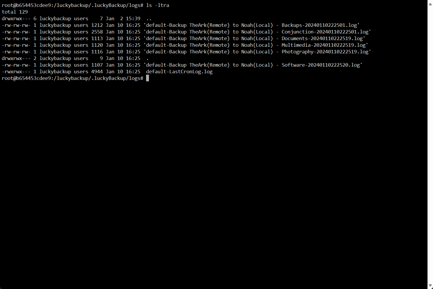

Just want to throw out that I have tested with and without "root" mode, and when I schedule my cron I have tested with and without "console" mode. Both options are working for me with the .profile workaround. I just tested at 4:25 PM EST (which is 16:25 in LuckyBackup) and it worked fine, nonroot and not in console mode: Make sure you're not doing something silly when making the schedule like forgetting that lucky is a 24 hour clock and not a 12 hour clock. So, 5:00 PM for example is 17:00.

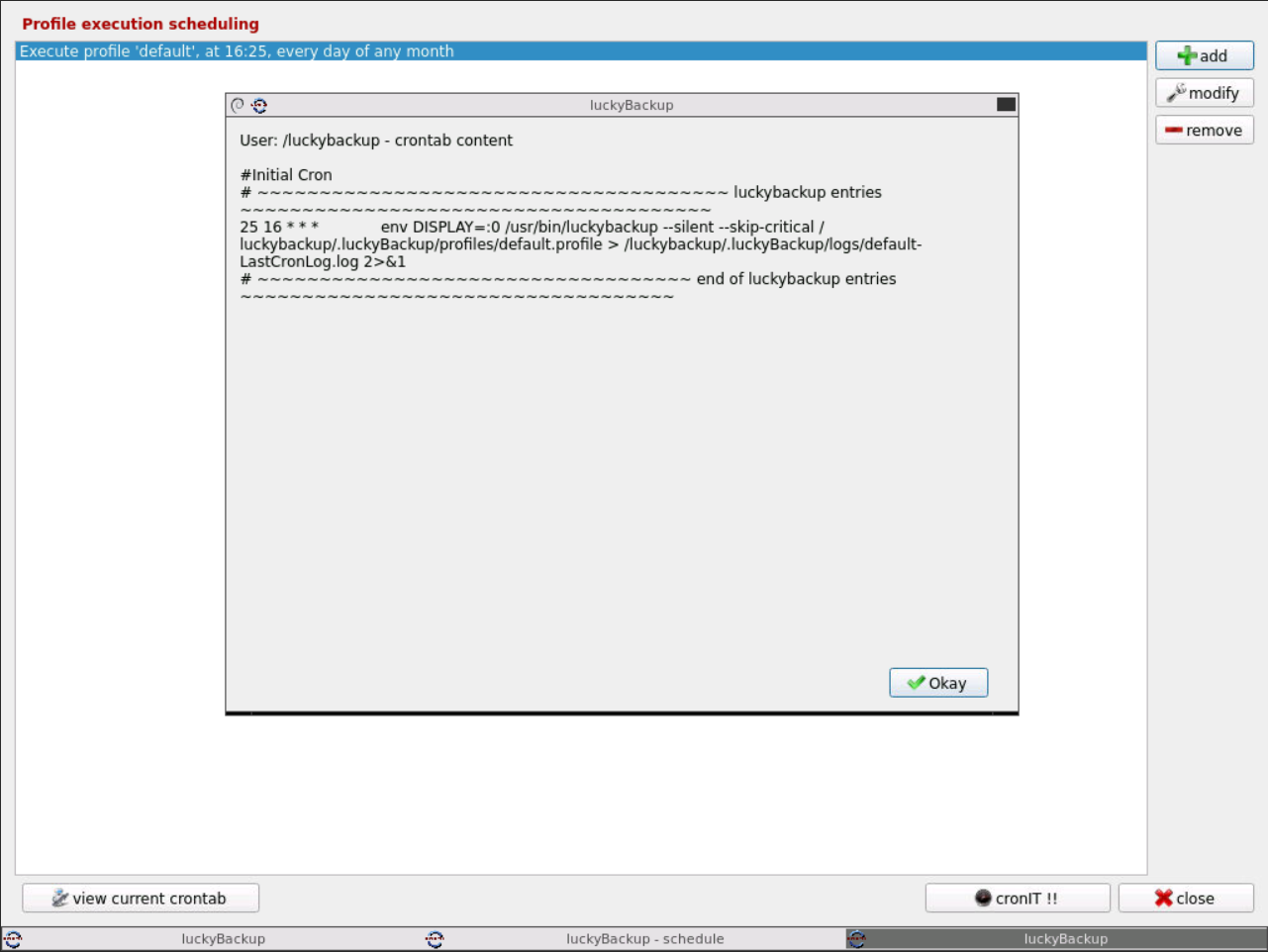

This does not look right? Why "I"root and not /root Iroot/.luckyBackup/logs/daily-5am-LastCronLog.log 2>&1

I think it looks fine. I just did a simple test of running all my backup jobs here in EST and it worked fine for me. @ 11:22 EST my cron'd backup job kicked off without issue.

Create another job in there to run in just a couple minutes, see if that works. Would verify if we're close to something or not.
