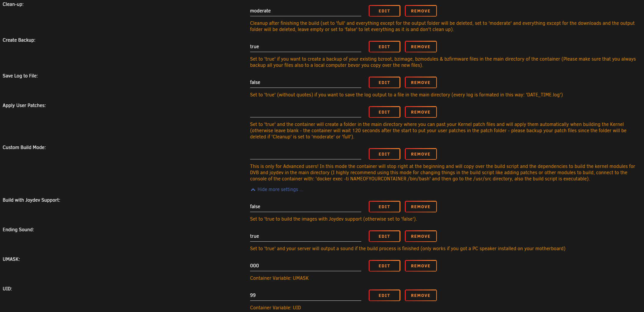

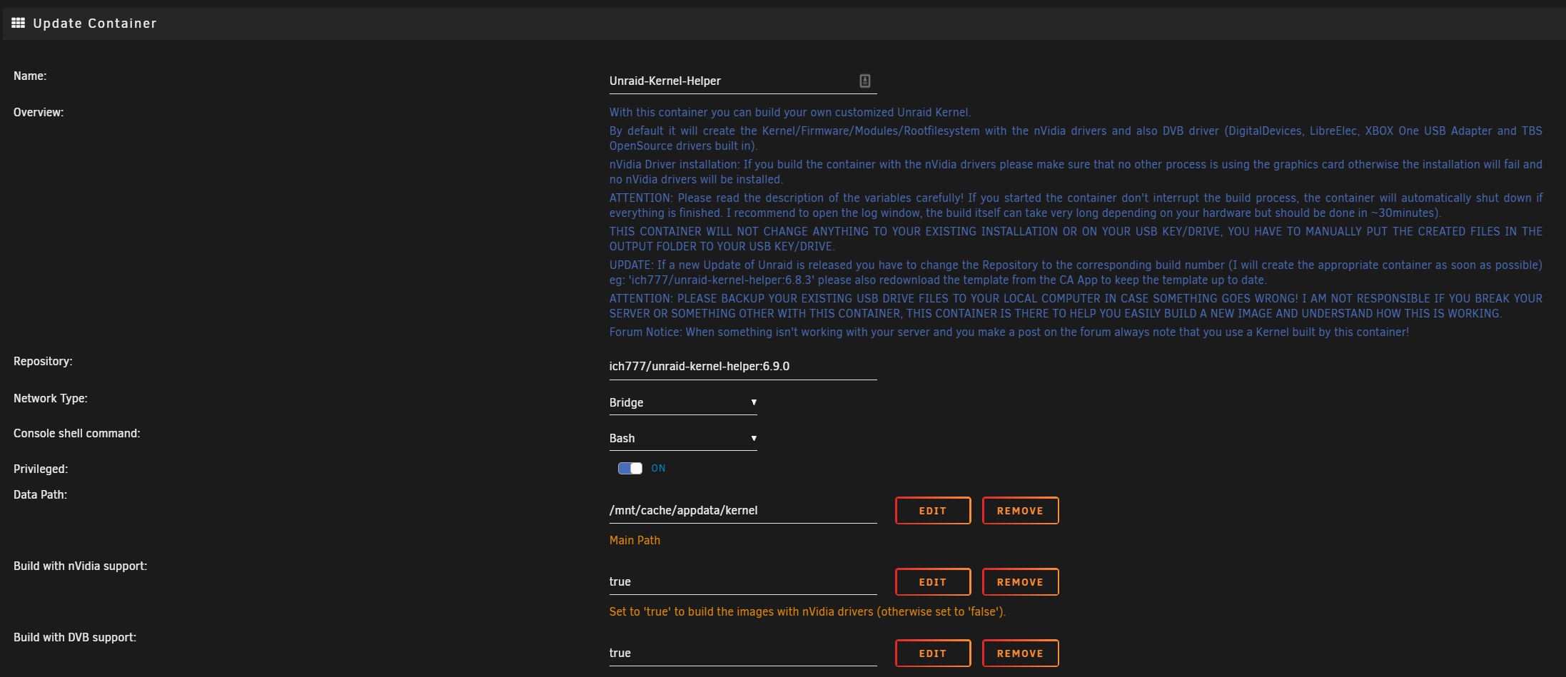

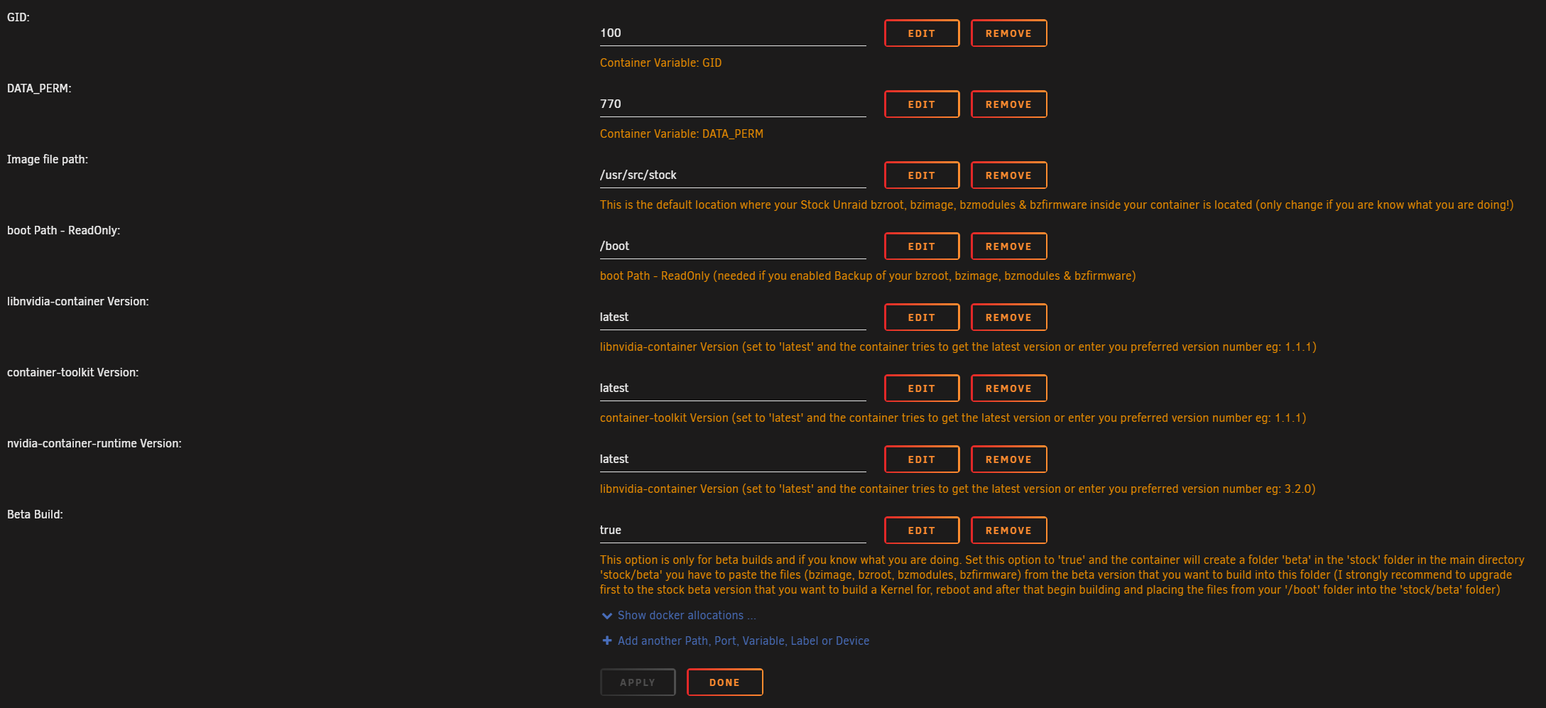

Is there supposed to be a new/different variable other than the regular true/false Beta Build value? Instead of saying "true" should I put "beta25" instead? EDIT, just tested and YES seems instead of putting "true", the value "beta25" also works, so no having to copy, very cool!

I world recommend updating the default kernel path from /mnt/cache to /mnt/user, now that we have multiple pools. I run my appdata now on a drive other than cache.

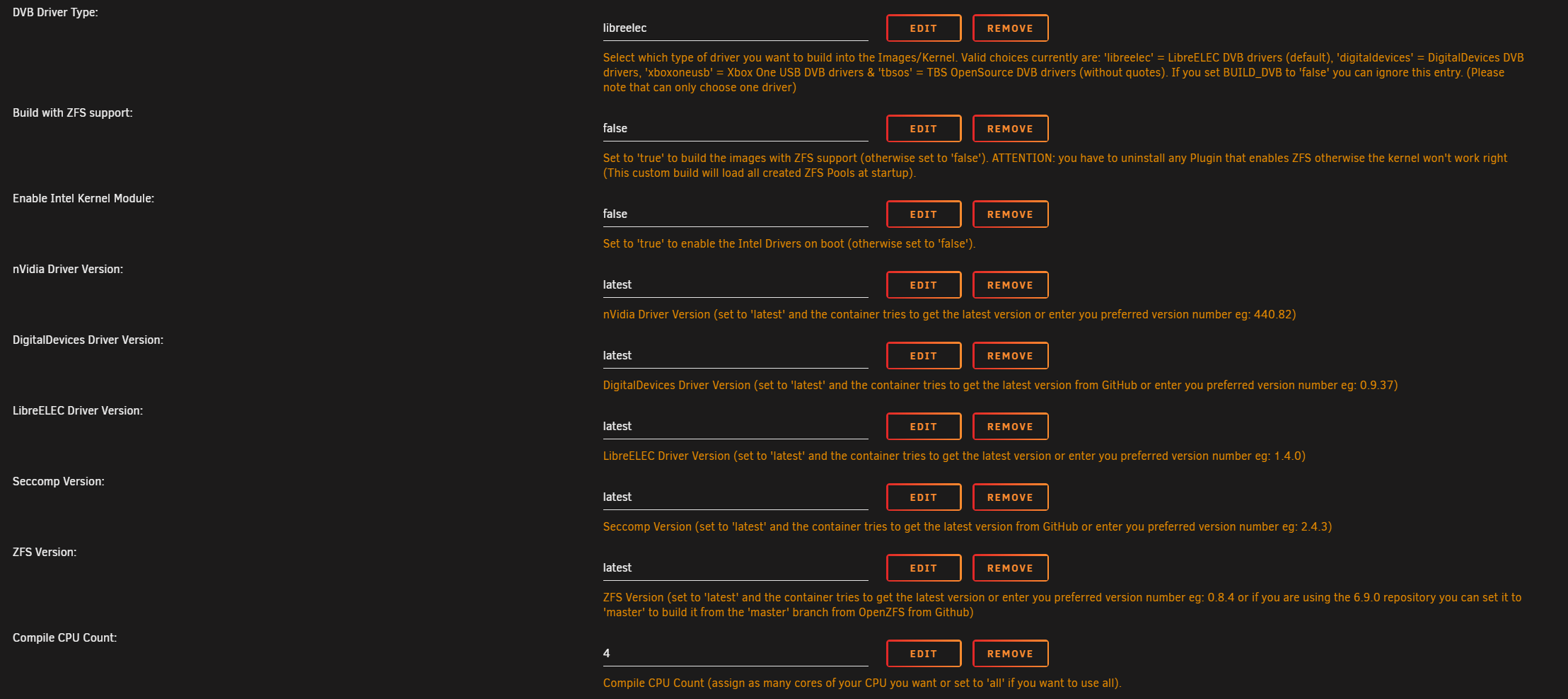

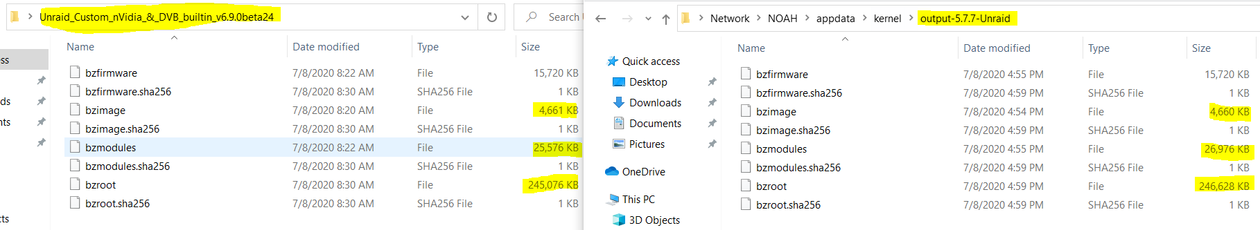

Of course, that is expected. What I was thinking to see though, is assuming I left all default values, then only change to Nvidia (BETA now) and latest DVB, then the outcome would be the same (or close). I am sure it's not an issue, as it seems to work fine. I was just pondering why sizing was different if all else was same :-).

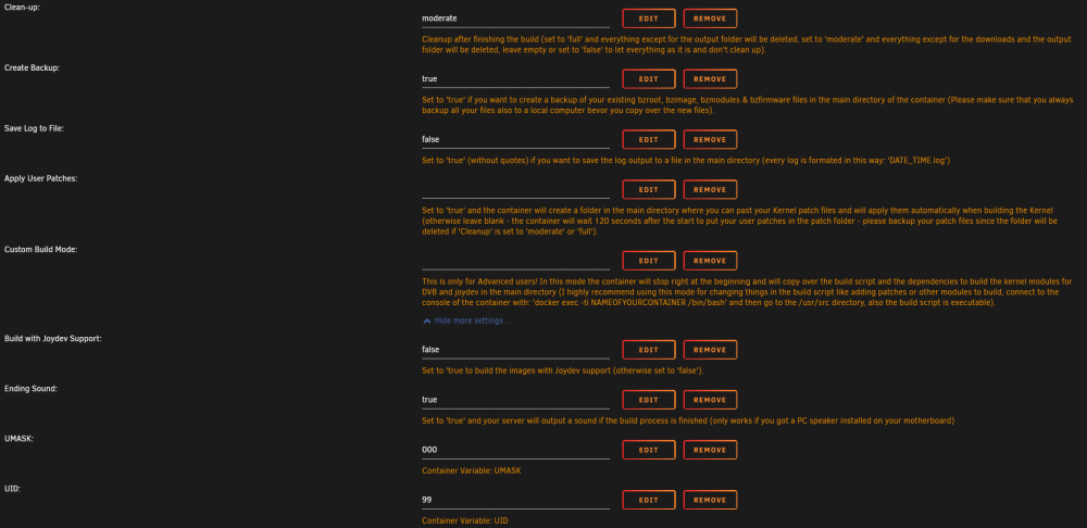

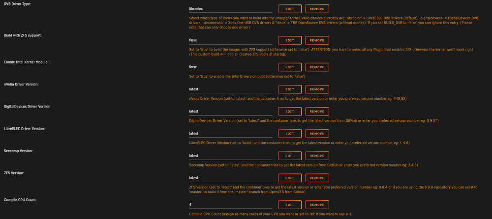

Yep, that may very well be it. I will try by modifying the Nvidia driver version to the specific version vs "latest" 🙂

@ich777 Is it expected that the sizes of the re-compiled files vary slightly in size? What I mean is I am using this to compile latest 6.9.0 beta 24 for Nvidia and DVB, using the defaults of latest and latest with beta enabled. The compilation seems to go smooth and without issue. But, if I download your pre-compiled beta 24 with nvidia and dvb and look at the file sizes compared to mine, they are slightly different. Does the fact that my architecture is an AMD system make a difference?

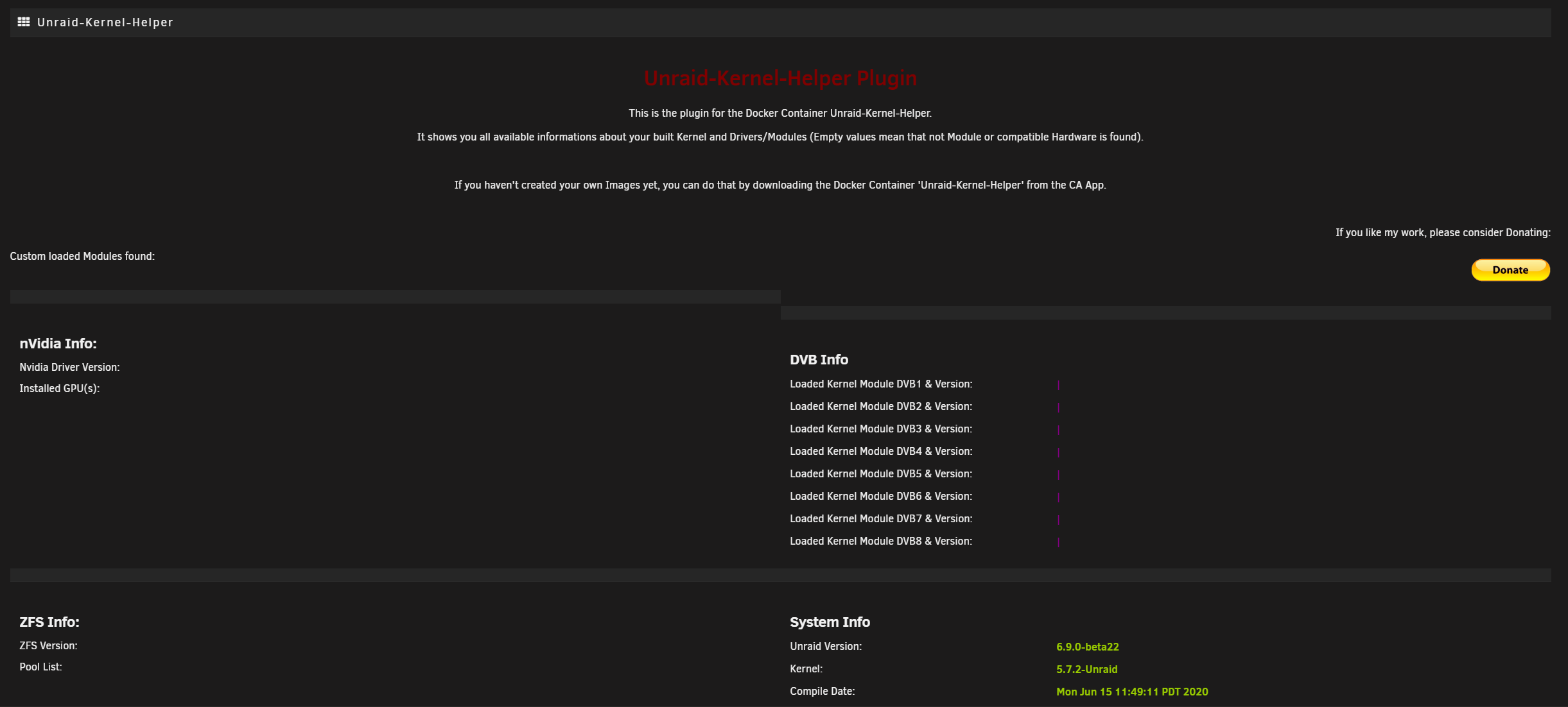

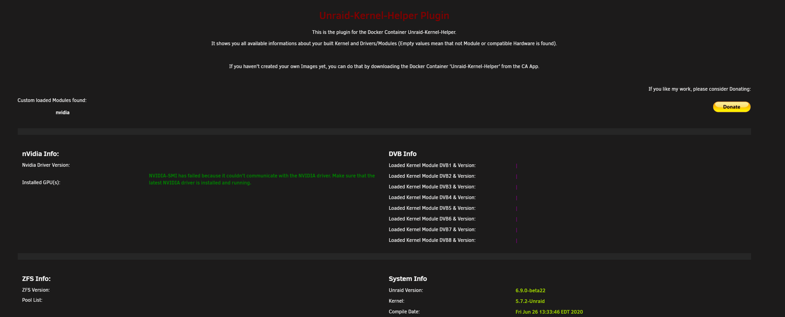

As suspected 🙂 Only thing that would throw me off a little, I am preloading the modified kernel before I am installing my Hauppauge card as well as my Nvidia GPU, that will come this afternoon. But the wording on the page makes me think that the driver isn't loading properly. I can only assume this message is appearing because I don't yet have the GPU installed. Perhaps it should say something like "Make sure that the latest NVIDIA driver is installed and running and your GPU is properly installed and detected"?

Absolutely great Plugin and Docker, truly thank you. Just wanted to report one small, superficial visual anomaly. I run a widescreen, high res monitor and I notice the separation bar on the plugin helper screen breaks in the middle. I use Chromium Edge:

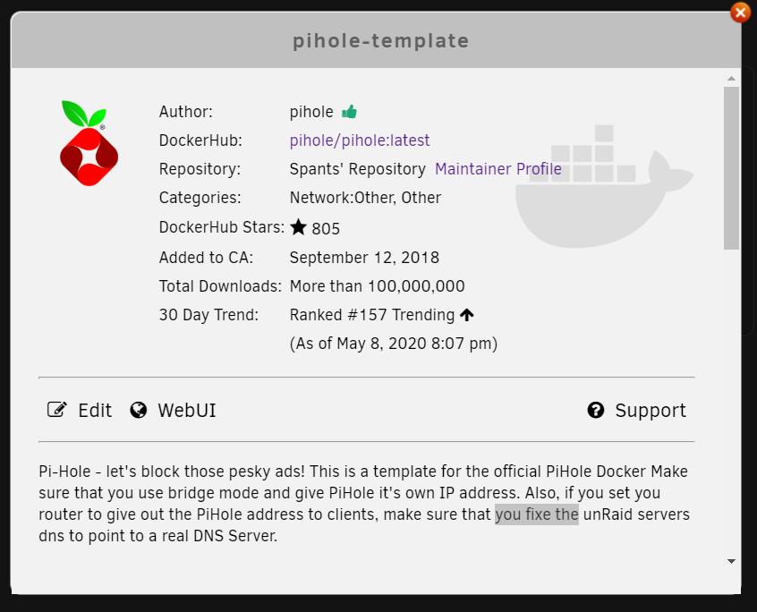

@spants just wanted to call out a small typo in the CA Info notice for this template. "make sure that you fixe the unRaid servers dns to point to a real DNS Server." Should probably be something like: "make sure that you have fixed your unRaid servers dns to point to a real DNS Server other than your PiHole."
