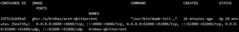

  4. binhex-qbittorent - cannot get port forward to work. I do not use a VPN, so this a basic setup. I got it to work once, but once I restarted the container it stopped working, I tried a few things but now I'm unsure of where I'm at with, so had a do-over. The icon in qBittorretn shows as "Connection Status Firewlled" I have port 61006 set in qbittorent, UPnP/NAT disabled. I have this for the container 172.17.0.3:61006/TCP <---> 192.168.1.10:61006 172.17.0.3:61006/UDP <--->192.168.1.10:61006 172.17.0.3:8080/TCP <---> 192.168.1.10:8080 My router has this for TCP/UDP App | binhex | EXT port 61006 | INT port 61006 | INT ADDRESSS 192.168.1.10 | SOURCE 192.168.1.10 Should this be working or have I got it all wrong? I currently have a VM running qBittorrent and that works fine, different ports to the above. Also confused as to why docker ps show 0.0.0.0.
