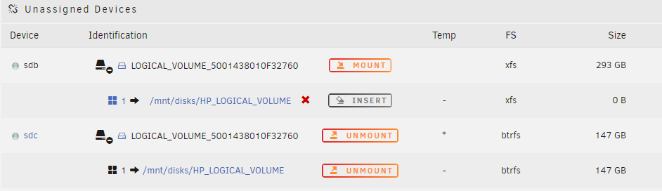

  12. Currently I am just trying to get everything configured over VNC, my goal after that is done is to use a remote connection tool like TeamViewer or something similar. Unfortunately I am running into an issue with the vanilla build where the mouse will just stop working (The pointer will follow the dot from VNC for a while... then the pointer "sticks" and that's the end, the dot still moved but the arrow sticks, clicking does not respond to what is under the arrow either). Restarting the VNC window doesn't make a difference, I have to restart the VM and then it will work again for a short time. So far, it hasn't run long enough for me to get TeamViewer installed. I've now downloaded TeamViewer on another system and hope I can browse to the network and run it before the mouse disassociates. I have tried each of the VNC settings for the mouse with no luck. Any pointers would be great (I am running with the vanilla XML after the mouse line was removed) Thanks!
  13. I was able to let Unassigned-Devices mount the prior one by removing the partition on the newer one. I then created a share with a preference to cache (just for speed) and did: cp -r /mnt/disks/* /mnt/cache/RecoverVMS/ one that was complete I connected to the HP server and recreated my 8 disc SSD array as a single RAID 5+0 mounted that as an unassigned device with the same mount point of the previous and then did a copy in the reverse direction I have restarted my VMs and they are functioning, I'll count that as a success. Thank you for all of your help, in the end I decided to risk the data for the opportunity to consolidate the space into a single disc running with it's own redundancy. That way in the future the data is better protected.
  14. You were right, the names that HP assigned were: LOGICAL_VOLUME_5001438010F32760_3600508b1001c3ef5300bf0e49df986fa (sdb) LOGICAL_VOLUME_5001438010F32760_3600508b1001c3d2b732d4816c14b3a1e (sdc) Unfortunately it does not appear that it is something that can be changed If it isn't possible to mount them both should there be any issue with me copying the items off the currently mounted unassigned device to the array, recreating the logical volume as a single volume and then copying the images back. Most specifically, I just want to make sure that shouldn't cause issues with my VMs Thank you
  15. 1st off, thank you for the plugin it has been working wonderfully for me for quite a while. I'm running on an old HP Server and I had split my 2.5in SAS raid block as 2 separate partitions to be used as a cache and as an unassigned space to mount VMs I have now upgraded to a larger SSD Cache and was just going to mount the previous cache as a second unassigned device. Unfortunately when I mount it I can no longer browse the 1st. It appears the issue is the SAS is identified by the same ID, so even though I have sdb and sdc when I change the mounting point for one it changes for the other. I tried two different FS just to see and that did not change anything. Is it possible to mount them separately? If not, if I copy the 147GB partition to my array, and then merge the two within the HP utility, and then remount and copy the files back would I run into any issues within my VMs (if I keep the naming convention)? Would you just suggest a cp -r /mnt/disks/HP_LOGICAL_VOLUME/* /mnt/cache/ from shell or another method to move it? Thank you for any assistance or guidance you can provide.
