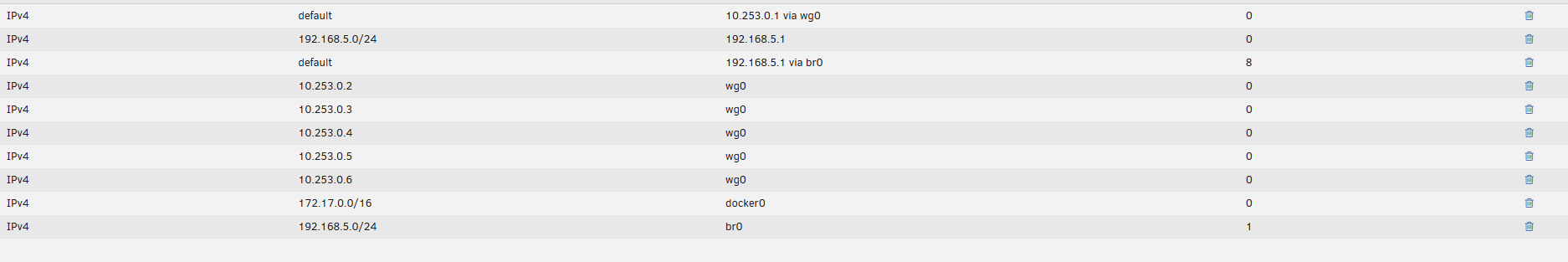

  5. Tried this, also disabled VPN to simplify the routing table. Still nothing. I really don't understand how I can access my server via the network, but it can't ping or seem to access my router in any way? How does that even make sense?

  7. I don't think it's a DNS issue, I can't even ping 8.8.8.8 from the main console From my docker containers (Sonarr, Radarr) I get both DNS resolution and connectivity: sh-5.3# ping 8.8.8.8 PING 8.8.8.8 (8.8.8.8) 56(84) bytes of data. 64 bytes from 8.8.8.8: icmp_seq=1 ttl=110 time=30.2 ms 64 bytes from 8.8.8.8: icmp_seq=2 ttl=110 time=28.5 ms 64 bytes from 8.8.8.8: icmp_seq=3 ttl=110 time=31.4 ms 64 bytes from 8.8.8.8: icmp_seq=4 ttl=110 time=29.6 ms ^C --- 8.8.8.8 ping statistics --- 4 packets transmitted, 4 received, 0% packet loss, time 3004ms rtt min/avg/max/mdev = 28.544/29.922/31.420/1.039 ms sh-5.3# ping google.com PING google.com (142.250.190.46) 56(84) bytes of data. 64 bytes from ord37s33-in-f14.1e100.net (142.250.190.46): icmp_seq=1 ttl=110 time=20.1 ms 64 bytes from ord37s33-in-f14.1e100.net (142.250.190.46): icmp_seq=2 ttl=110 time=21.1 ms 64 bytes from ord37s33-in-f14.1e100.net (142.250.190.46): icmp_seq=3 ttl=110 time=22.6 ms 64 bytes from ord37s33-in-f14.1e100.net (142.250.190.46): icmp_seq=4 ttl=110 time=19.2 ms ^C --- google.com ping statistics --- 4 packets transmitted, 4 received, 0% packet loss, time 3002msFrom main console, I get nothing: root@Tower:~# ping 8.8.8.8 PING 8.8.8.8 (8.8.8.8) 56(84) bytes of data. ^C --- 8.8.8.8 ping statistics --- 42 packets transmitted, 0 received, 100% packet loss, time 41984ms root@Tower:~# ping 192.168.5.1 PING 192.168.5.1 (192.168.5.1) 56(84) bytes of data. ^C --- 192.168.5.1 ping statistics --- 135 packets transmitted, 0 received, 100% packet loss, time 137210ms
  8. I added a new 2.5gbps NIC, swapped the eth0/eth1 devices, and rebooted along with swapping the connection to the new NIC. Now I'm getting some strange network errors. Fix Common Problems reported that it can't connect to Github, and my docker images can't find updates There is an error message from Unraid Connect: "NETWORK: getaddrinfo ENOTFOUND mothership.unraid.net CLOUD: socket closed" unsure if related, but my main user for Plex can't see my libraries, while switching to a managed user will let me see my libraries. How to I fix my network settings? tower-diagnostics-20260126-0033.zip
