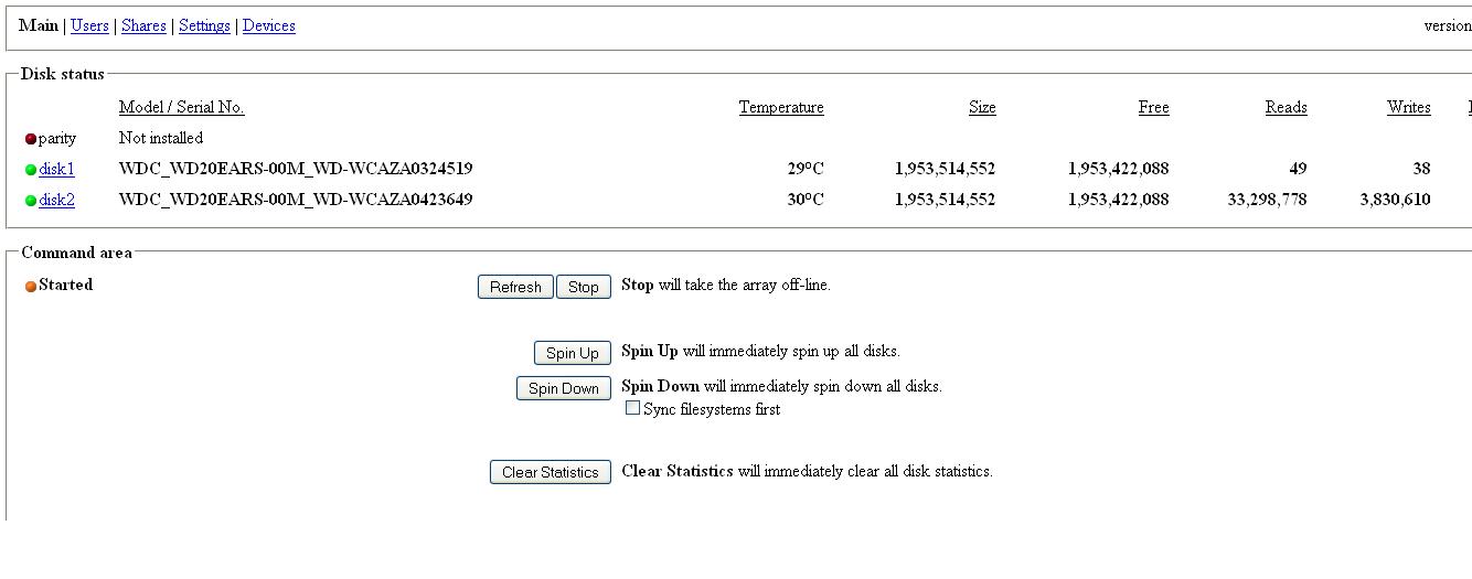

Spinbot thanks for the help. I realize this HDD issue is getting a bit off topic and probably should have gone in hardware, but can someone give me some idea of what is going on with my drive or at least where to look? I've been spending hours and hours and hours (I know like everyone else is), but I can't seem to find why this drive is so much slower and has much less read and writes after formatting compared to disk2. I just want to be able to understand my hardware before I get too deep into saturating the server with data. I was able to transfer a movie file(through shares in my network places) onto disk1 (the slow drive), that took about 2.5 hours for 8GB. I also transfer the same file to disk2 and that only took about a hour. Do I need the bwm-ng package to determine the actual disk performance for reading and writing data? Should I just change my sata cable and run preclear again and depending on the results switch Hot-Swap Bays? I don't have the full syslogs from my Disk 1 preclears because I only copied the SMART data, which was fine. Thanks for any help or pointers in the right direction.

This leads me to believe that disk 1 didn't format properly since the read/write of your fresh drive is similar to my disk 2, but my disk1 looks like it has no activity. I wonder if this could also be part of any possible problem causing the very slow pre-clear. I have a parity disk but it needs pre-clearing as well. I was going to wait until I had done some initial population of my data disks (original data still kept, since not protected by parity) before adding it. *Edit: hdparm -I report attached if it helps anything. Although I suspect no since not errors are being reported. HDparm_Disk1-12-12-2010.txt

I jumpered both drives. I didn't see a spot for individual ports in the BIOs but I did change it over from IDE to SATA. I have the SUPERMICRO MBD-X8SIL-F-O motherboard, SuperMicro CSE-M35T-1B hot swap bay(s), and locking sata cables from monoprice I also attached an image(don't know where to host it) of when I added disk two to my pool after it has formatted. I haven't copied over any data but disk1 shows 49 reads and 38 writes, but disk 2 shows 33,298,778 reads and 3,830,610. Both show zero errors. Why such a big difference before even copying data over. Syslog_After_Preclear_Add_and_Format-12-12-2010.txt
