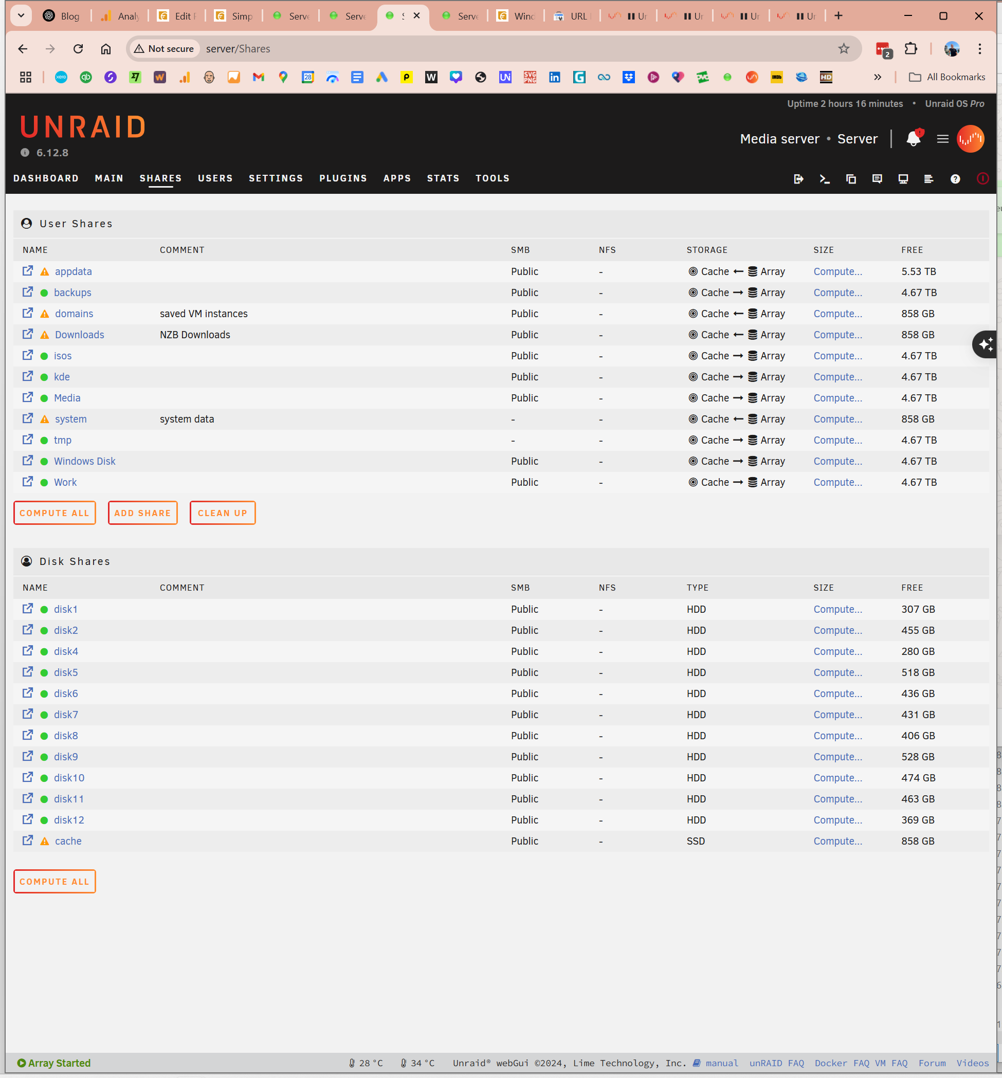

  1. /var/log is getting full Hi, hopefully you can help, new server build only been online a couple of days, recently replaced failing Parity drive with a precleared but older HDD so it may be the issue? Ordering some replacement drives shortly. Thank you :) server-diagnostics-20260803-1122.zip
  2. I don't see any folder on 11 for AppData? The docker image was on a separate SSD so I probably just made it a similar size to the disk so thanks for reminding me. I'll look at shrinking it.
  3. Ok, I moved the files to the cache disk and my docker seems to be working well now! Any housework that I need to do? I really appreciate you helping me out server-diagnostics-20250513-2144.zip
  4. I ran it a couple of times after turning of the docker but it stopped immediately. Thanks server-diagnostics-20250513-2056.zip
  5. Done server-diagnostics-20250513-2012.zip
  6. server-diagnostics-20250513-2008.zip

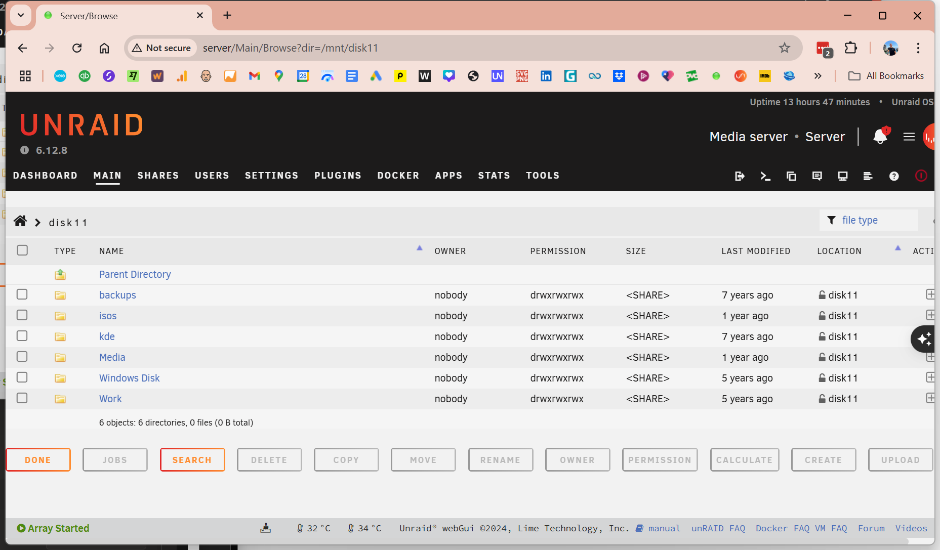

  7. I couldn't from the disks, it didn't show up but it was on the Cache disk. Deleted in now. Thank you. What's the next step? I guess my shares are not setup correctly in terms of location (array or cache)? I have managed to copy the docker.img back to the cache/system/docker folder. I really appreciate the help!

  11. drwxrwxrwx 1 nobody users 83 May 13 15:34 ./ drwxr-xr-x 20 root root 400 May 13 17:44 ../ drwxrwxrwx 1 nobody users 31 Jul 30 2017 .Trash-99/ drwxrwxrwx 1 nobody users 6 May 13 17:35 Cache/ drwxrwxr-x 1 nobody users 92 May 8 2024 Downloads/ drwxrwxrwx 1 nobody users 61 May 7 11:23 Media/ drwxrwxrwx 1 nobody users 43 Sep 2 2019 Windows\ Disk/ drwxrwxrwx 1 nobody users 82 Mar 1 2024 Work/ drwxrwxrwx 1 nobody users 174 May 13 14:07 appdata/ drwxrwxrwx 1 nobody users 93 Jan 15 2018 backups/ drwxrwxrwx 1 nobody users 22 Apr 22 20:41 domains/ drwxrwxrwx 1 nobody users 82 Jan 4 2024 isos/ drwxrwxrwx 1 nobody users 116 Oct 2 2017 kde/ drwxrwxrwx 1 nobody users 21 Apr 16 2023 system/ drwxr-xr-x 1 nobody users 6 Nov 19 16:54 tmp/
