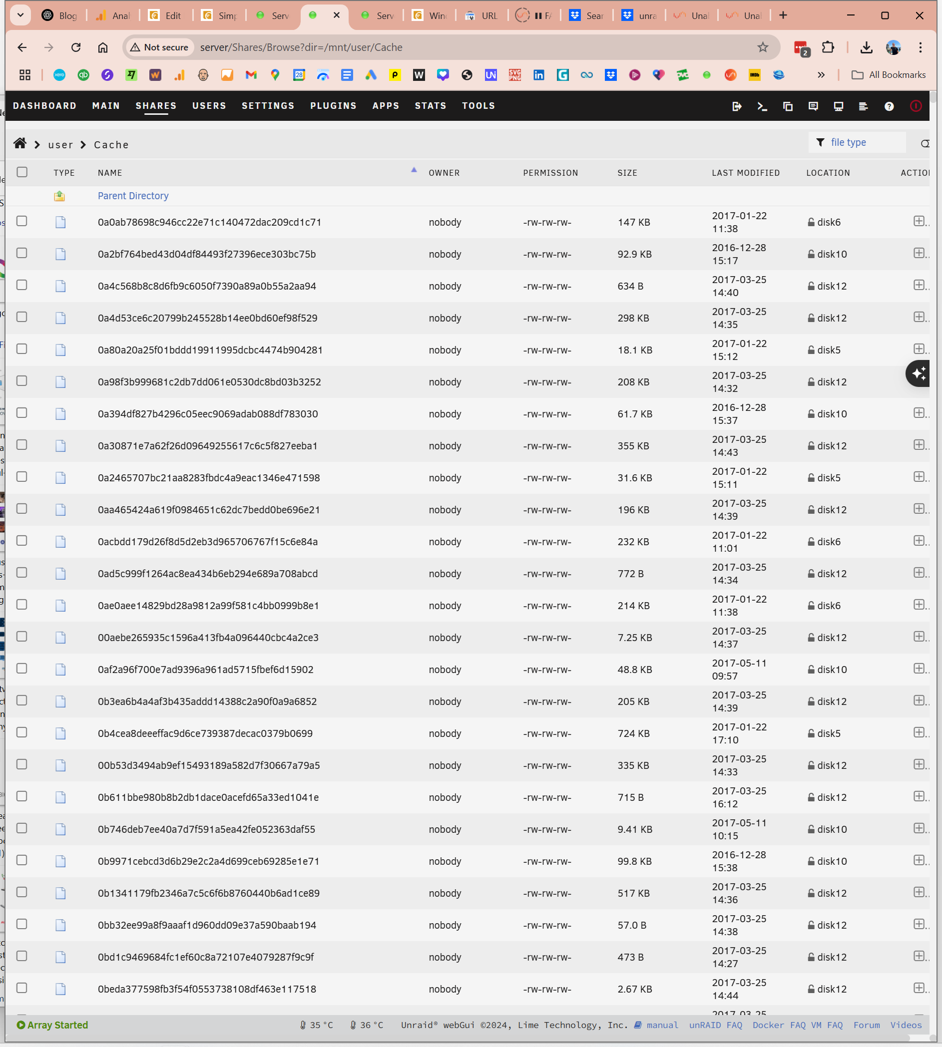

  13. Yes, I select this, scroll to the bottom click delete from the bottom menu and in the pop-up click 'start'. The screen refreshes and zero files are deleted. Could it be that the Mover is still running? (nothing is happening but it says it is running) I will reboot and try again.
  14. Completed but I can still only delete a few at a time manually.
  15. I can't delete the files. If I manually select a few they delete but selecting all and deleting doesn't work, nothing happens. There are over 3200 files
  16. No, it looks like a lot of tmp files. There are no folders or files with normal filenames.

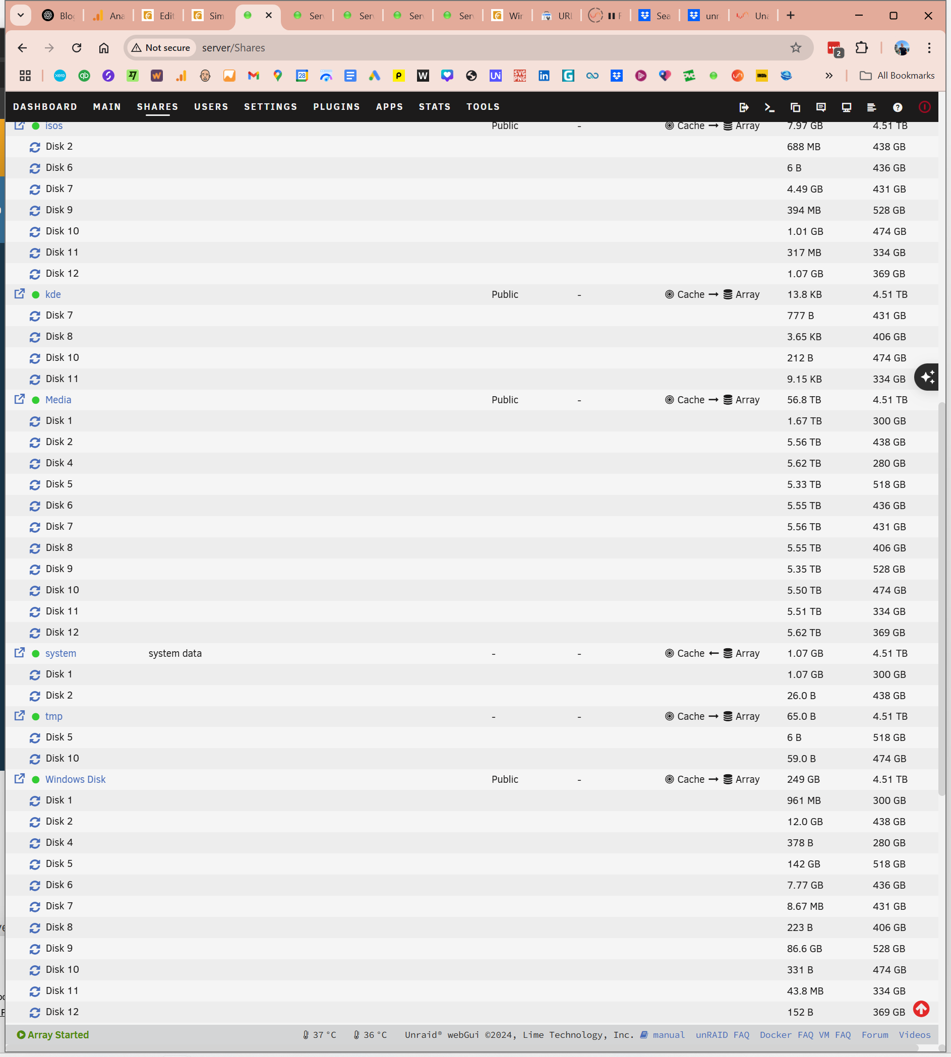

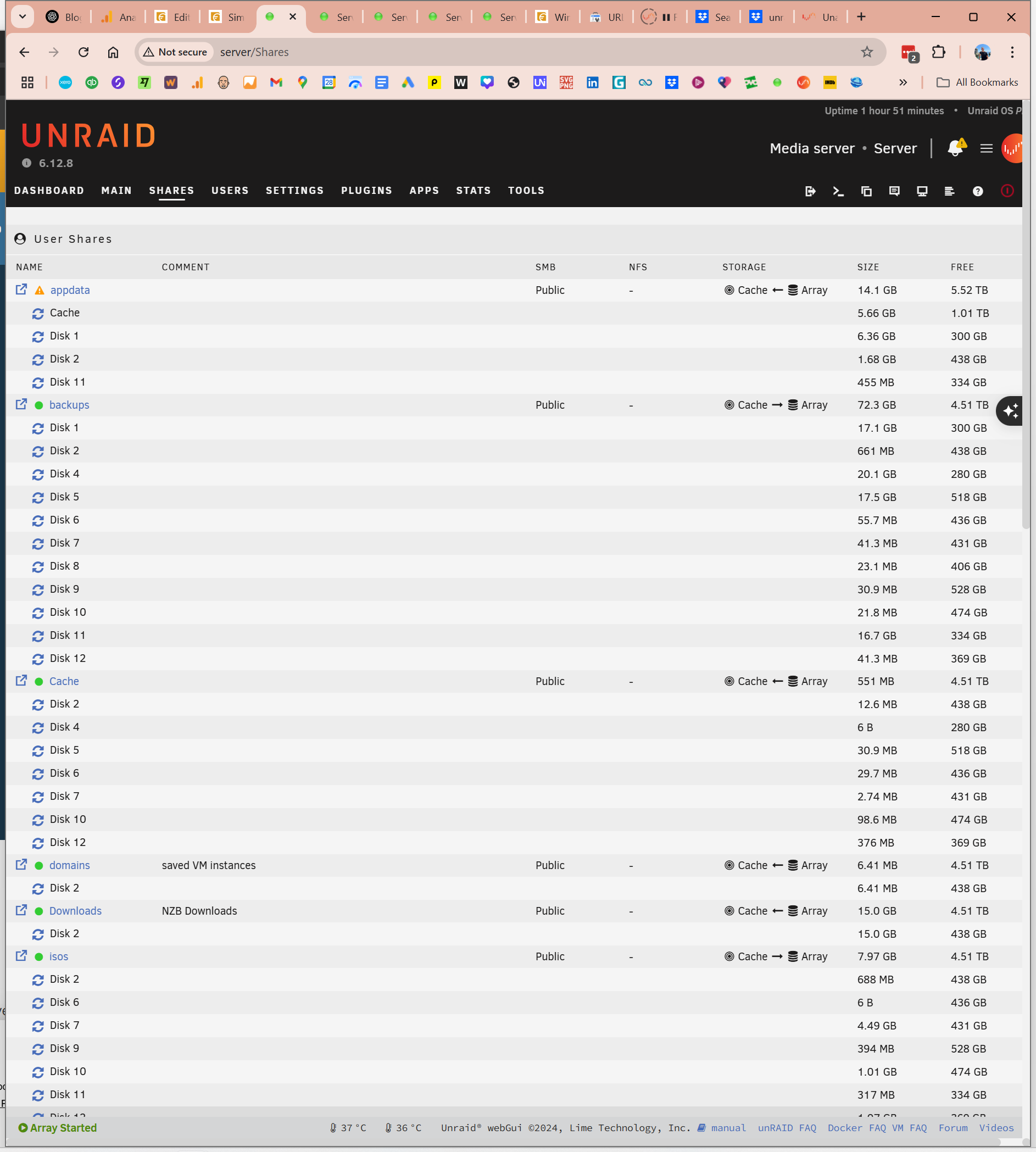

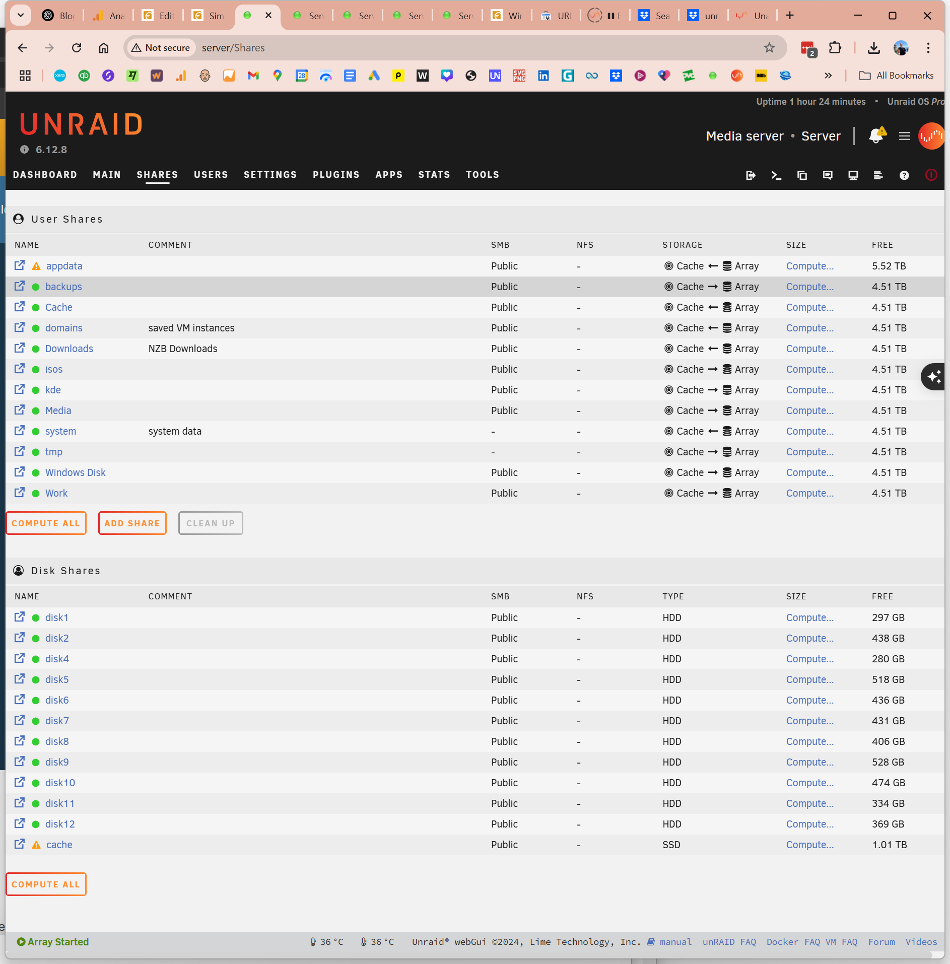

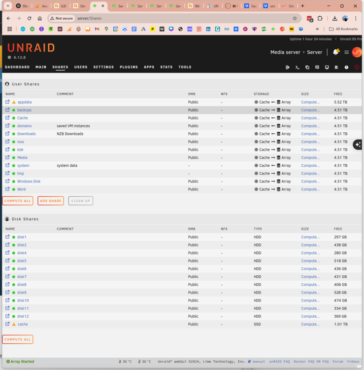

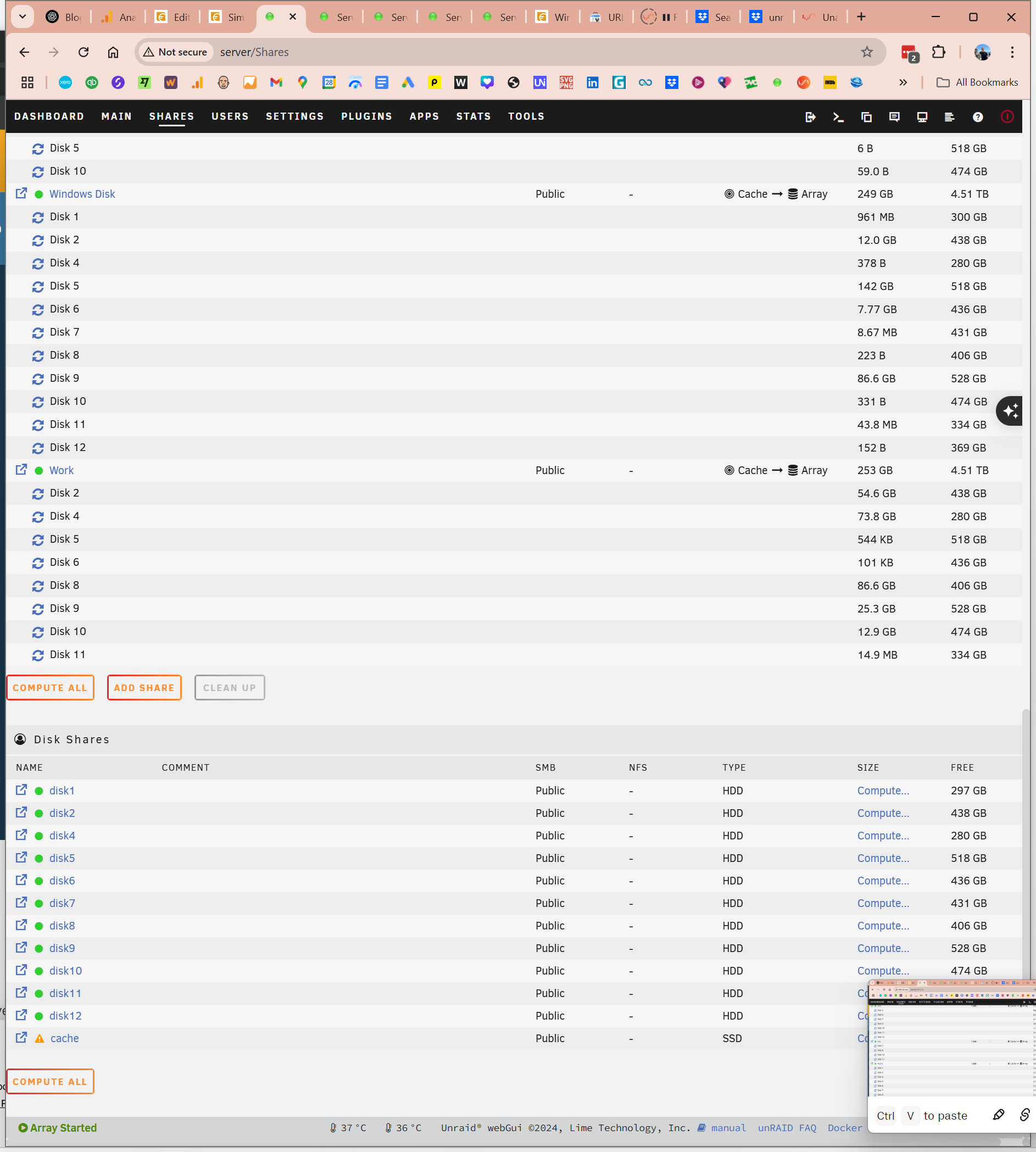

  18. Ok, here is the screenshot. After clicking clean up the replaced cache disk worked just fine without me changing anything about Pool names. I think it just saw it as a replacement. I am trying to put the shares back as they were, currently moving App data, system, domains, downloads and 'cache' to the cache pool. I also have no idea why I have a share called 'cache' I made this machine a very long time ago and I don't recall a reason for that, but I am a novice so your guess is as good as mine. Thanks for the help
  19. Where is the 'User Shares' page? Do you mean the 'Shares' in the main menu? As far as I can tell, I cannot start the array even if I set the cache disk to no device, therefore I can't access the share menu? EDIT: Ok I started array without the cache disk (oops) and clicked on clean up Thanks. server-diagnostics-20250513-1448.zip
