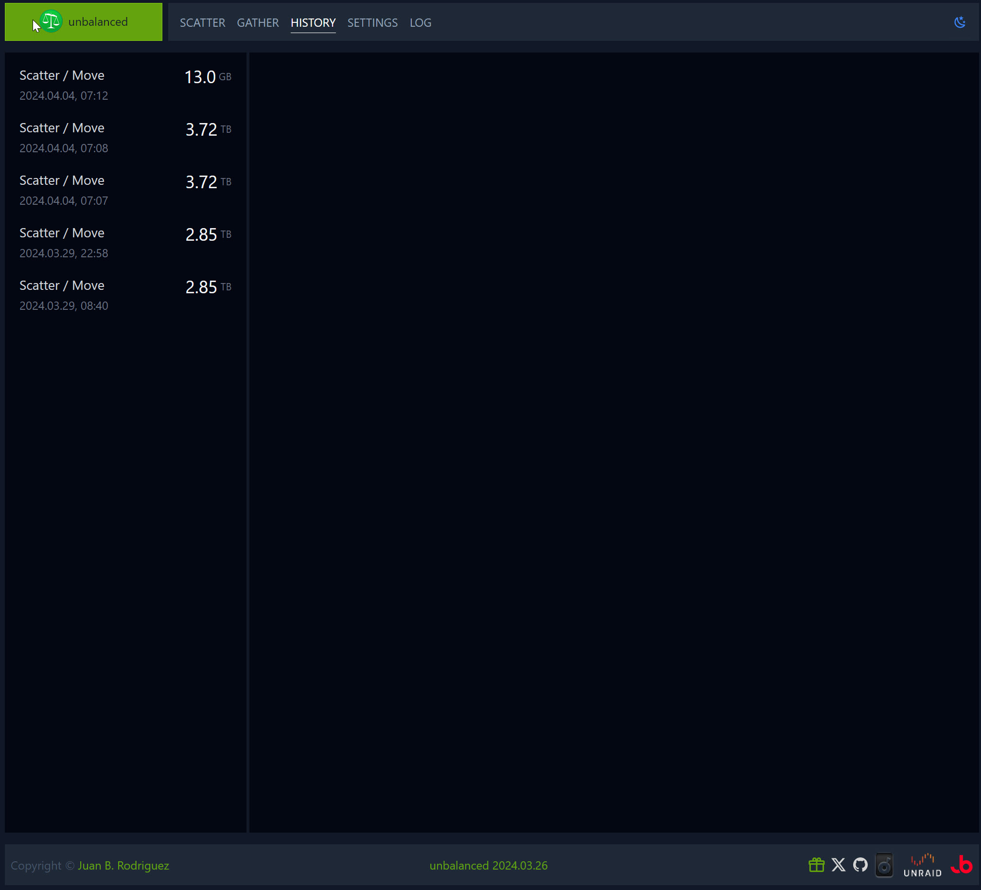

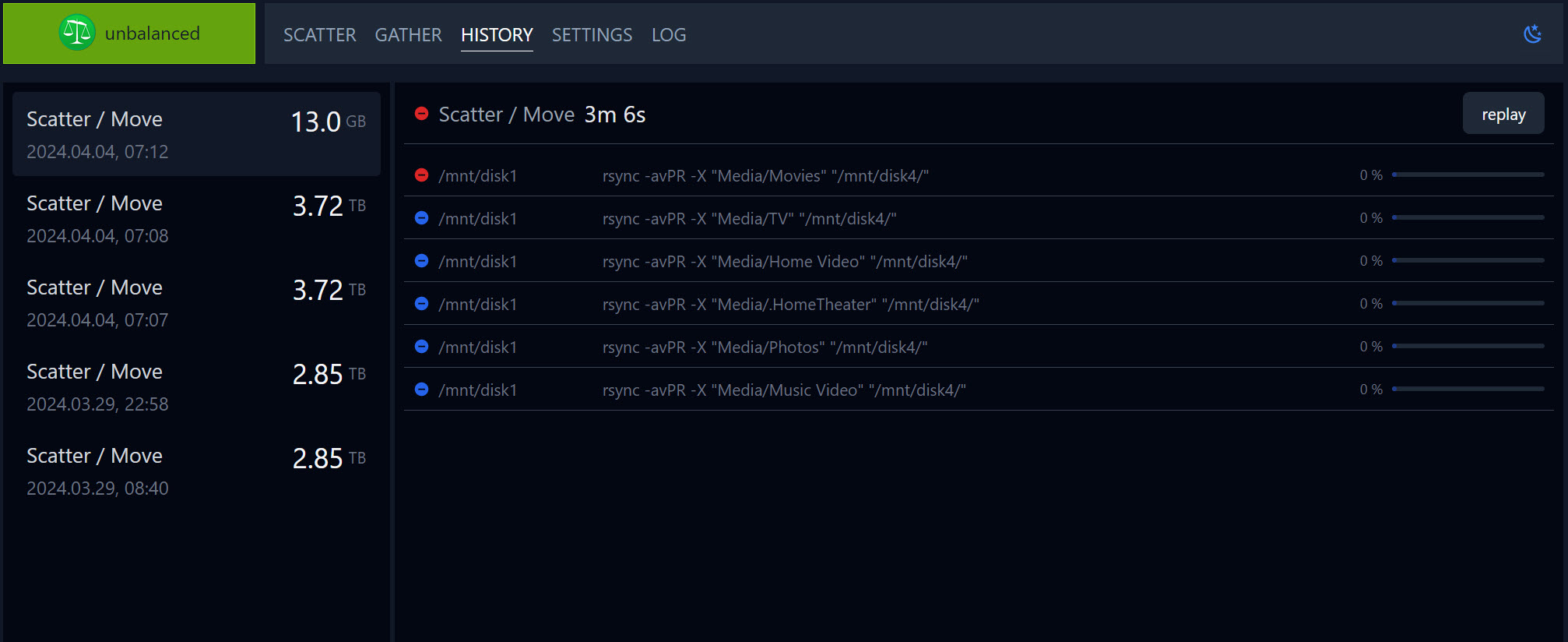

  7. Got it, dumb me! What are the blue icons? After thinking about it, probably means staged, next... Do you please have any tips on how to delete? I know this can be complicated, and dangerous. I figured out Midnight Commander, and deleted what was necessary. Thanks for your help, unbalanced is a great program!
  8. Thank you for replying, I appreciate! Here's my history tab, I don't see either green or red icons? Oh wait, is it the green icon in the unbalanced bar top left? If it is, that means I should not delete? I'm sorry, a little new to this. If I do want to delete in the future, How, a separate program for deleting files and folders?? Thanks, Tom
  9. I used “Move” to start a move from my #1 disk to # 4 disk, just to balance out a bit. It was going to take about 14 hours, so I stopped it after about 5 minutes. I understand it copies and only deletes from the source at the end of the move, I’ve used it before. My question please, since it only copied some files to disk #4, and I aborted, and the files are still on #1, can I delete them from #4? Thanks, Tom
