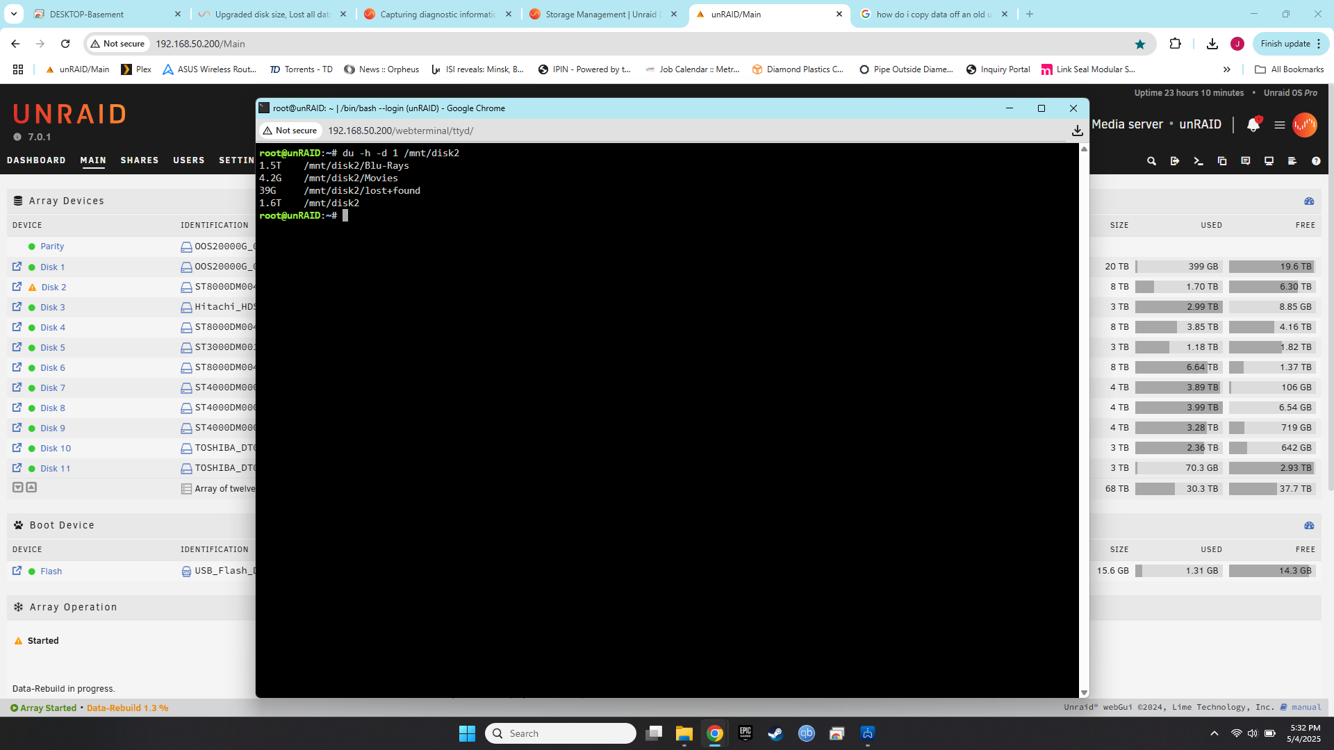

  11. Got it, Just checked it. Looks like everything in the lost and found was stuff that was moved from that drive to another one sometime ago, So nothing in that folder I can find is current.

  13. A friend of mine built this and setup it for me like 12 years ago for a home NAS. Needless to say, The only things that I have done much in the past is add drives, It started with only one. I've had a few problems here and there but for the most part the system has ran flawlessly. The shares thing you are talking about I suppose would be nice, But didn't find out about that till much later on when I had several drives loaded with seperate movie folders. I don't like doing much with this thing, Well because of stuff currently. Afraid I'm going to screw it up since I really don't know what I'm doing. Here is the screen shot of the command you asked.
