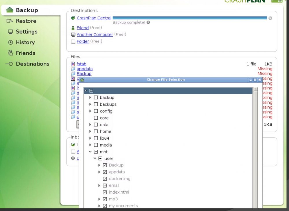

I took a snapshot of my screen. Weird. Crashplan can't find my shares in /mnt/user. I never made any manually changes until I guess a recent change was made by CP. If I log into SSH I see all my shares fine, but using the local WebUI it can't see/find any. I don't connect to CP from another computer, I just simply use the built in WebUI that's present in the docker. I don't think it could be a port issue but never came across this one. Anyone else?

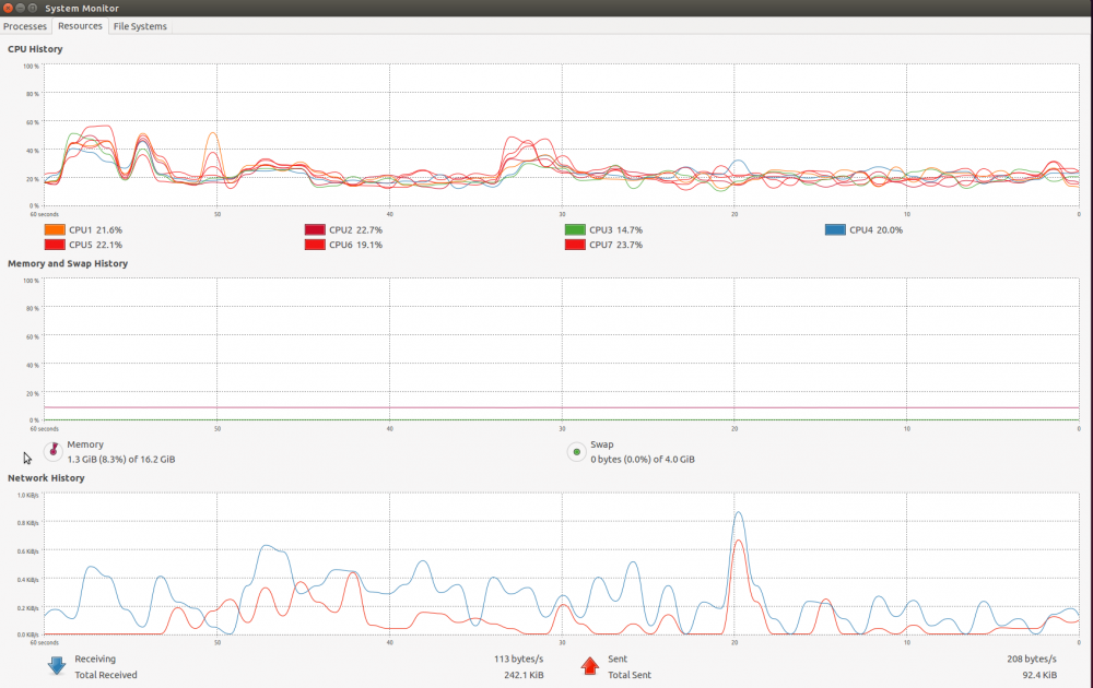

I run my Crashplan in a VM. Yesterday I added an additional 25TB of data to my backup files and wondered how the resources in the VM were doing, so I brought up the resources monitor utility. The VM barely used any memory and ran very smoothly as did the unraid stats themselves. I noticed I had too many cores dedicated to the VM, so I removed 5 of them and just now have 2. Everything still runs smooth in the VM and also the host runs good too. The scanning of the extra files took about 10 minutes. Damn... then something is seriously wrong here... Any thoughts ? I have mailed crashplan support.. How many memory are you giving the VM ? I have been giving the VM 16MB, but seeing how it only uses %9 of during a peak time I'm lowering that to 2MB. (%10 of 16MB - 1.6MB) - I think 2MB would be fine and I could care less how long it takes. Kind of set it and forget it. I left the resource monitor on the entire time it scanned all the new files and the memory never went over %9. I was under the impression Crashplan was using a lot more resources but when I finally checked myself it was not. What happens when you try to to select just one folder with 1GB or less in it? Does your Crashplan go to work after that?
[CONTAINER] CrashPlan & CrashPlan-Desktop
