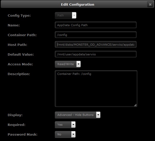

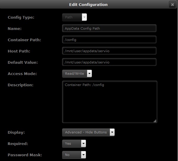

  2. That was helpful...missed that stupid Basic/Advanced toggle switch...Dang it.
  3. I did try early this morning. There is no edit button for the Appdata Config path. If it were a Host Path, I could edit it. In reviewing some of the screenshots I took yesterday - it looks as if when this path was defined on Disk 2, it DID have an EDIT and a REMOVE button, but it does not have either one now? You're not wrong - I don't understand anything about Dockers, I get the benefits of them, but setting them up can be difficult for me. Thanks for your patience.

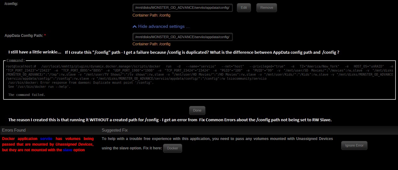

  4. I am having a new issue...anybody know what to do here? I got my drives to spin down (YAY!) but now the docker either doesn't serve content or I blow the container to bits trying to satisfy Fix Common Errors. A screenshot is attached. Here is what I did. I didn't try running anything from the docker after changing it last night. I just changed the container mappings so nothing is stored on a share on my drives - that is what was keeping drive 2 up all the time and because drive 2 was up, parity was also up. It was late, so I went to bed. This morning, I had an error reported from Fix Common Errors...it was suggesting that I needed a "/config" mapping for the config data - that mapping was already in Advanced Settings. Fix Common Errors also wanted me to set this mapping to RW Slave. So, I created a new duplicate /config mapping and set it to RW Slave (I think I did it right but obviously not) - when I pressed Apply - the command fails. (duplicated /config) So, if I leave /config just in the Advanced subfolder, the app will run but I get the error in Fix Common Errors since you cannot set that mapping in there to RW Slave. Plus, I found out that now no content plays on my Rokus. Any suggestions on how to correctly satisfy both criterion?

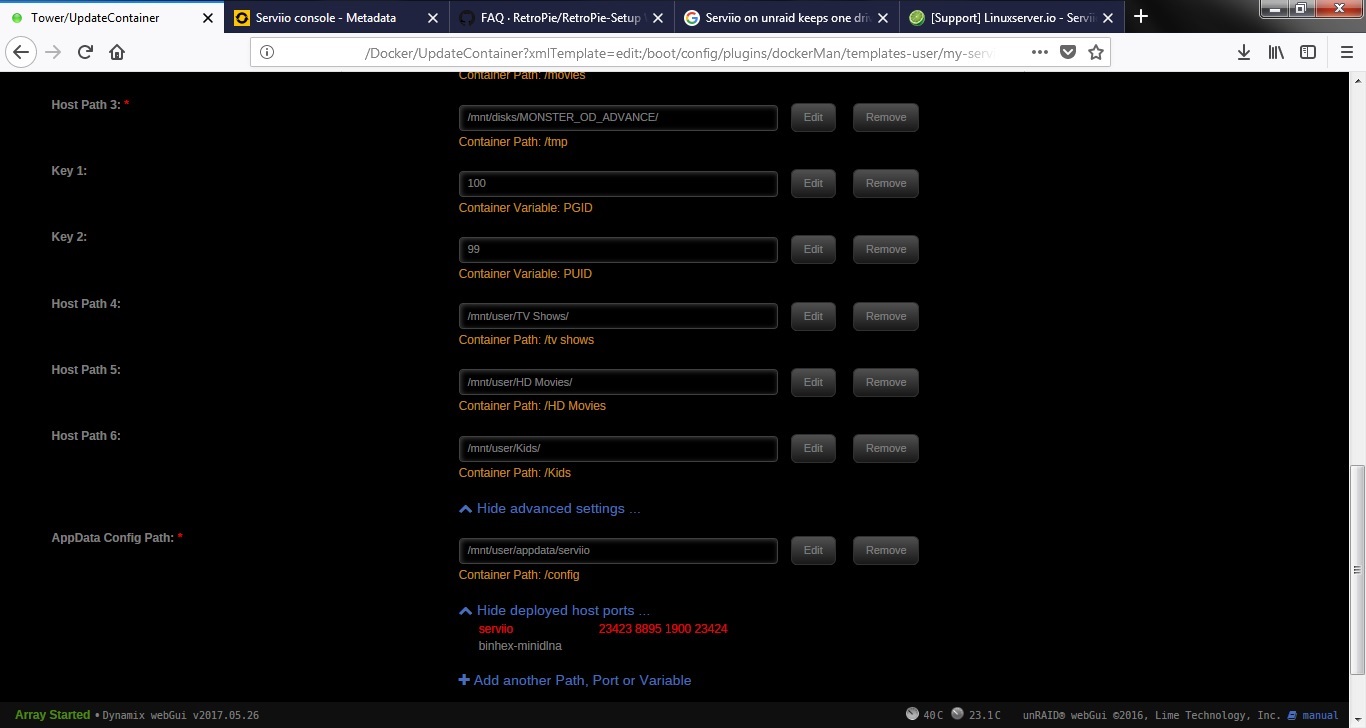

  5. And one hour later - both Dockers are running and ... All though the house, not a drive is spinning, not even one as small as a mouse.... Thanks guys! EXCELLENT diagnosis and recovery...

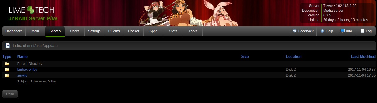

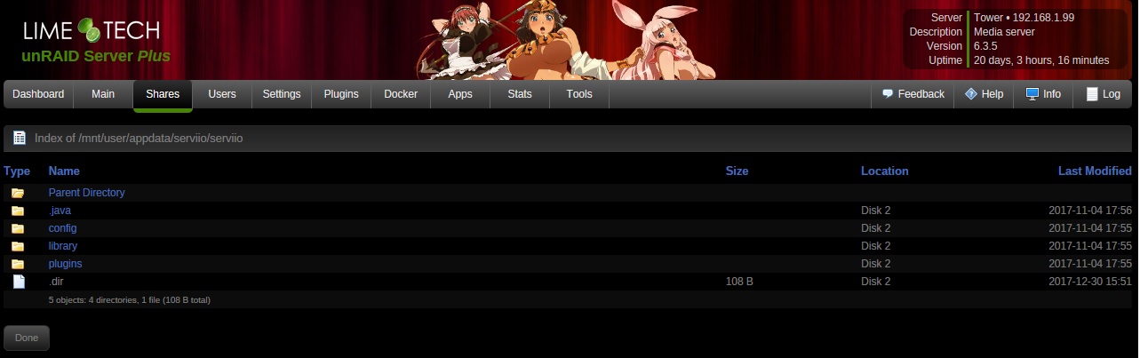

  6. Funny thing - I totally missed that Serviio makes reference to a config path, but I did not have one directly assigned. I guess it put it where it liked (it WAS "required") and I didn't catch it until now. (Probably on the disk with the most space at the time.) Bah! Humbug! Do these look like they have been reassigned correctly? The dockers restarted without an error after the modification. Is there an easy way to destroy the appdata share created on Disk 2? I'll know in a bit, if drive 2 spins down...no worries. Squid - thanks for clarifying that you CAN point these to a UD data storage device...it's nice to be able to deploy a docker to a temporary device to "try it out" and if you don't want to keep it, remove it from unraid, format the USB device and you're done. That is kind of how this started...I tried several media servers - minidlna worked fine until I got my roku devices...those needed some transcoding ability. I stumbled through the config for them and they worked, so I didn't spend a lot more time on them, but the configs have been wrong all this time. All I knew was that it was running my drives all the time and that is NOT GOOD for drive longevity. Happy New Year!

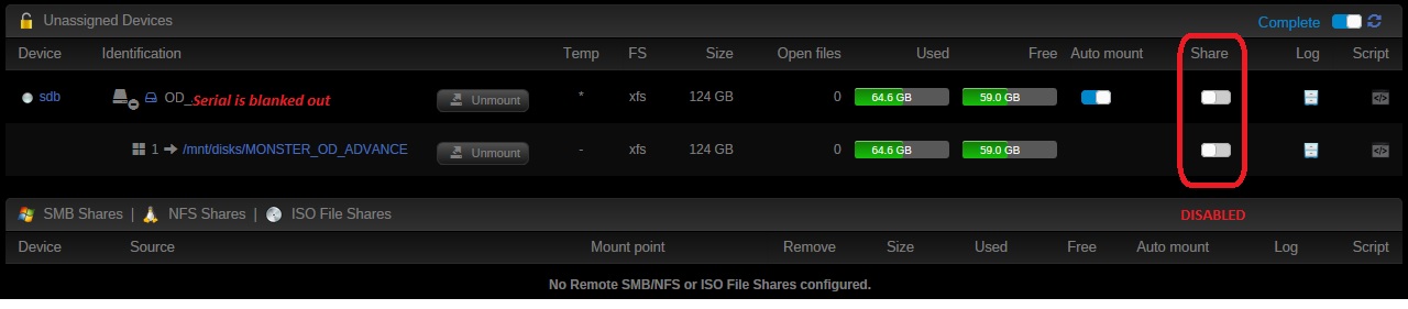

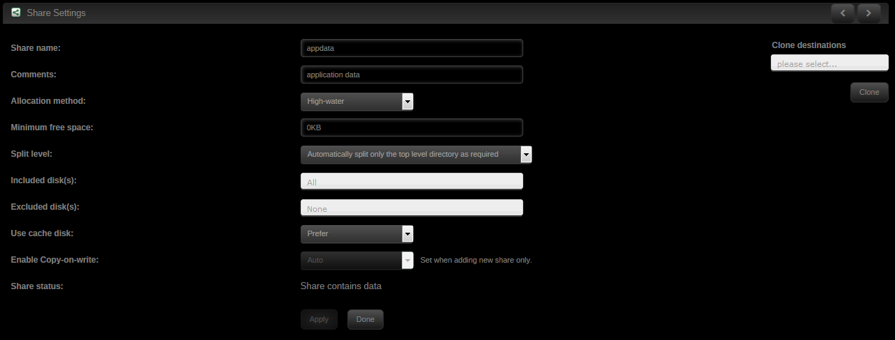

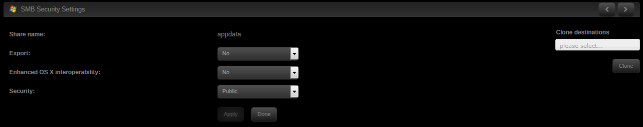

  8. Sorry - misunderstood - here are 2 shots of the settings for appdata...

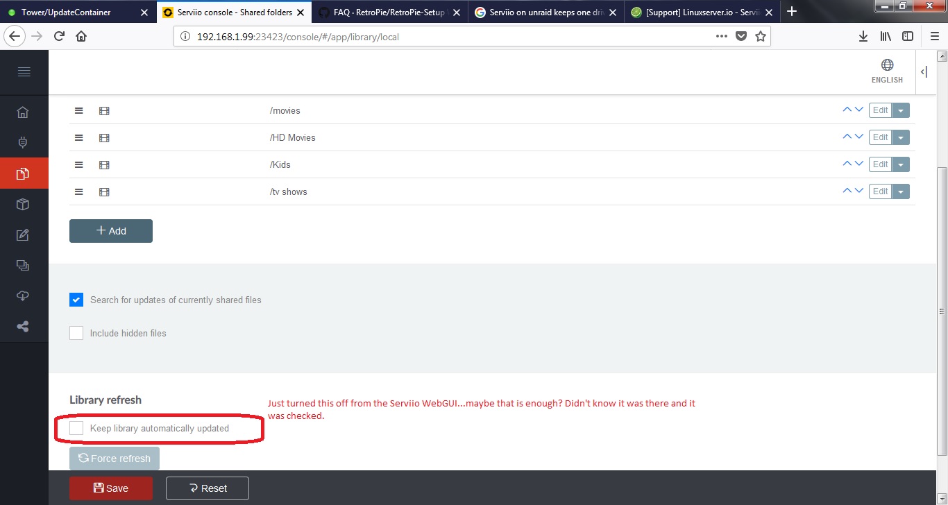

  10. And it's been more than 30 minutes since I changed the settings and drive 2 is still spun up...so the search continues. I did go read on the Serviio website but, as expected, dockerized apps are another can 'o worms. They did have some mentions of dockerized versions of Serviio, but it's all over the map - there was 2-3 for unraid, mostly for building a dockerized image, so I came back here.

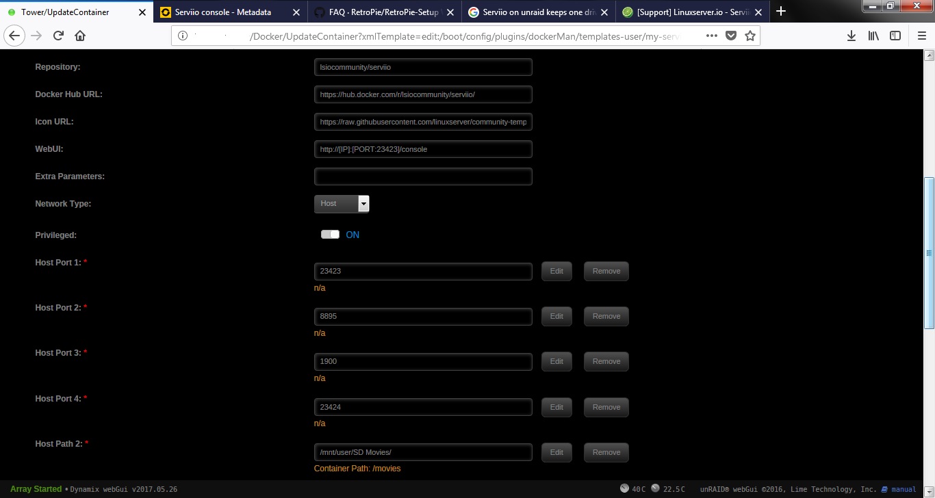

  11. Attached are 2 shots - I expanded everything to show all settings. I thought it was scraping also. I have some media on Drive 2 that might not be " scrapable". Maybe Serviio doesn't like NON easily resolvable files for scraping? Kodi has issues with some of these files as well. There are basically 4 mappings: /movies /HD Movies (Blurays) /tv shows /Kids (Animated stuff mostly) Then I poked around in Serviio some more and I found this in screenshot 3 - maybe that will do it? I'll keep my fingers crossed. If my drive 2 spins down in 30 minutes...I'm golden. Thanks for looking Saarg!
  12. I'd like to first say thanks for this wonderful docker. Everything works as expected, but I have noticed something odd since I installed the Serviio docker. My Drive 2 and my Parity drive will not spin down. Stop the Serviio docker and you can spin them down manually and they stay spun down. Restart the docker and they return to being polled. I looked in the logs for Serviio from the WebGUI and there is nothing there that is unusual: [s6-init] making user provided files available at /var/run/s6/etc...exited 0. [s6-init] ensuring user provided files have correct perms...exited 0. [fix-attrs.d] applying ownership & permissions fixes... [fix-attrs.d] done. [cont-init.d] executing container initialization scripts... [cont-init.d] 10-adduser: executing... ------------------------------------- _ _ _ | |___| (_) ___ | / __| | |/ _ \ | \__ \ | | (_) | |_|___/ |_|\___/ |_| Brought to you by linuxserver.io We gratefully accept donations at: https://www.linuxserver.io/donations/ ------------------------------------- GID/UID ------------------------------------- User uid: 99 User gid: 100 ------------------------------------- [cont-init.d] 10-adduser: exited 0. [cont-init.d] 30-config: executing... [cont-init.d] 30-config: exited 0. [cont-init.d] done. [services.d] starting services [services.d] done. I did try giving the app "privileged" access but it didn't do anything about the drives being spun up (as a matter of fact, it spun them ALL up!) I attached my diagnostics, is there something else I might try? I have had this issue present in at least the previous two versions of the docker - I am running 1.9 currently. Thanks in advance. tower-diagnostics-20171229-2331.zip
