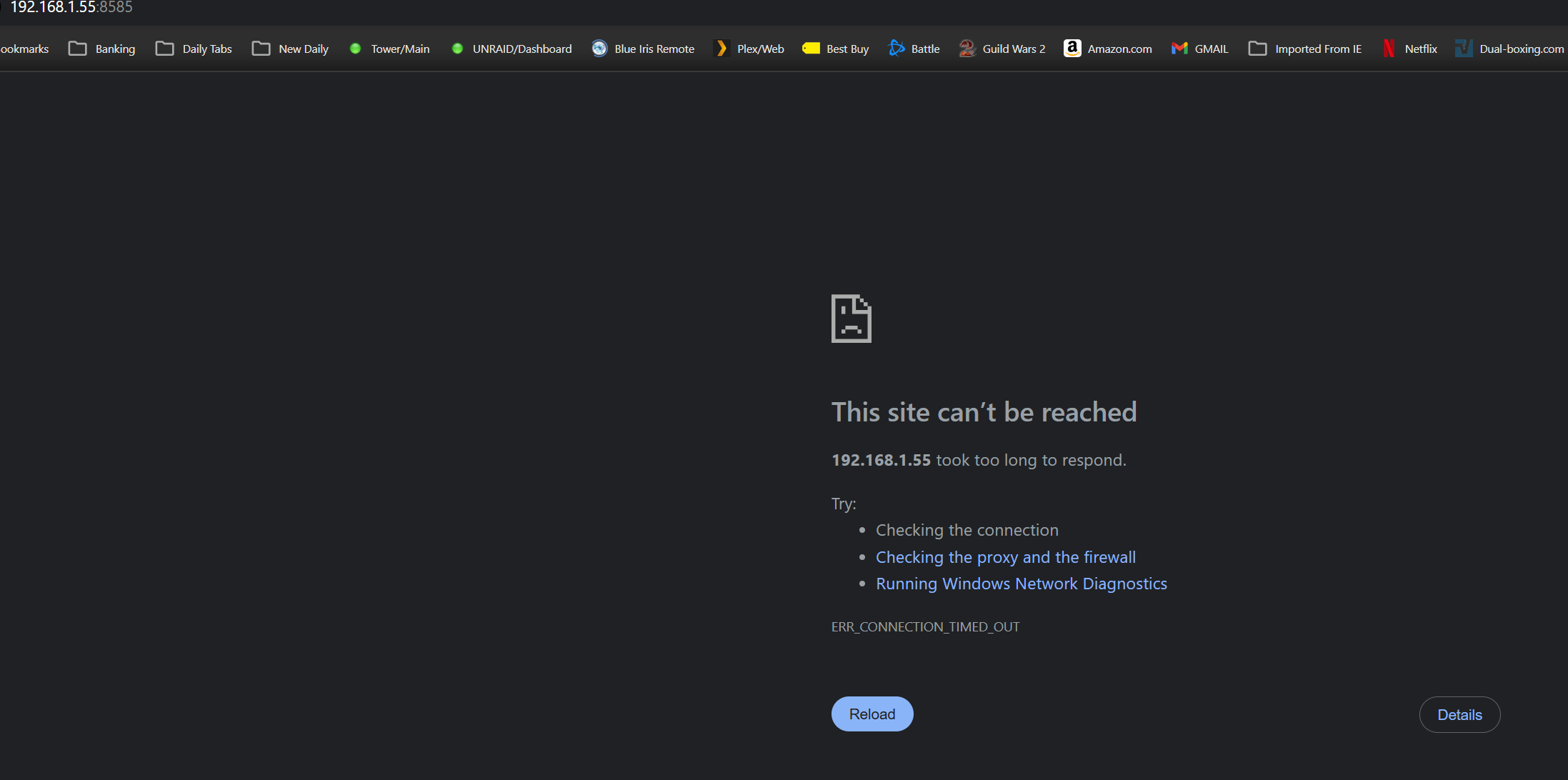

  19. But I am getting the error below, shoudl I not be able to get to the web-ui regardless?
  20. I also have the same issue, I have not changed anything on the container and it has been running fine for months, but now I cannot access the web-ui. I tried doing a clean install with the same results (deleted the app data folder and did a full fresh setup unsing screen shots of my original settings that were working) Thoughts?
