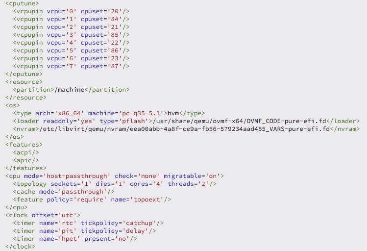

I wanted to chime in here and I am having the same issue. My VM that is freezing is the latest version of PfSense (FreeBSD) that is locking up. No response from the console/ssh or the firewalls WebGUI. Nothing in the VMs logs or in UNRAIDS logs (even using the Enhanced Logs plugin). The only thing that kind of stood out to me was looking in the system processes in UNRAID, PfSense was recorded as using near half of my servers CPU resources (47% of my 24 total cores) . Im running a dual Xeon X5670 system but have VM CPU Pinning enabled for it ( cores/threads 8, 9, and 20, 21 ) Im not sure why its listed so high. In the VM, the PfSense WebGUI dash its only reporting 7%-10% CPU usage while the UNRAID Dashboard is reporting roughly the same for those cores. The update times look to be more frequent in the UNRAID dash, and I do see some quick jumps occasionally to around 40% on each of those 4 cores, but then falls right back down to single digit numbers. Is the 47% usage I'm seeing in the UNRAID logs reporting it as 47% of the 4 cores I have pinned, or is it reporting 47% of the 24 total cores in the system? I have another VM running Windows 8.1 Pro, with 4 cores pinned to it, and it has not frozen ever. I've only just had the PfSense VM freeze on me, and this is maybe the 2nd or 3rd time in 6 months to a year it has happened. The PfSense VM is my Firewall/Router for the whole house. When It freezes, I lose WAN connection, but my static LAN connections are all still working. I tried just restarting it from the VM popup menu in UNRAID and it didn't do anything. I had do Stop and Start the VM for it to come back up.
