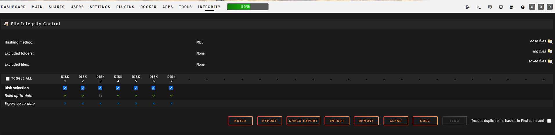

  10. Sorry, this seems stupid... How do I "run a check"? No button or other mechanism here or in the settings (as far as I can see). Do I need to run an export first? The exports are ancient... (It probably has not been running...)

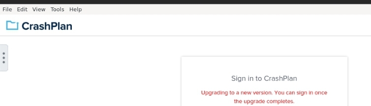

  12. I can't get logged in... Has worked for yyears, and the data is there, but after a double disk failure, I have some restores to do. Says that it's "being updated", but has said that now for weeks. All apps and plugins updated, including this one. Help? Image cropped to not share user name, etc, but this happens after I try to login. I did change password in CrashPlan recently... Could that be it?
  13. Turns out, I have the "Dynamic File Integrity" plugin... Should this be able to find any of the file corruption?
