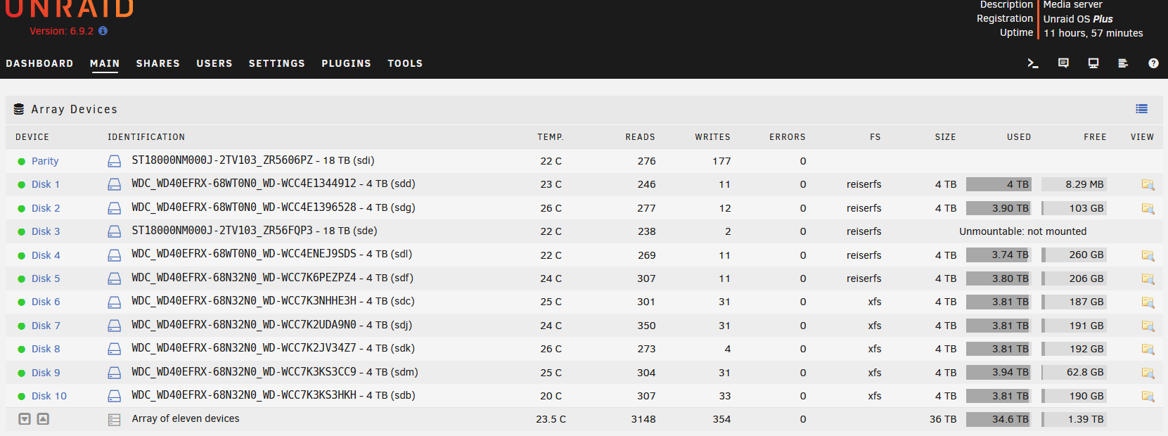

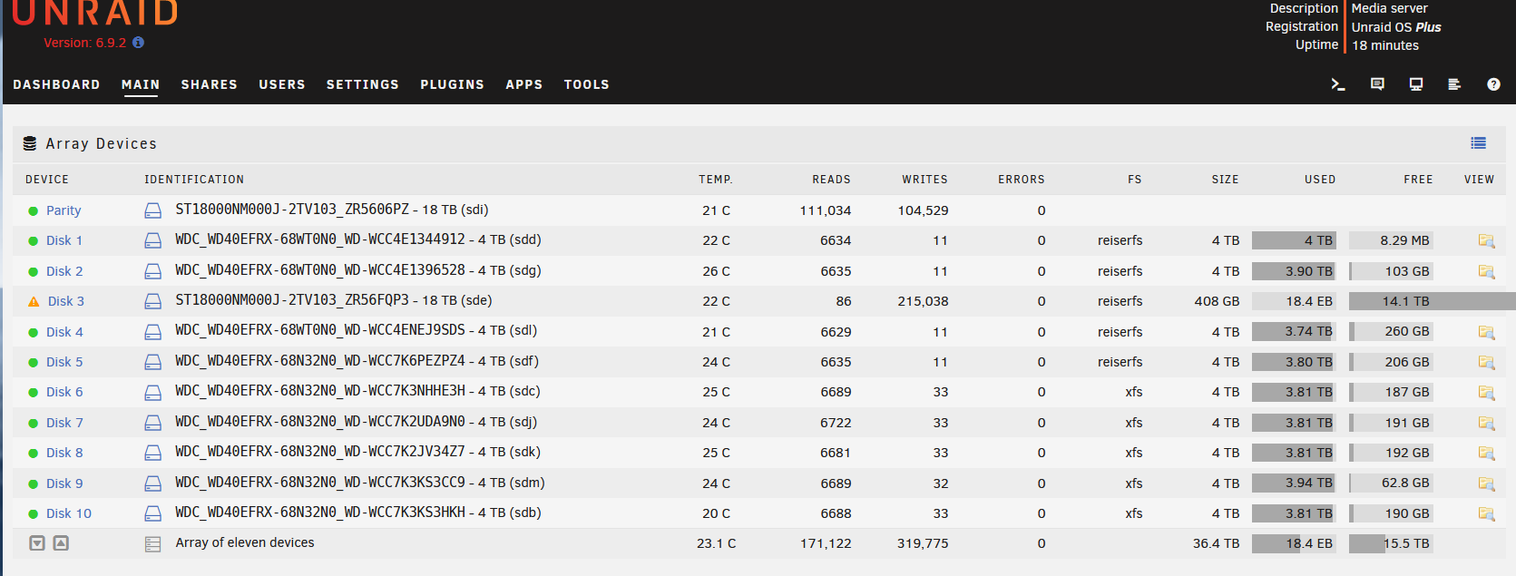

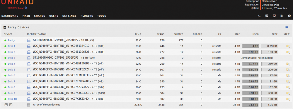

  5. I am in the process of updating my array by replacing some WD Red 4TB drives with Seagate Exos X18 18TB drives. I precleared a new drive, replaced one of the old ones, and let the array start to rebuild the new drive. While this was happening the information listed about the size, used space, and free space was all incorrect for the new drive (size is 408GB, used is 18.4EB!, and Free is 14.1TB which is probably about right). See screenshot "Incorrect sizes." After the drive was rebuilt the information was still wrong so I tried stopping and starting the array. Once I stopped the array it now says "Unmountable: not mounted." See screenshot "Unmountable." I tried restarting the system and rebooting into safe mode and the problem still persists. There are a couple other weird things I noticed. Disk 3 still shows a green dot beside it despite the fact that it has not been mounted. The array itself has not given any errors and still shows a green dot in the tab as well. If I view my array from another computer on the network it shows a total capacity equal to all drives except drive 3. And when I view the drives individually only disk 3 does not show up. Also, disk 3 is still showing as reiserfs under FS when I expected it to be xfs. Any ideas what is going on? Did I run into some major glitches in the software? Under "array operations" I have the ability to format unmountable disks. Should I try that? I would assume that I would then need to rebuild the disk all over again? Thanks for your help. If anyone needs me to try anything/post anything please treat me like a complete beginner and give detailed step-by-step instructions!
