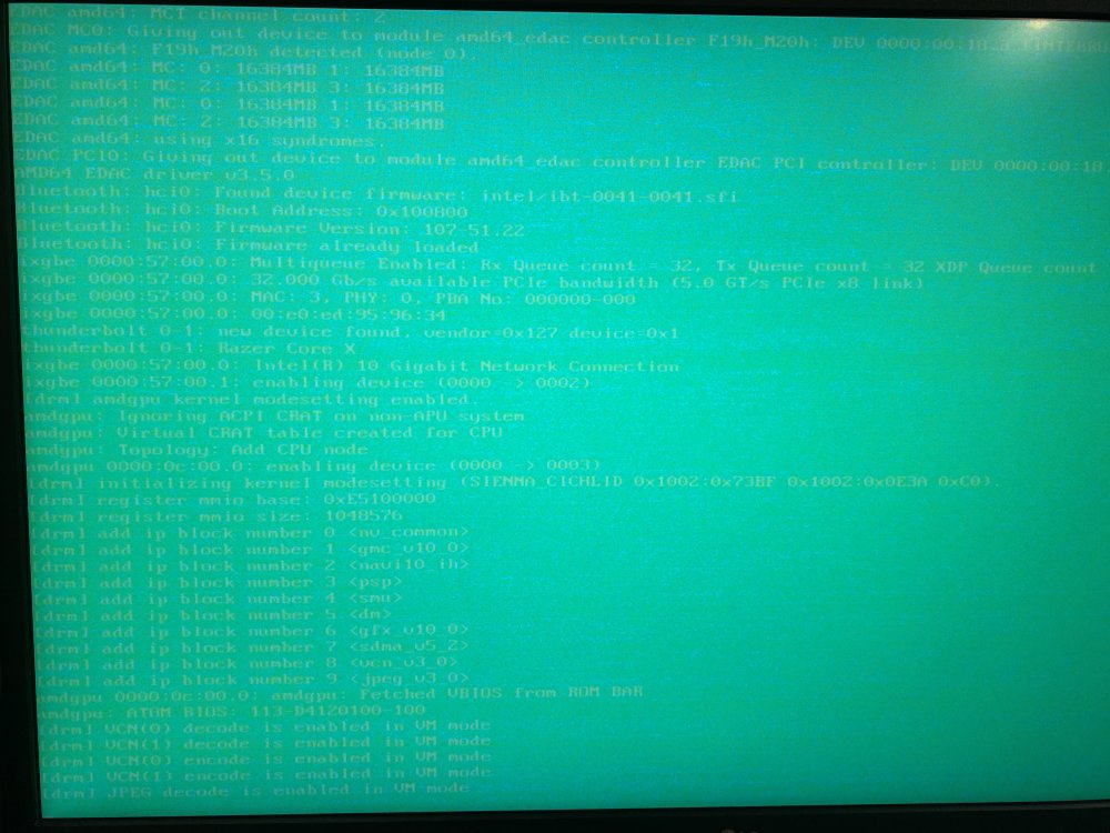

  4. no more green screen & its now bootable. I don't know why, but RC2 works!!! Thanks! 🥰

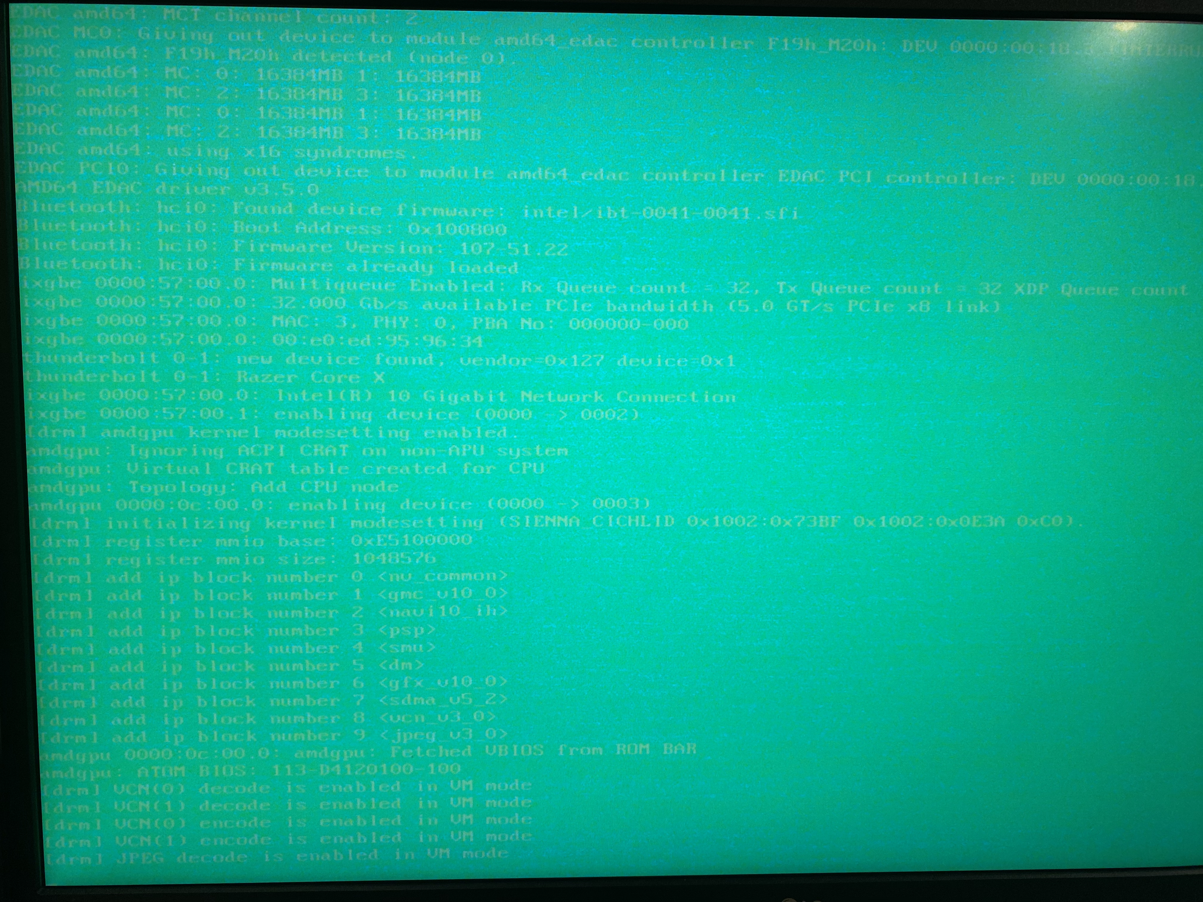

  5. i created a blacklists on flash/config/modprobe.d; it doesn't help with booting in my case. even a fresh 6.12.0 rc doesn't boot nor seeing the gui. I won't be able to generate a log, do you have any suggestion? or should I just wait for the next release? here is my spec, is any of these items not compatible with the lately build? Gigabyte x570s Master Aorus Ryzen 5950x Kingston 128 ECC ram 3.0 usb flash but on a 2.0 slot Intel X540-AT2 Gigabyte Titan Ridge (use external GPU in general; also tried & swapped out the first slot with an actual GPU, doesnt work either) LSI OEM 9201-16i Wing
  6. the screen is finally on after 15-30 mins wait. the screen turns green & freezed, and it also has a bit of flickering.

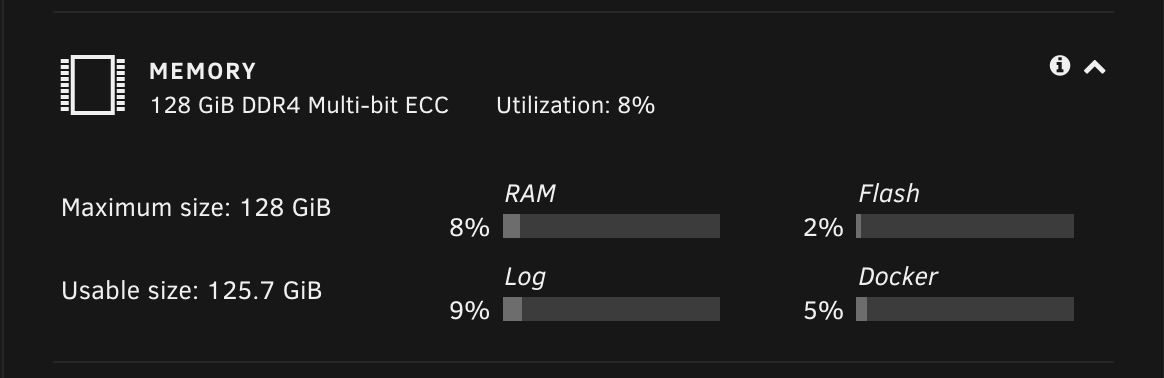

  10. 不可能,看你用什么硬件吧了!你的系统可以支援256的话,上256都没问题! 我的x570s aorus master就插满128, 完全没有问题。

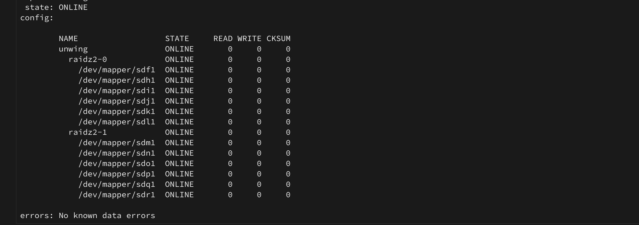

  24. Hey all, does the zfs plugin flush the RAM/ ARC cache automatically? if not, is there a command line to do so? the ram usage of my unraid is at 50 for hours after 100GB of copying. it seems like it won't clear until I restart. (the system actually flushed 2gb of ram after 3-4 hours of idle, it this normal?) I am currently running a Raidz2 of 10 x 16TB drives, is there any advantage setup a Raidz1/ Raidz2 in 2 vdev instead? Capacity isn't an issue, but I wanna optimize the zpool for my daily workflow (After Effect, Premiere, Cinema 4D etc) I use Intel optane ssd for my SLOG, is it going to work fine on a AMD build? Unraid version: 6.10.0-rc1 Wing
