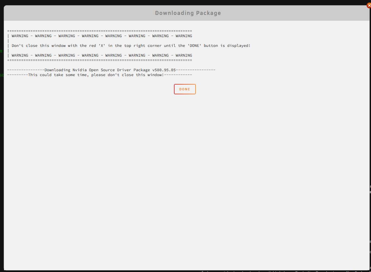

  3. No no no , why wouldnt i trust you ????/ As i stated , i tried multiple time and even proved with the screenshots selecting the version and waited , then rebooted this didnt worked for me at all i provided screenshots yesterday . That command i didnt know what it did but it worked i can reboot and have the version i selected
  4. According to chat gpt : rm -rf /boot/config/plugins/nvidia-driver/packages/* rm -rf /boot/config/plugins/nvidia-driver/NVIDIA-OpenKernel* rm -rf /boot/config/plugins/nvidia-driver/NVIDIA-Driver-Open* Reinstall nd reboot , this fixed the issue and now can properly download lets see if it survives a reboot

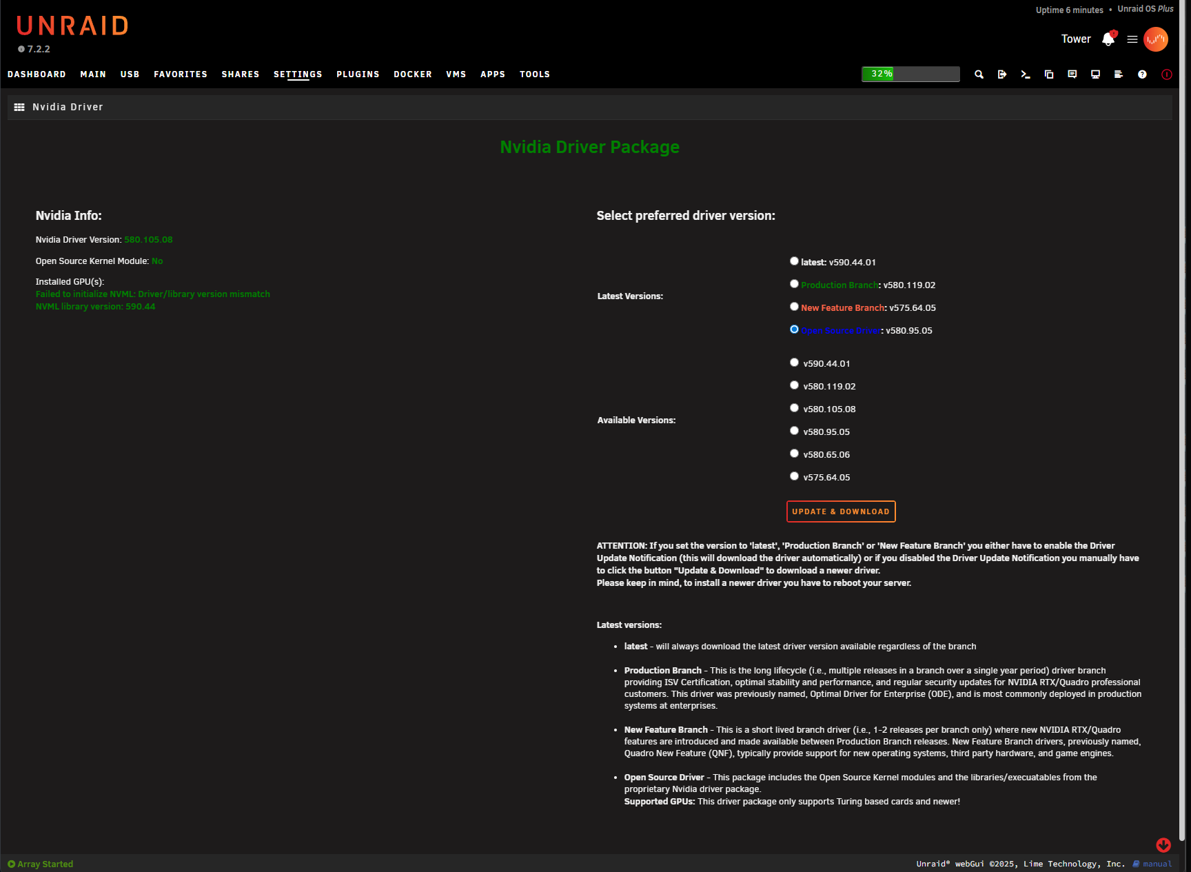

  6. I can reproduce the issue and it’s a kernel/userspace version split, not scripts. After selecting Production 580.119.02, nvidia-smi and nvidia-container are 580.119.02, but /proc/driver/nvidia/version and modinfo nvidia show the Open Kernel Module 580.95.05 (Dual MIT/GPL) still loaded. dmesg shows: “API mismatch… client has 580.119.02 but kernel module has 580.95.05”. Also both NVML libs exist on disk: libnvidia-ml.so.580.95.05 and libnvidia-ml.so.580.119.02 in /usr/lib and /usr/lib64. So the plugin updates userspace but does not replace/load the matching kernel module when switching from Open Source driver to Production branch.

  10. So far it does not work with : v580.119.02 v580.105.08 I am going to reboot and check if the open source driver is working for me other than the 590.44.01 those 2 are the ones who stick
  11. Thanks , yes this is the process i am doing and it is not working
  12. Hi there sure , it seems that i am stuck in some weird loop where my system does not want to install another driver , yes i have tried multiple times rebooting after installing the 580 version , so far i managed to get it to work using the opensource version , that one it did wanted to take however once with that one installed it simply does not want to go to the 580 version. In the meantime i have managed to instal an RTX 2XX card i had as my pc backup/spare but will be super usefull to know why is my system behaving like this . So far if i can revert to the open source package i think i can make it work until i find a solution Uploading Attachment... tower-diagnostics-20251216-0004.zip
  13. My issue is that i cannot seem to downgrade . Whenever the plugin is installed it gets the 590 version , and if i manually select the 580 production version i get the : Installed GPU(s): Failed to initialize NVML: Driver/library version mismatch NVML library version: 590.44 So i am in a loop cannot do anything
