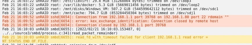

  17. Hi I am seeing these pop up in the logs every once in a while, is it anything to be concerned about? What is it? The IP 192.168.1.1 is my Router (Unifi Dream Machine Pro) Thanks

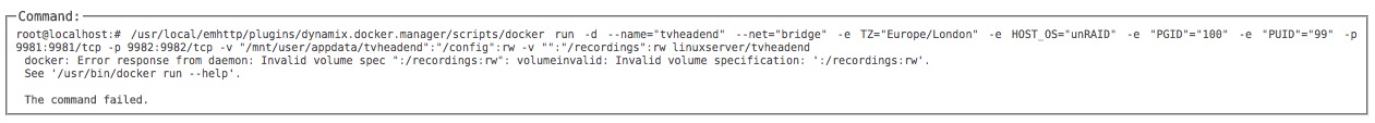

  22. Anyone got an idiots guide to setting up IPTV on TVHeadend?? Am struggling to get IPTV working and am fairly tech savy.
  23. Thank you for the replys, so just to confirm i need host mode? It did install once i set the recording dir, however now when i try to add IPTV channels when it scans them it come up with FAIL. is this because i didn't choose host mode or something else?
  24. Can get this installed, sure it is something basic, can anyone help?? Just want to use it for IPTV
