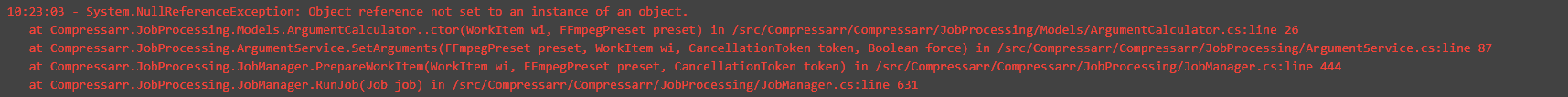

  9. Hi OFark i assume i am on the latest version. i have the repository set to ofark/compressarr:latest and set to update all my containers once a day. i attached the appsettings.json file and here is the info from the settings page Application: 1.2.7912.30173 Runtime: 5.0.9 FFmpeg: 4.2.1 Docker: Yes OS: Unix 5.10.28.0 OS 64bit: True App 64bit: True Thanks appsettings.json

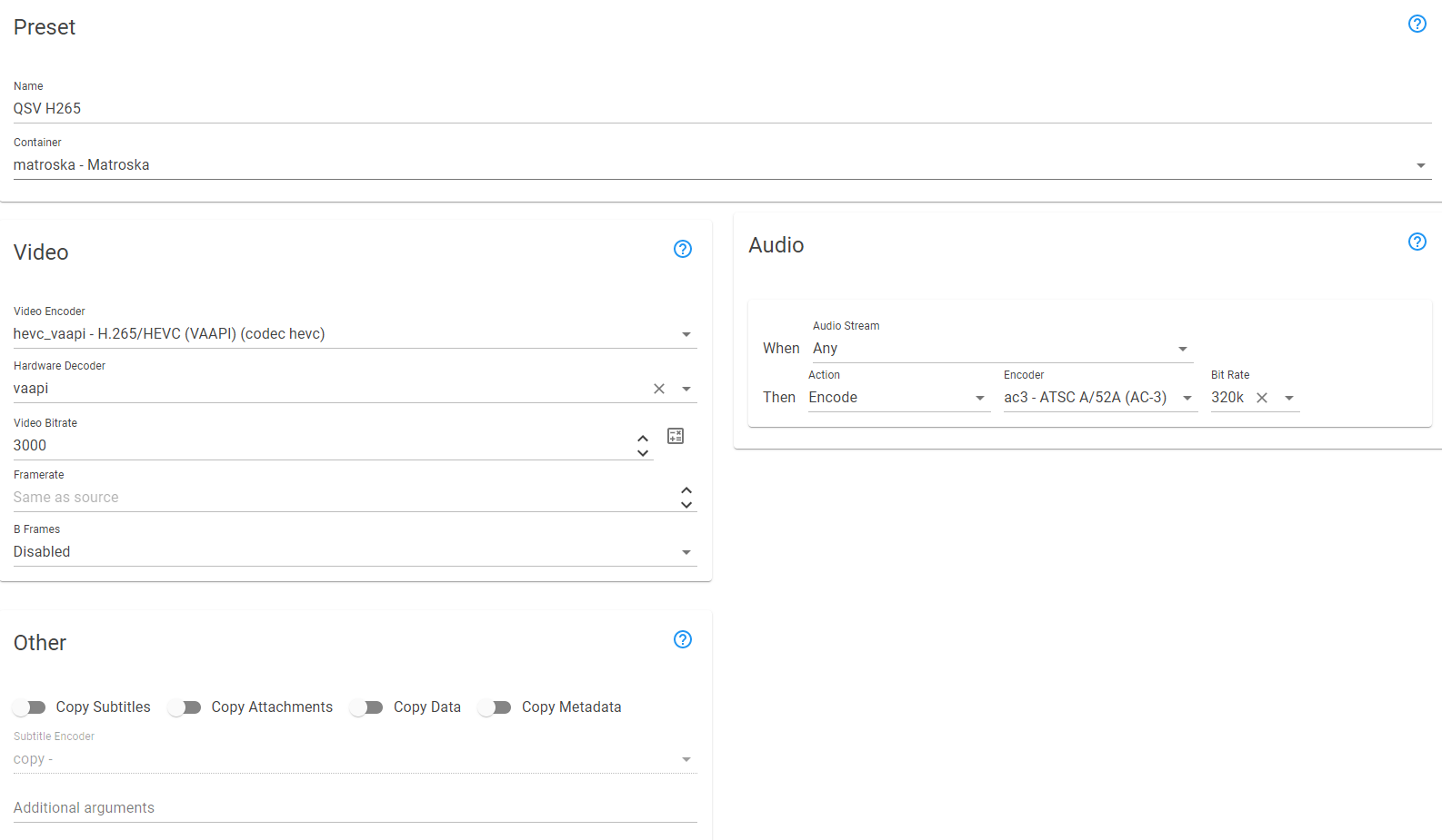

  10. Hi Just wondering if anyone has been able to get this up and running with QSV. No problems getting it running with nvidia but i keep getting errors with QSV. i've passed /dev/dri through, here is a screen shot of my ffmpeg config and the errors. any help would be appreciated.
