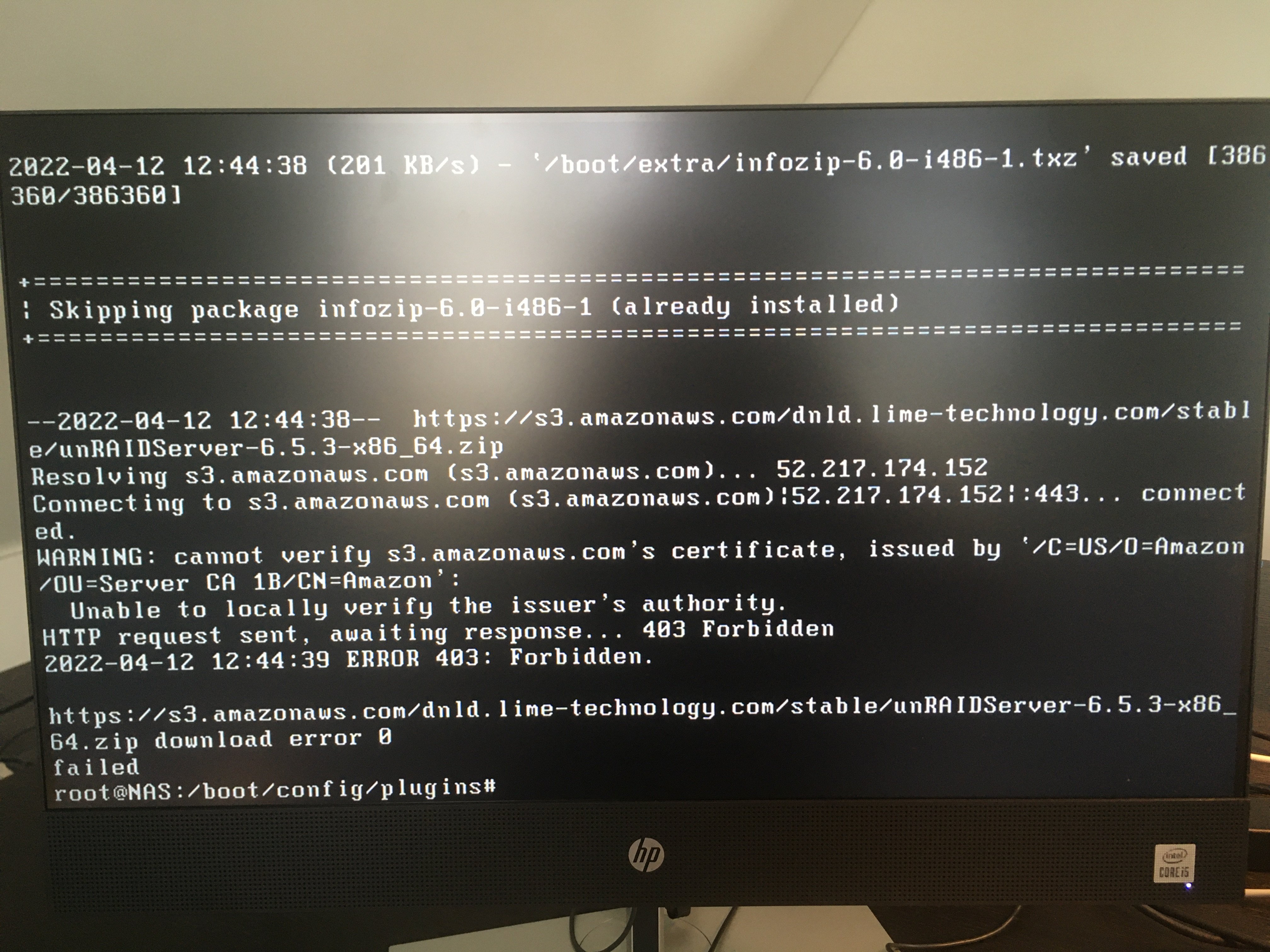

  6. I'm trying to update an Unraid server which hasn't had maintenance in a very long time, still running Unraid 5.0.6. I've followed the instructions on the website and forum, installed the unRAIDServer.plg plugin but it gives an error when I try to run it. First it gives 2 403 errors and then it tries to download version 6.5.3 which results in a download error 0. I attached a screenshot, what can I do to resolve this? Thanks in advance!
