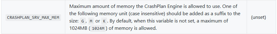

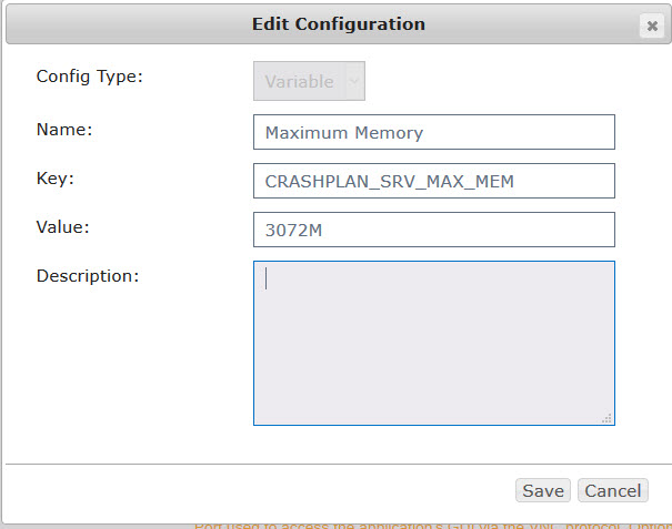

  8. Edit the container like described here: Should look like this:
  9. Updated to the latest image and everything is back to normal. Once again, Thanks!
  10. Works, many thanks for the quick response!

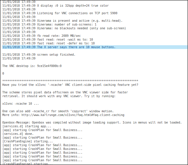

  11. Updated my CrashPlan Pro Docker today but it did not start up, GUI only shows a black screen and log is repeating "app starting CrashPlan...". Any ideas on whats happening?
