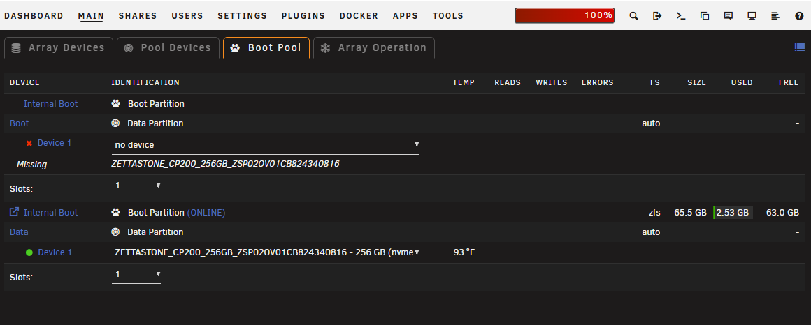

  1. OK, thanks, I dug around a bit and found how to delete the pool. Now I have it booting from a single SSD.
  2. This is what I'm seeing for the boot pool now. I don't know why it seems to think there are two internal boot devices configured.
  3. I tried the internal boot with 7.3.0. I got it configured and it booted, then after a few reboots bzModules was corrupt. Sometimes it would boot, sometimes it wouldn't. Redid the boot device, same thing happened again. Went back to the USB. I saw 7.3.1 was available, decided to give that a try with internal boot, and now after booting with it it won't start the array because it's insisting I need a second device in the boot pool. I configured a 256GB as a boot+data drive, and the data drive is also not showing up as being available this time, whereas that worked before. Is there some way I can make this work?
